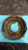

This is all I found. Not sure what year it's for and I can't find any info stamped on it.
1972 Chevelle Malibu Convertible Project
