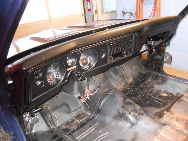

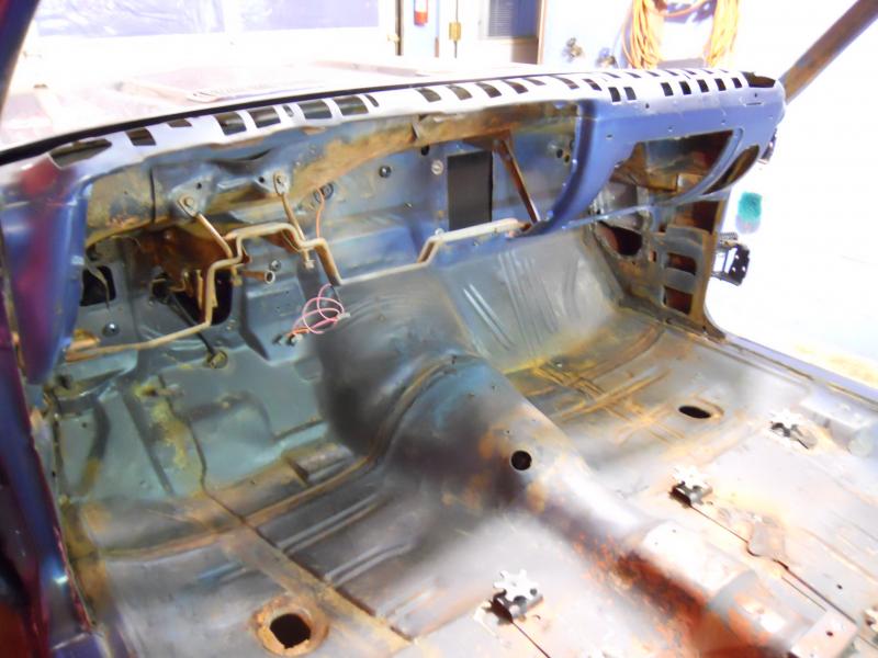

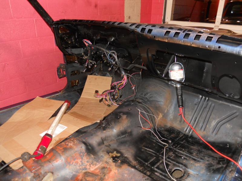

Removing the dash pad will not reveal much, it's all steel under there.. I had my 69 El Camino all apart 2 years ago..
Were is the gap? Mine always had a weird gap on the far left...

Thanks for posting the pictures. I may not have to remove the dash pad to see why the screw that holds the instrument cluster is missing. The cluster has moved away from the stamped metal leaving a gap.
