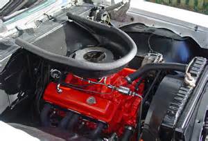

Cowl Induction hoods had the flapper. The hoods without the flapper are "domed" hoods. To make a domed hood function, you would have build an air pan.

OK, thanks. It has a scoop in the back and a screen on it but I could not figure or see any way for the air to get into the breather.

Well, hard to see. Does the circle in the dome of the hood open to the back near the windshield? The air cleaner assembly is definitely the same as used with a cowl hood and flapper.

It does have a opening to the rear of hood but I can not see where the air would get in the breather unless it does not touch the hood.

The domed hood cars had a closed element air cleaner in 71'- 72'. I'll have look at the domed hood I have again. But, basically, if I recall correctly... you have to remove the screen and baffle from the rear of the hood.
I have one each, a domed hood and cowl flapper good, both original GM. I can try to slide by my folks place today and compare. (Both are off the cars)
