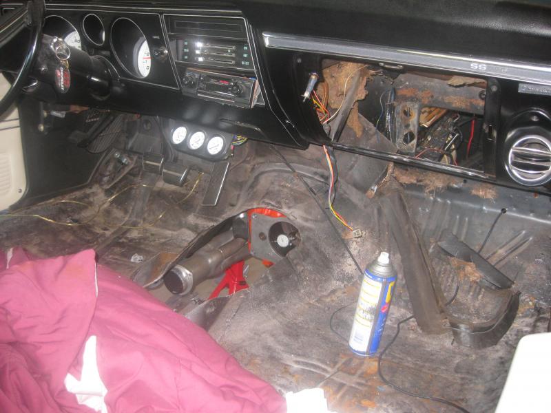

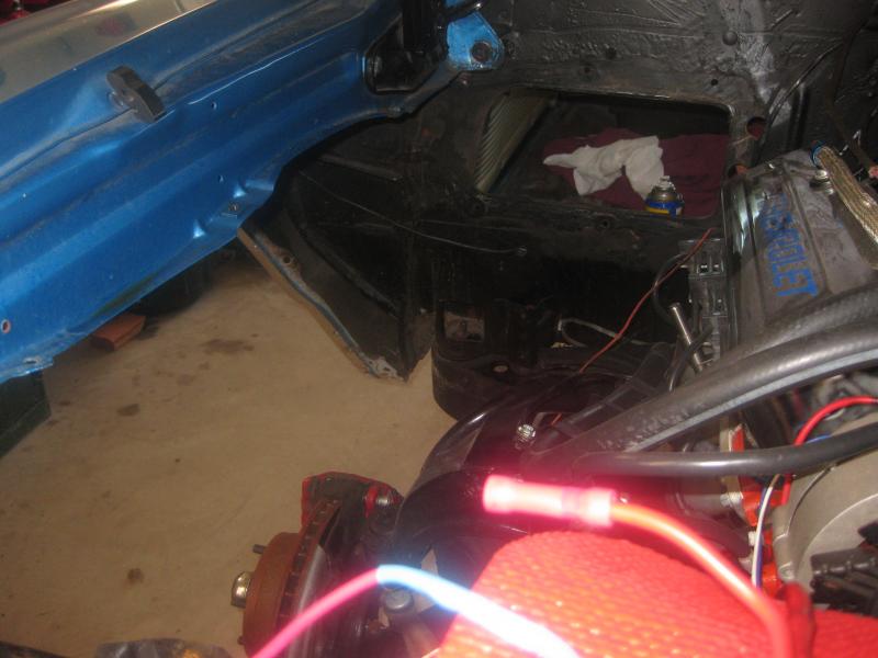

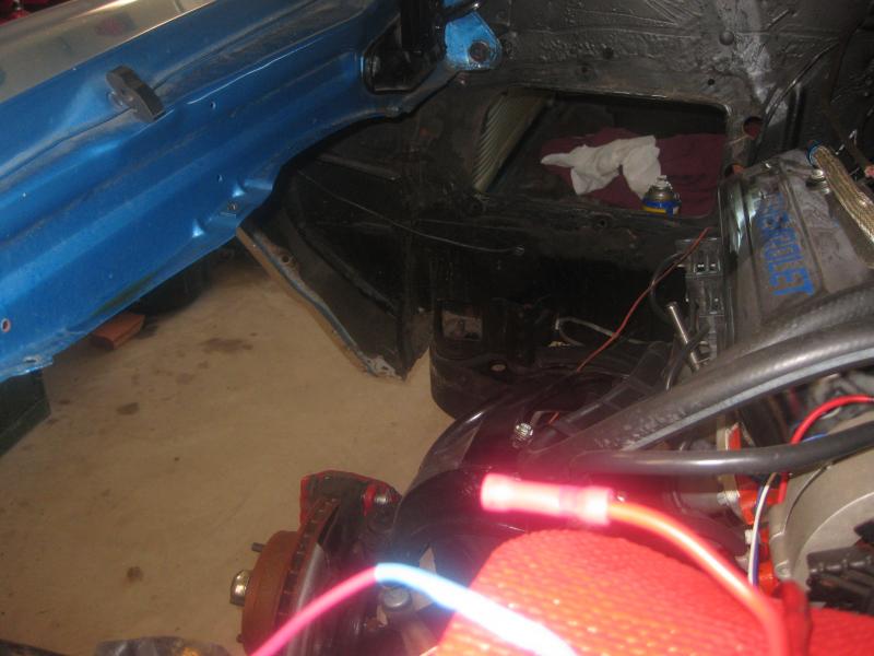

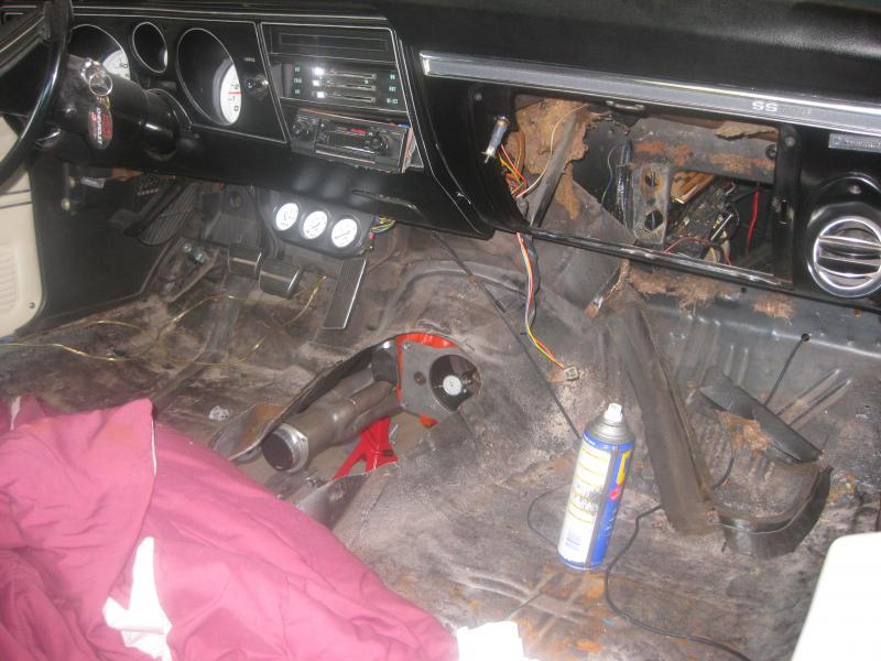

Here is the mess I have right now...I know I'd rather pull the motor that pull the heater core as this has become the biggest pain in ass. I found that at one time or another something (mouse) was living in the heater box and had a lot of garbage blocking the main door. Now wonder it was always blowing heat thru the vents when it was off. Now if I will be remember on it goes back together when I get the new parts.
Note, as you can see in the bell housing I still have the dial indicator is still in, I have to find a different tip (I'm hoping we have at work that will do what I need)
