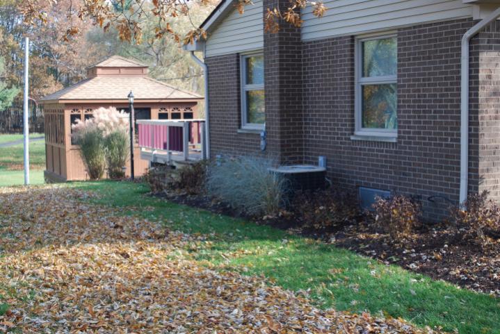

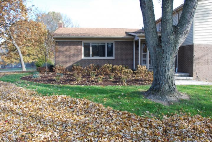

A little bit of what we had going on this summer.
We ripped out all the old shrubs over a year ago. Neither of us could decide what to do with the front of the house so we decided to call a landscaper, a friend of our daughters since middle school. They came up with a plan for new plants out front and down the side.

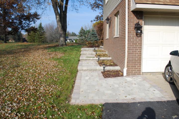

I told Lynda we needed to replace the front walk. She said why, we never use it. I said because it looks like crap. You want the front to look nice, well that walk has to go. It was only 2' wide going along the side of the garage and less than 2' out. Sunk and tilted. Chad, landscaper said we can do pavers so that's the next pictures.

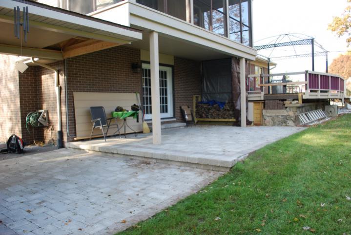

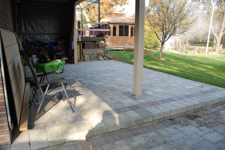

Lynda said if you want a new walk out front what about the patio in back. It's cracked and sinking. So we got a new patio in back as well.
There was a stairway coming from deck down to patio before. Three steps down, a 4' landing then another 3 steps down. Came way out almost to middle of patio. I ripped that out, 7 4x4s cemented in, they didn't want that going anywhere. There are 2 other stairways coming down from deck so I may just finish off wall and not replace the stairs. Brown tarp looks kind of tacky but keeps the north wind from filling the patio with snow in the winter.
Original patio only came out a few inches past the post. Now it extends another 4-5' farther.

Notice in last picture that part of the breezeway roof is unfinished. It was leaking at the outside corner from above. I ripped all the aluminum and wood trim off. The beams at the outside corner and at the house were all rotted along with the last truss. The aluminum trim was holding the water in so it wasn't real obvious. So new beams on all 3 sides. I re-sloped the roof on the other side to create a valley, you can't see it in any of the pictures. It use to run down and dead end into the gable end of the small roof/overhang running along above garage doors. Also had a hole through it for the downspout from above. Guaranteed leak point, all gone now.
We tried to figure out how to hang corner of roof from I beam that supports upstairs deck. Weld a bracket to the I beam? Finally came up with this.
Three 3' x 3/8" steel straps. They're lagged into the deck joist above which is a double joist. The other corner is hanging from the house so we eliminated the 2 posts that help up that roof. We started with 4 posts under upstairs deck and 2 under breezeway roof. Now we're down to 2 posts, sure opened things up.
Notice trailer in right side of picture. Friend lent me his aluminum break so I could replace all the trim I tore down. Have one more piece to bend and have to reconfigure down spouts. Not going to finish underneath this year. Want to make sure there are no leaks before I close it all up
