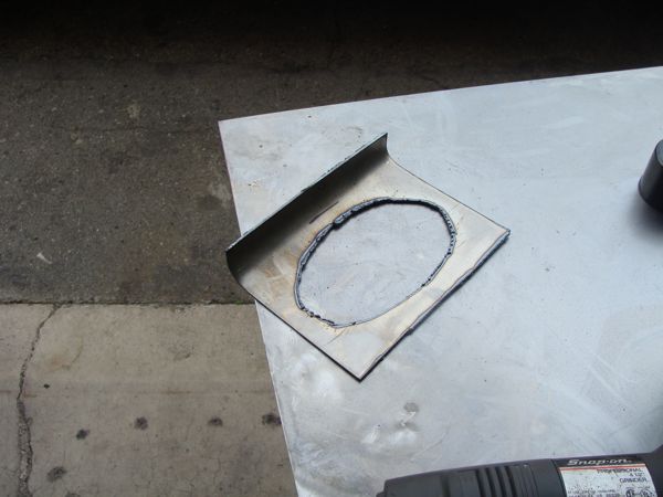

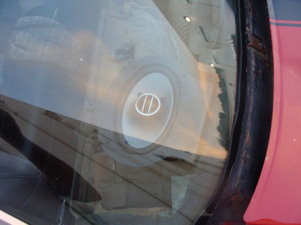

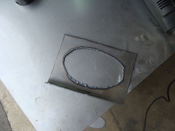

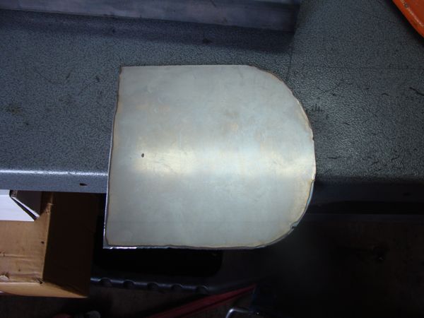

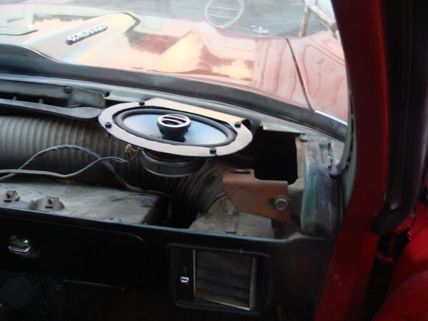

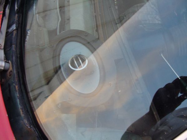

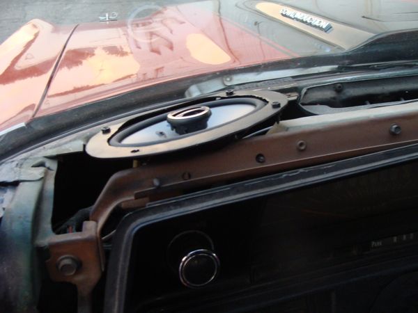

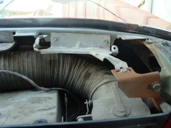

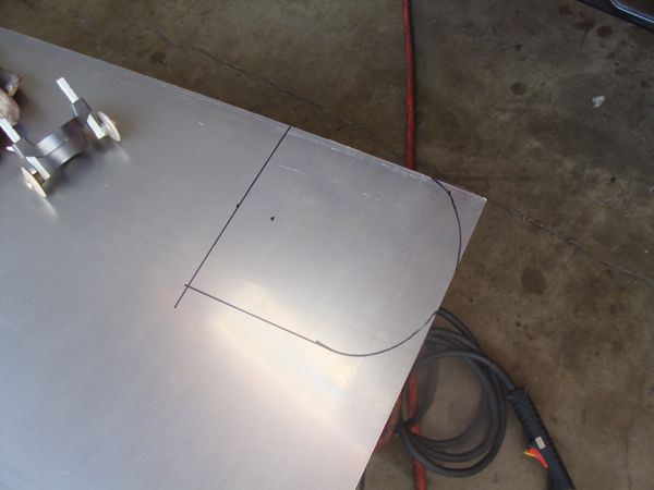

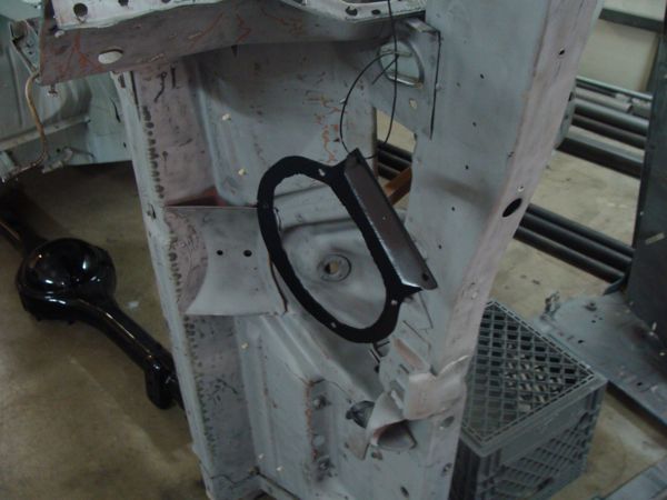

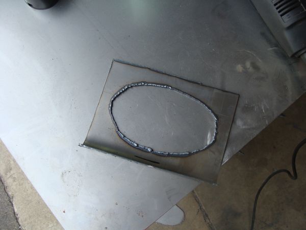

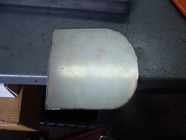

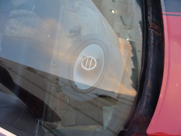

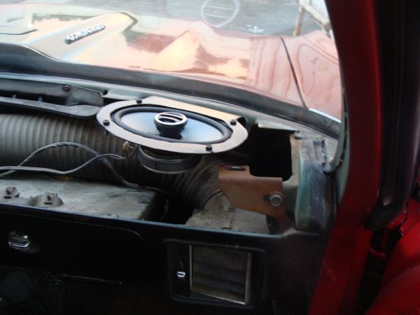

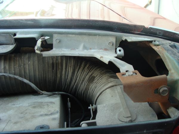

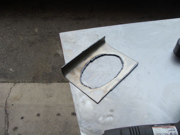

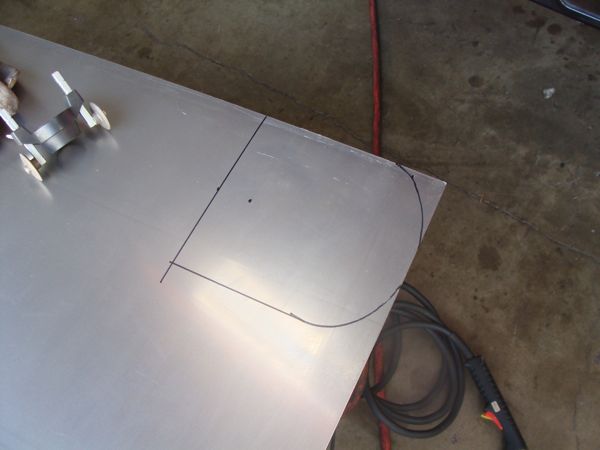

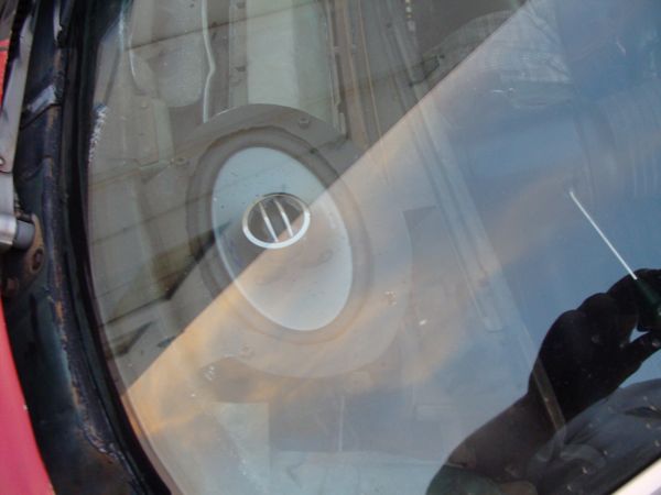

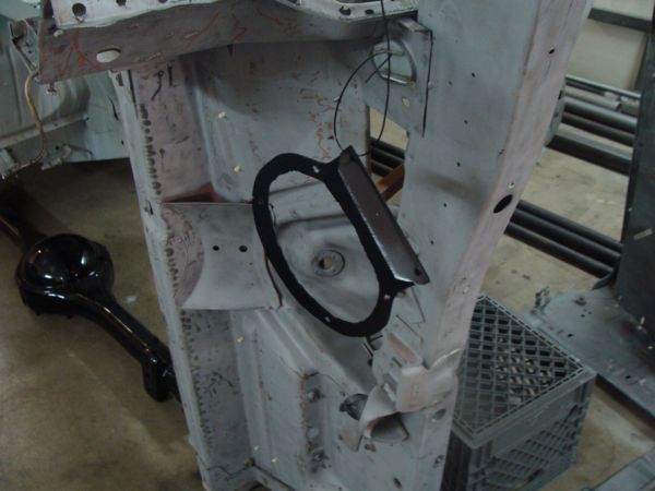

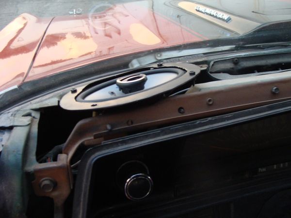

Well its been a while since I asked this question and I opened a can of worms when I took the dash pad off. First I went out and bought a new Alpine head unit that is Ipod ready, then I bought 2) 4x6 2 way speakers and 2) 6x9 3 way speakers both made by alpine. My car had all four speakers in place but they were all blown. I had to cut the rear speaker shelf to get the 3 ways in the rear and I had to make brackets for the front sleakers since they were simply stuck to the metal parts of the dash! The brackets are not my best work but I figured that I couldn't make a career out of doing this install. So I just did some rough cutting with the plasma cutter and threw some paint on em. Man it sounds awesome! I am so happy with it I want to go cruise all around!
