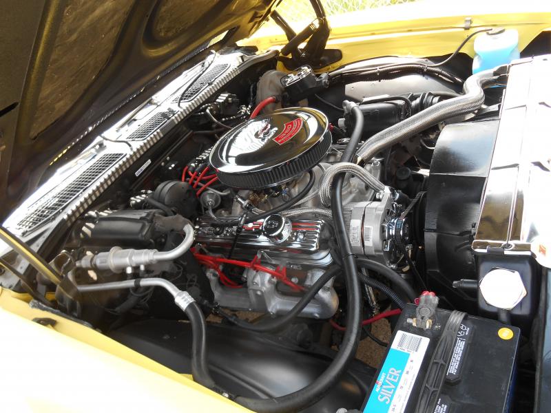

Shaun, I don't know how close a 69 and a 70 are but this is a pic of my 70. The hose goes from the plastic bottle, along the inner fender, over the brake booster and into the pump/motor. Hope this helps ya.

perfect ken that is what i needed to see. I had no idea where it went. I will do a bit more searching on the 69 chevelle to see if that is where it mounts. I searched to see what they are already i know ground up sells all of it but without knowing where it goes and how its hooked up those google pictures do me no good
