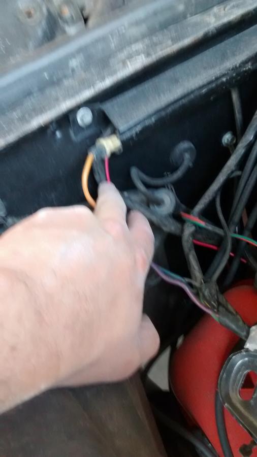

This may help, you can see the alternator wiring in this picture. It drops out of the wiring gutter on the firewall and runs along the valve cover.

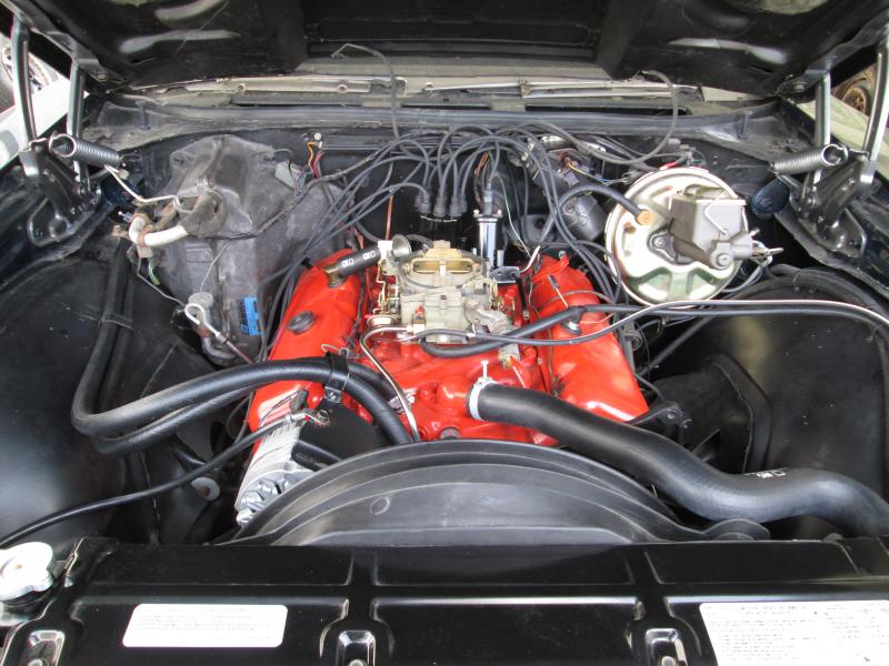

Old 03-24-2016, 03:25 PM

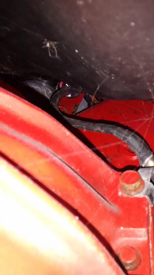

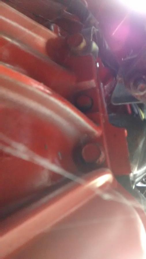

Finally was near the car and took a few pictures...
ID:	3840   Click image for larger version
ID:	3841   Click image for larger version
