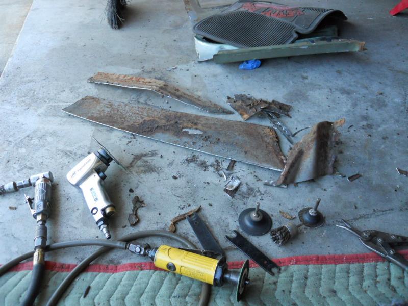

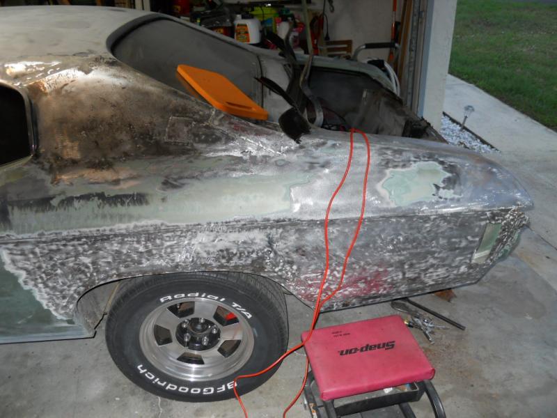

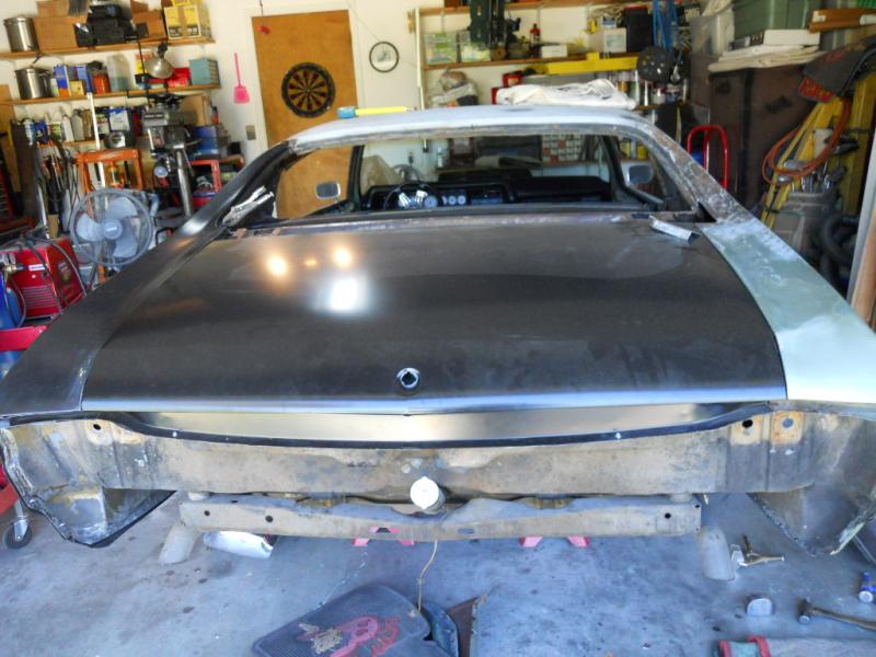

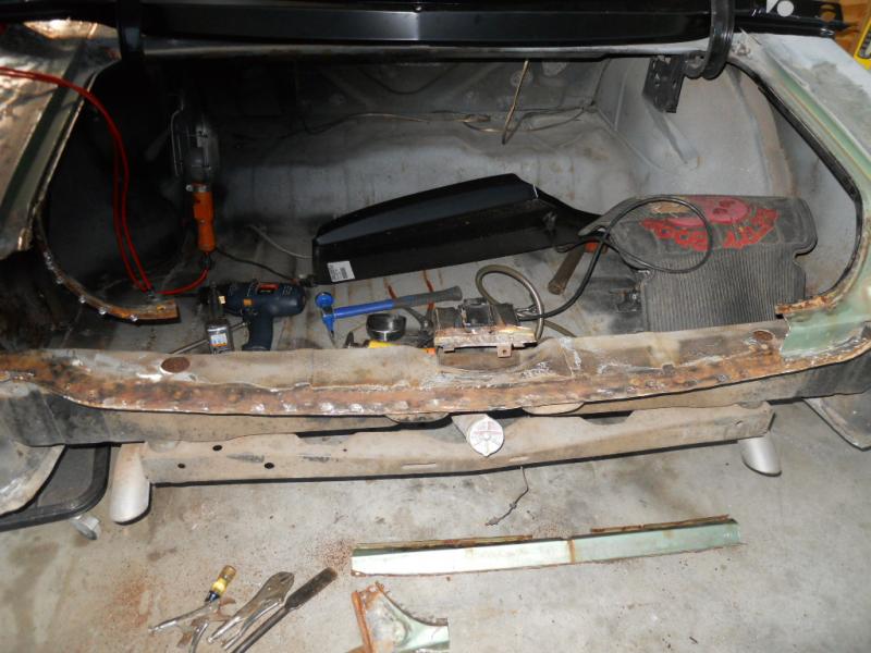

Looks like im doing my own body and paint...cant afford the shop price.
New trunk lid... left quarter panel...tail panel..rear glass filler panel .
Im getting good at drilling spot welds.

You know how to sharpen the bit just for drilling spot welds?
Looks good. I just ended that saga on mine.
Old 01-16-2015, 05:19 AM
Quadracer392's Avatar
Location: West Virginia
Posts: 320
I feel your pain! I'm almost done with the sheetmetal on mine. I found for me the best way to get the spot welds out was the spot weld bits from harbor freight and/or just using an air hammer with a really sharp chisel bit.

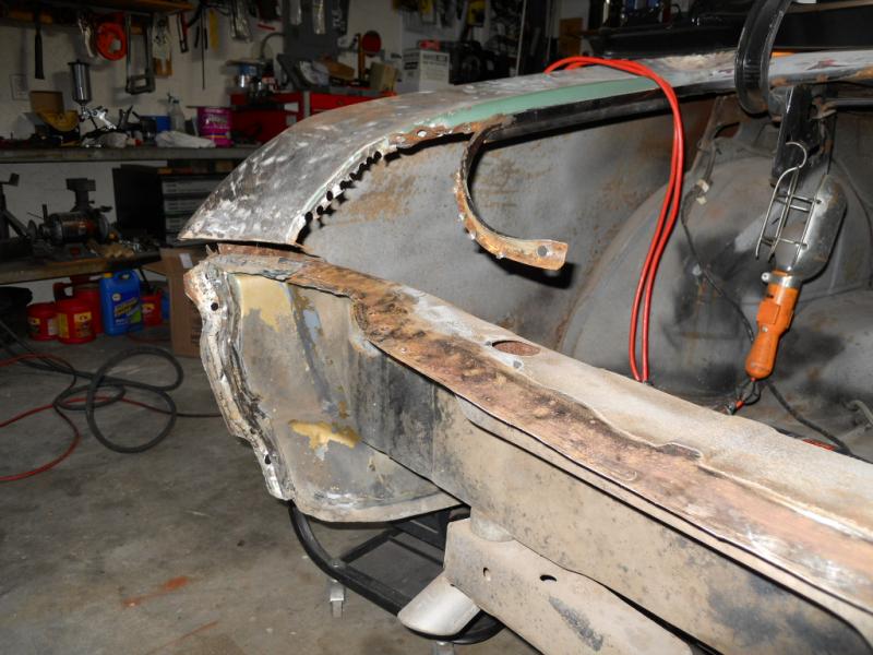

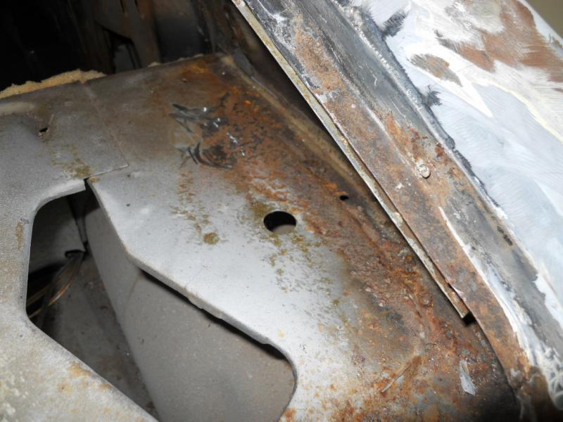

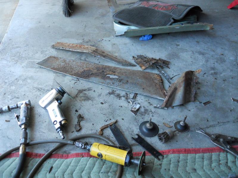

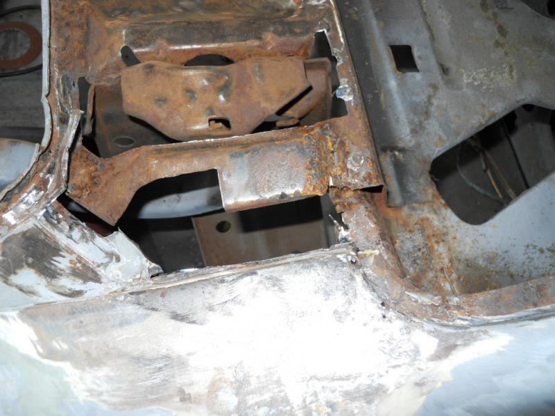

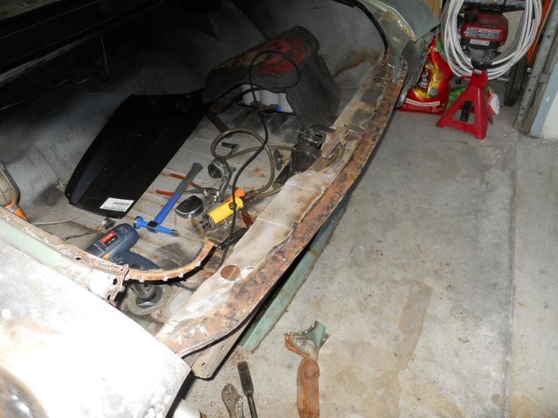

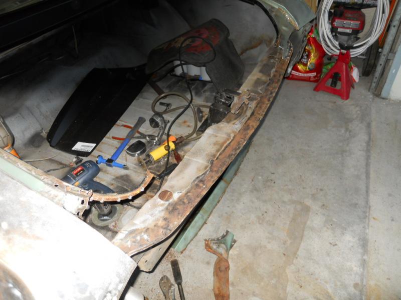

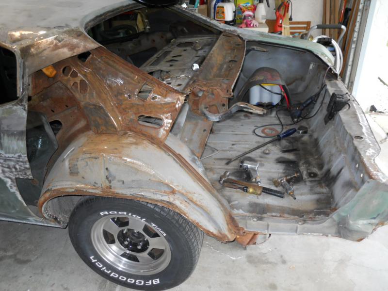

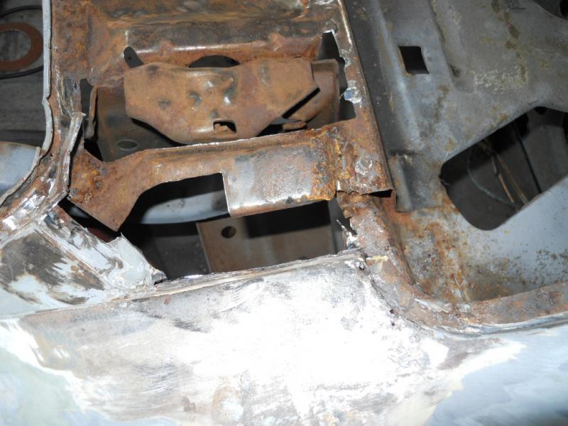

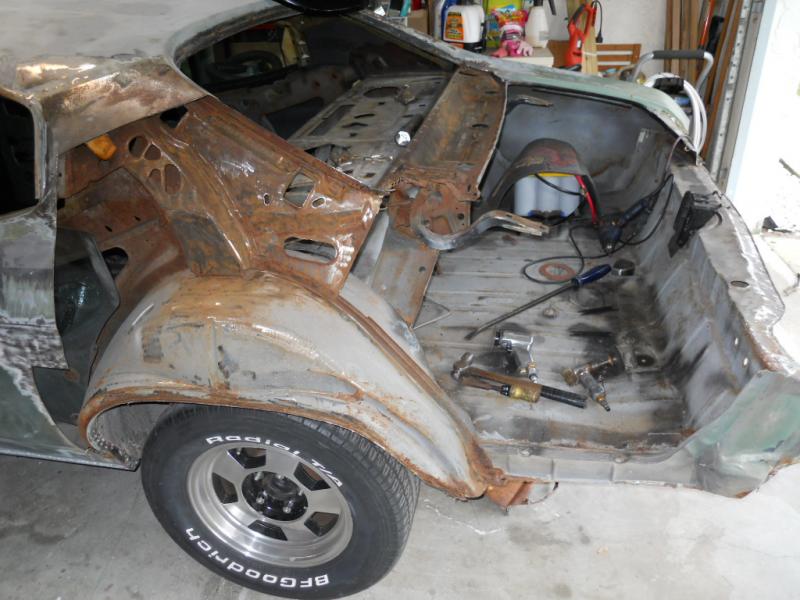

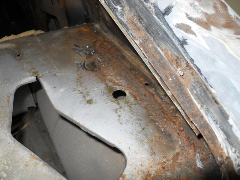

Removed most of the bad quarter panel
Underneath is just surface rust...should clean up ok and
get treated with rust killer and coat of epoxy prime

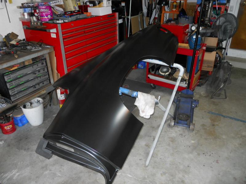

The package tray is a different story...looks like im gona replace it.
Ordered new from ss396/ground up.
The shiping calculator on the site said 37 bucks...should be interesting.
Im still bummed about all the rust damage..it was all because of a bad rear
glass install that i didnt notice was leaking.
And leaving the car sit out in the florida weather for 4 plus years didnt help.LOL.

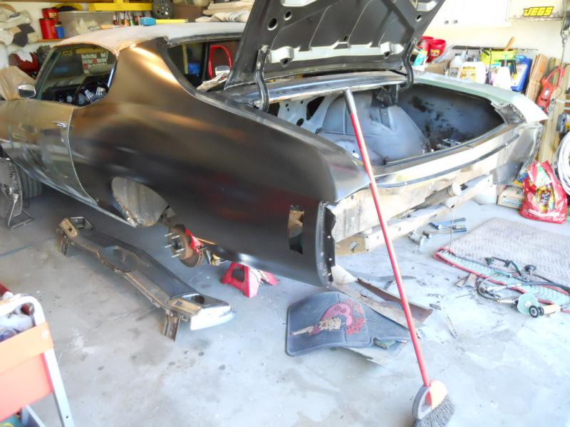

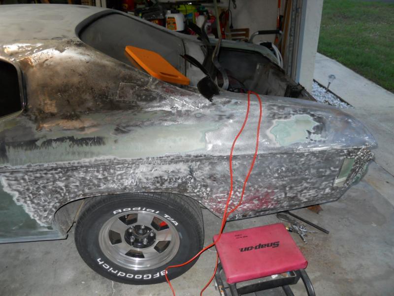

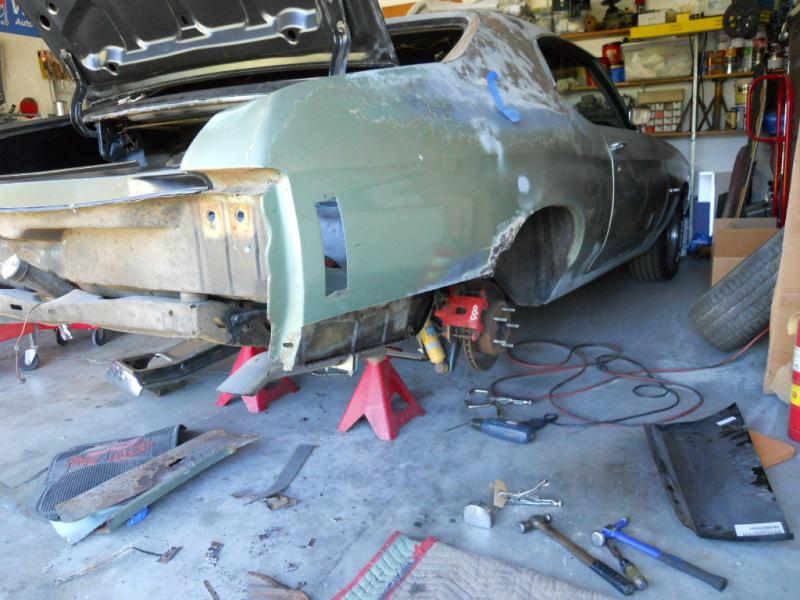

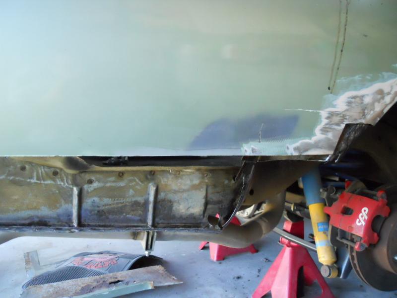

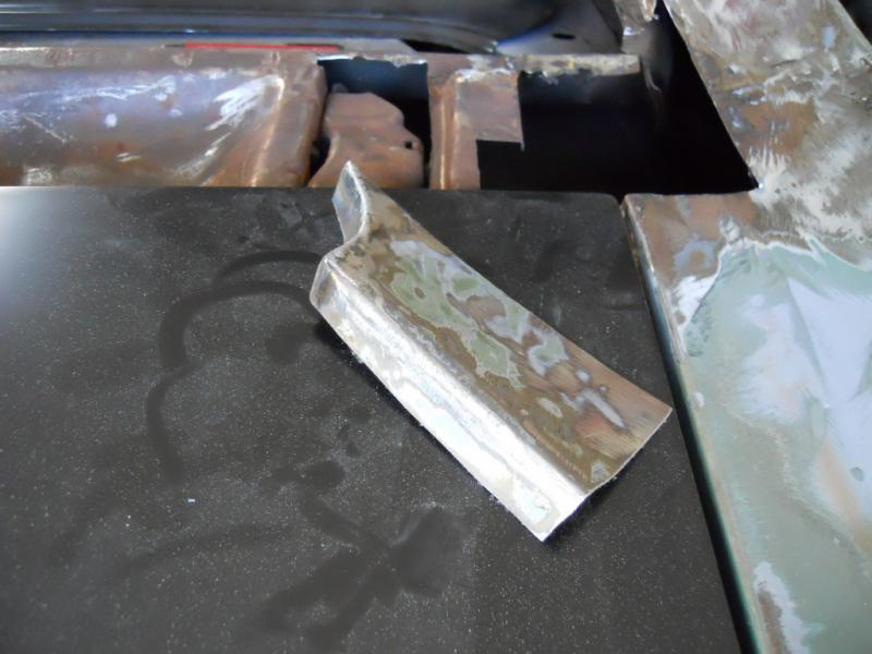

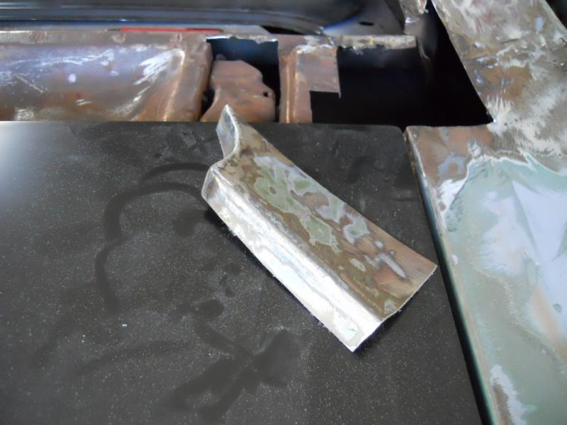

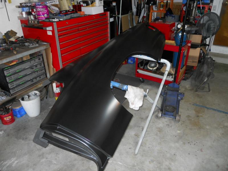

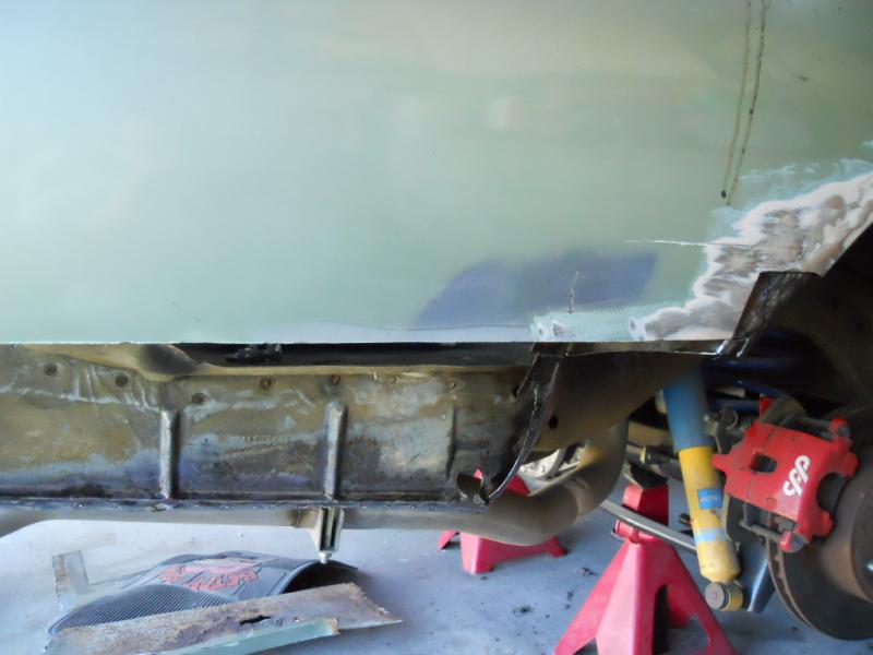

been pluging away at the car.

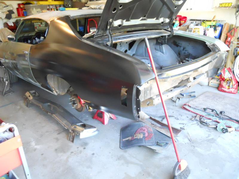

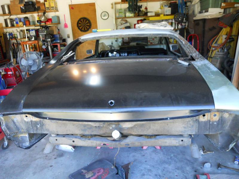

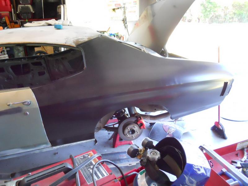

got the quarter test fited and temp screwed on...it needs a little tweek to get
the trunk gap a little smaller but its close.
Right quarter lower patch is in progress...and some home made patches for the
upper quarter to glass track.
Trunk filler is test fited and screwed.
Im waiting on the package tray complete repair panel and outer wheel housings
a few pics.

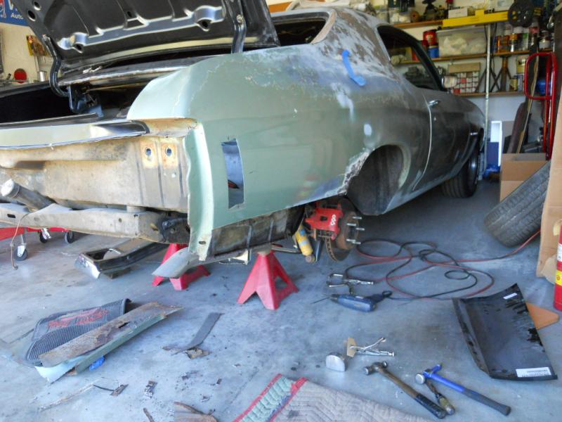

Old 02-12-2015, 12:20 PM
Posts: 446
few more pics

Youre not wasting any time ,looking good .Im not that brave or talented .

Look very good. Best way to take care of the rust is to sand blast it down to bare metals and then expoy prime it. Just killers don't work. Only kills the rust on top.
