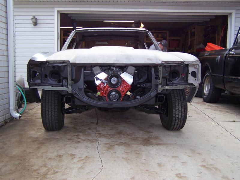

Default Here is the engine were building for our 72
Here is the specs on the motor *edited* its now back in he car.
69 block .060 over.
TRW LF2304F
Cast crank and rods balanced
Dart 11221111P 72 cc heads with 180 runners
Fel pro permator 7733PT2 head gaskets
1.45 springs
Comp cams hyd roller 294/300 .242/.248 .540/ .562 110 deg lobe.
Comp roller ultra pro magnum roller rockers 1.52
Pro magnum push rods
Dart sportsman II dual plane intake
Holley 770 street avenger
Hooker comp headers 2451 full length
Flowmater 2 1/2 American thunder exhaust and series 40 mufflers
MSD HEI
MSD 6AL2
Trans is a TH350 with shift kit and Hughes 3200 stall going to a 10 bolt with and eaton posi and 3.73 gears. Rear 1" sway bar. Tires are 275/60/15 TA's on the street and the same size TA drag radials for the strip. UMI tube upper and lower control arms frame braces. The car will be stock weight but currently working on lower its stance and firming up the suspension.

Just wondering... have you thought about going to 275/50x15 drag radials?
With my 3.90 gears I run 255/70x15 on the street(29" tall) and 275/50x15 drag radials (approx. 26" tall) at the track to get my effective gearing a little lower.

I am planning to use 275 drag radials for the track and 18's, still undecided what size yet, for the street.

Decided to go with a vac secondary carb so I bit the bullet and ordered one today. Got the Holley 770 alum street avenger. Hoping it will keep things more streetable then the dbl pumper.
Also picking up a 6AL2 box. Cannot wait to hear it run

Man I cannot wait to hear this motor fire up for the first time in close to a year. Be nice not to foul plugs left and right to. The old dbl pumper hated the street.
I considered getting the air gap manifold but think the Dart should do fine.

That ought to make some great power. Those pistons must be domes to be able to run those heads and that cam together. With the rest of the drivetrain matched up and the car ready to squat and go, you'll be giving some bbc's a lesson or two.

Got to hear her fire up today. Man it sounds sweet. Cannot wait to get behind the wheel !
