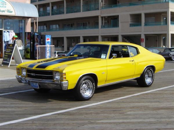

Here is a picture.

Welcome John. Looks like a nice car. I had problems with vacuum. Installed a canister like previously suggested and it cured my problem. My problem had more to do with the bigger cam and carb and when I braked I lost a lot of vacuum. Good luck, and just so you know. If you put your pics into an album on your profile page, you will be able to use the BB code and post larger pictures into the threads.
