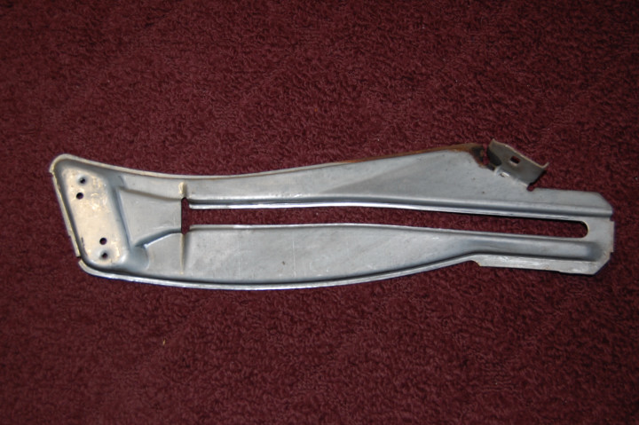

Take a good look at the guide rail (pic #1) that runs top to bottom. This holds it all together. It's held in place by a bracket at the bottom and the one at the top above the regulator.

First pic is driver's side guide rail, top of rail on left. Fixed nylon guide on window, the one that does not turn slides down the center slot of guide rail from the top.
