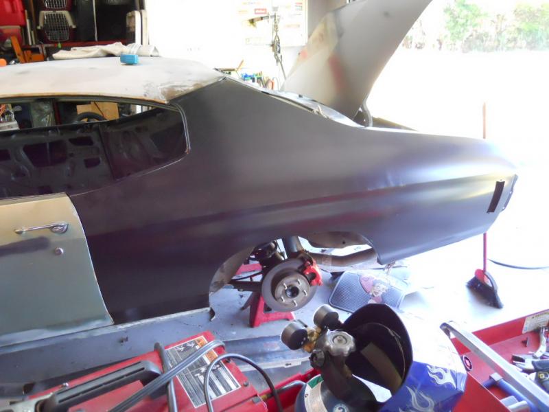

Default update on the torture
been pluging away at the car.
got the quarter test fited and temp screwed on...it needs a little tweek to get
the trunk gap a little smaller but its close.
Right quarter lower patch is in progress...and some home made patches for the
upper quarter to glass track.
Trunk filler is test fited and screwed.
Im waiting on the package tray complete repair panel and outer wheel housings
a few pics.

Old 02-12-2015, 07:10 PM
Youre not wasting any time ,looking good .Im not that brave or talented .
Old 02-12-2015, 11:49 PM
Look very good. Best way to take care of the rust is to sand blast it down to bare metals and then expoy prime it. Just killers don't work. Only kills the rust on top.
