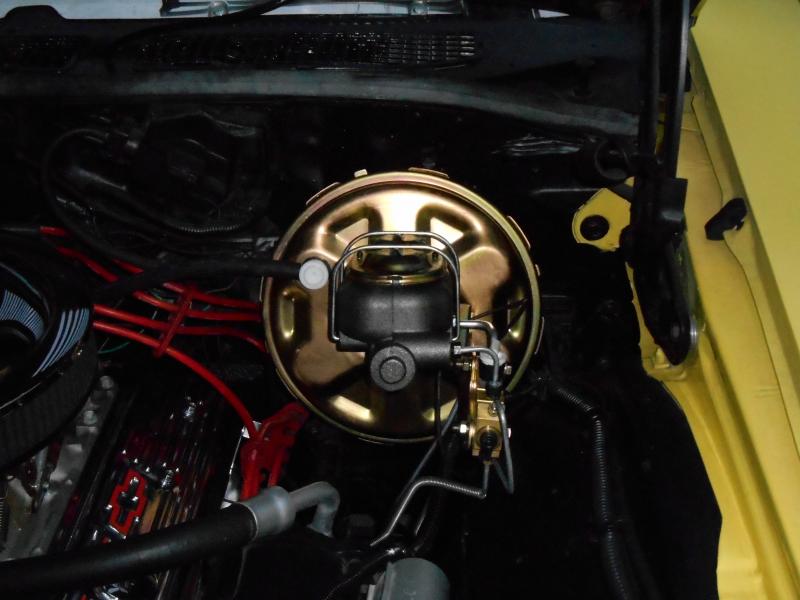

That white part looks like it was cut "cam" style. Being a retired toolmaker I agree with you on that being a defective part.
Hank, my valve came with my kit along with a new booster and master cylinder. Everything works great. This car will now stop on a dime and give me 20¢ change. If I were you I would go with Right Stuff on a new valve.

Ken, how nice that shiny new booster and new MC look on your car. Even though Inline is going to send me a new valve I will be putting the one I ordered from the Right Stuff in. It is supposed to be here today.
