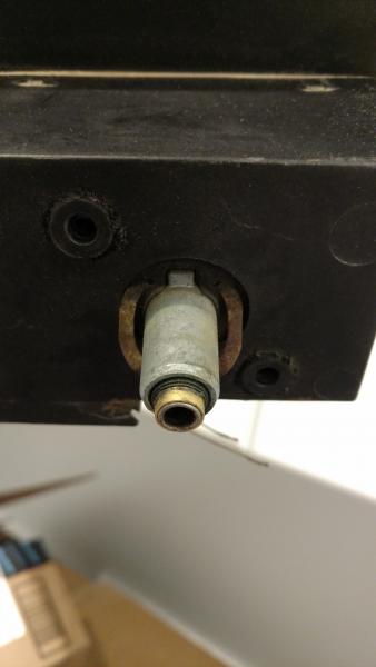

Here's a picture of the back of the speedometer:
There is a little clip like thing in there. Since I never saw it together I'm not sure what it should look like.

Nothing wrong with that speedometer just need the right cable. The one pictured looks correct. I will be home tomorrow. I will go look at mine. I got the cable on one of the benches still. They say it is the same as mine and I got the original one still.
That's the correct set up.
