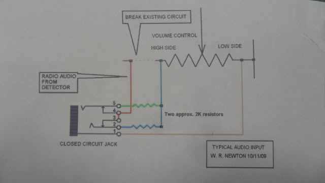

Install a input mini jack into the stock radio and plug your I pod in.. It sounds surprising good!!
