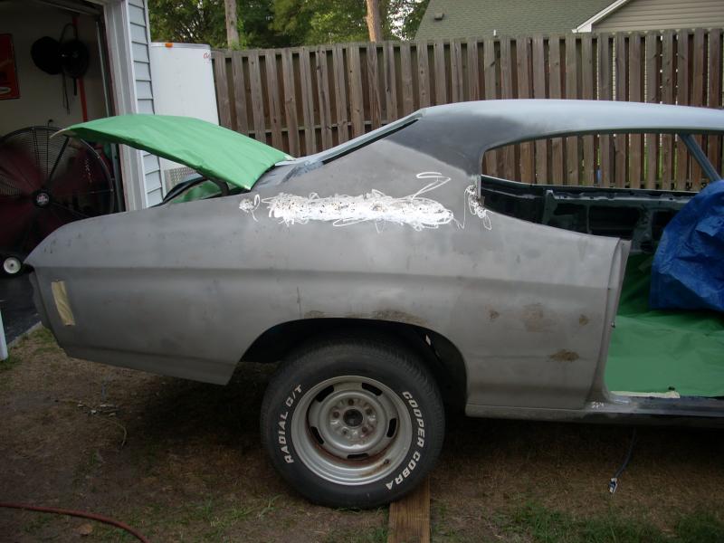

Some pictures. First picture of the upper balljoint, if you notice the boot dosent fit the top properly. Is this because there is no motor in the frame? Will it fit/look right with the weight of the motor on it? Or did I assemble something wrong?

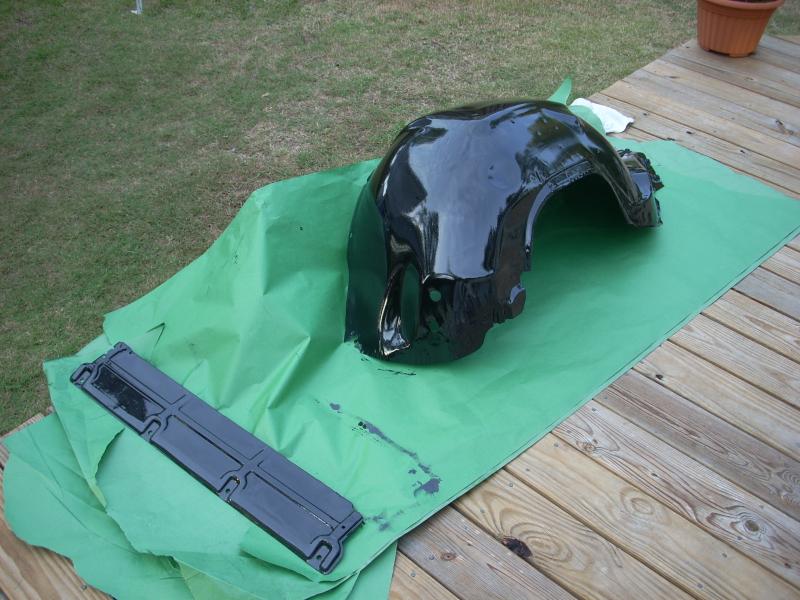

More Photos and Julie my sweetheart helping POR15 the radiator support and inner fender.

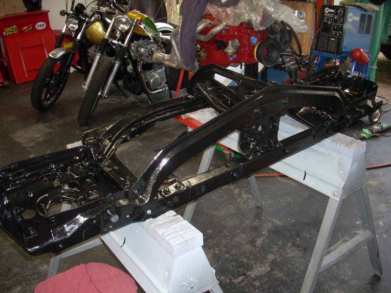

More photos

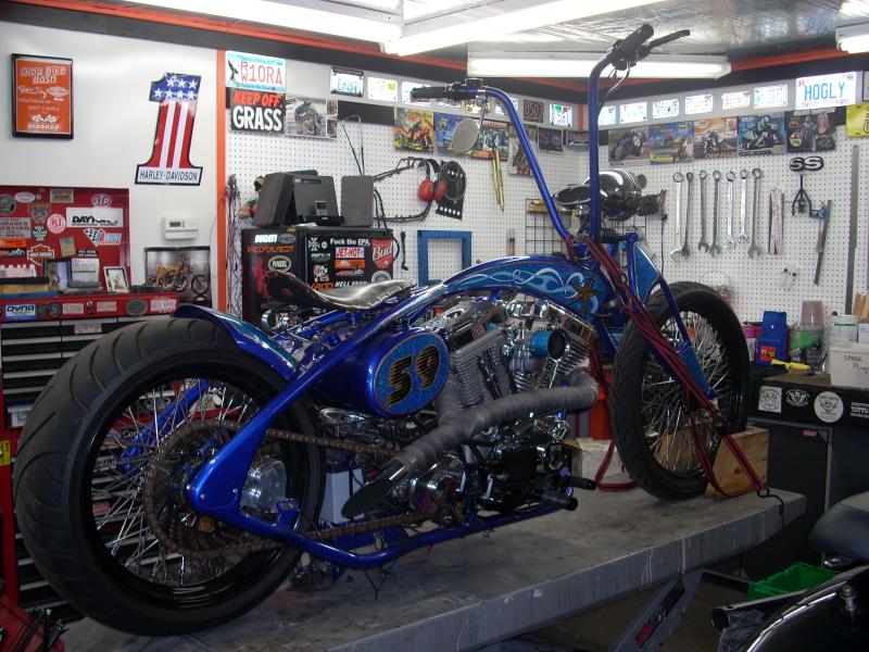

A couple random shots of my dog (Ralph) keeping an eye on me while I work. He cant wait to go for a ride!
Also a very rare bike I am tearing down and painting flat black with gloss black ghost flames. Why he wants to ruin a perfectly good paint job, I have no Idea. I just need the money! I hope yall enjoy. Thanks for taken the time to look.

What do yall think of the top balljoint in the first photo of post #89? The boots not hitting the spindle.

Its hard to say until the complete nose is on it and you got the engine and trans in it. The suspension will drop a good amount and it may seat. Are you sure the ball joints are fully seated? Is it all stock replacement stuff? I know some spindles are machined to take B-body ball joints instead of the A-body joints for running Caprice/Impala brakes on a Chevelle. Is it possible you got the wrong ones? maybe just the boots are wrong? I'd get it loaded to ride height before jumping to any conclusions but just some things to think about.
