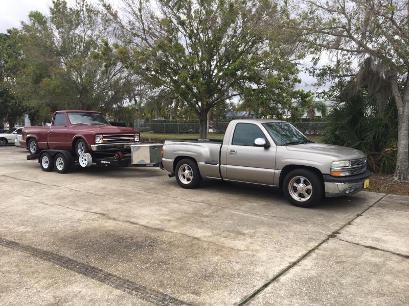

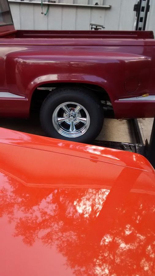

Much better.
ID:	4010   Click image for larger version

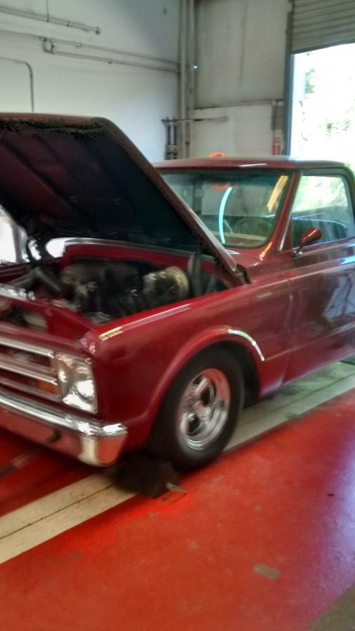

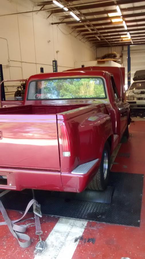

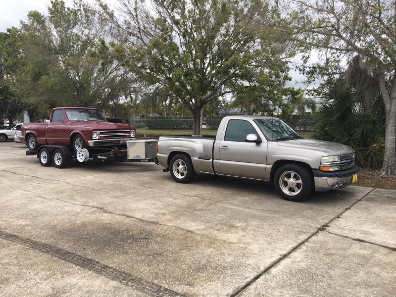

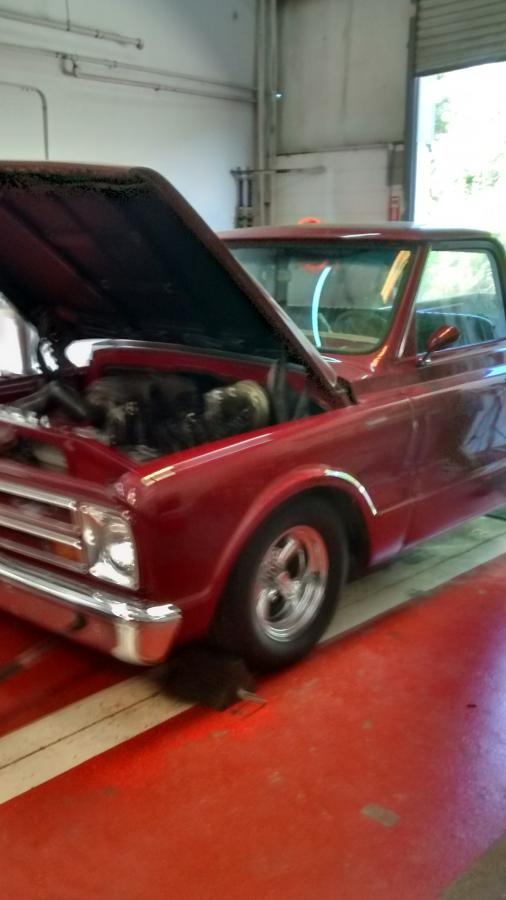

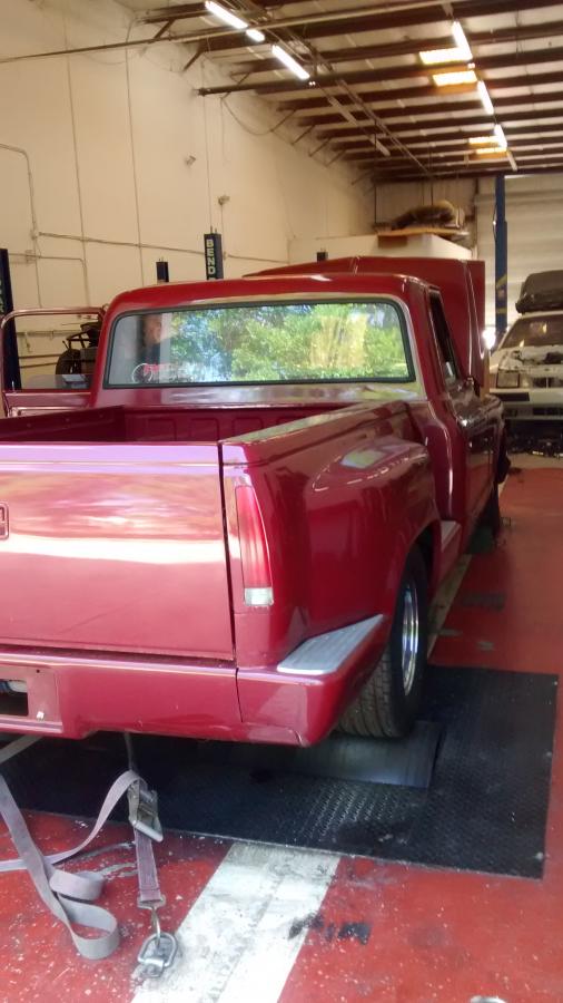

Well, things didn't go as planned. It has a miss, and something is up with the #7 cylinder. I need to do a compression and leak down test. My father is devastated and wants to get rid of the truck.
ID:	4108   Click image for larger version
ID:	4109   Click image for larger version

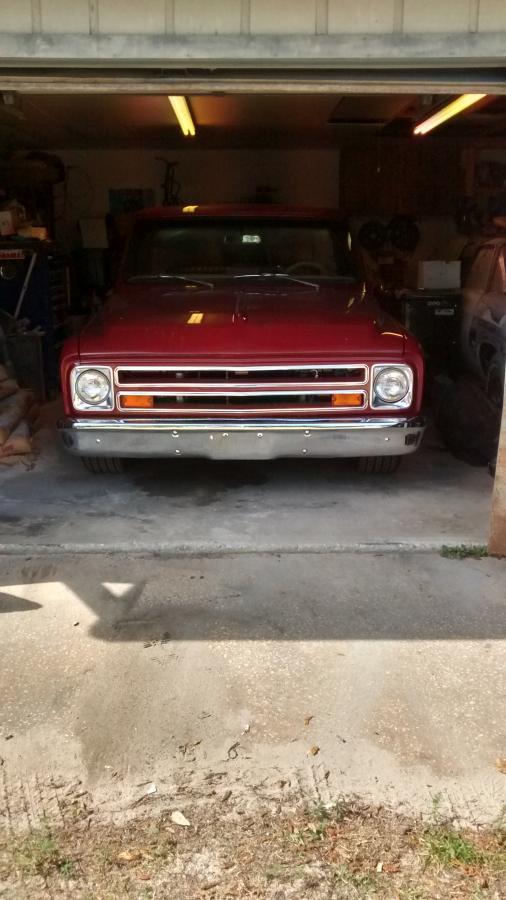

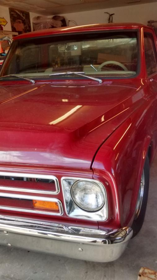

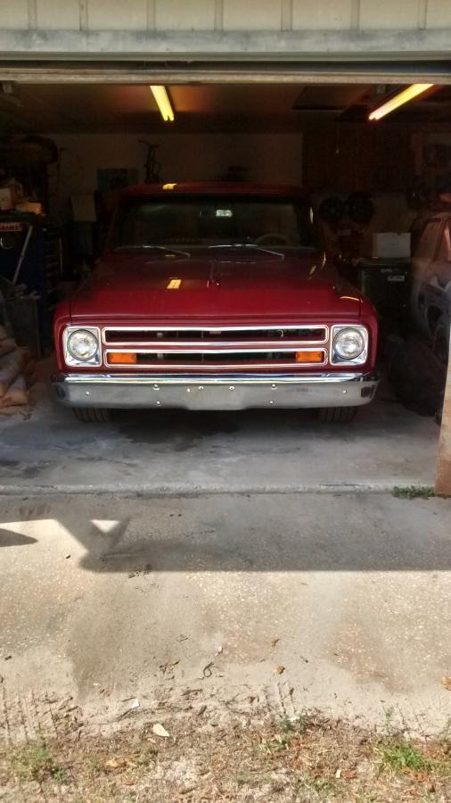

I took a little time today to pop the valve cover and look for any broken valve springs. Everything looks good. I was suspicious of the plug wire, changed that wire. No real change, still flutters at idle. Next is a compression test, and I want to move the injector from that cylinder to another to see if the miss follows it.
It's tucked away in the garage for now.
ID:	4121   Click image for larger version
