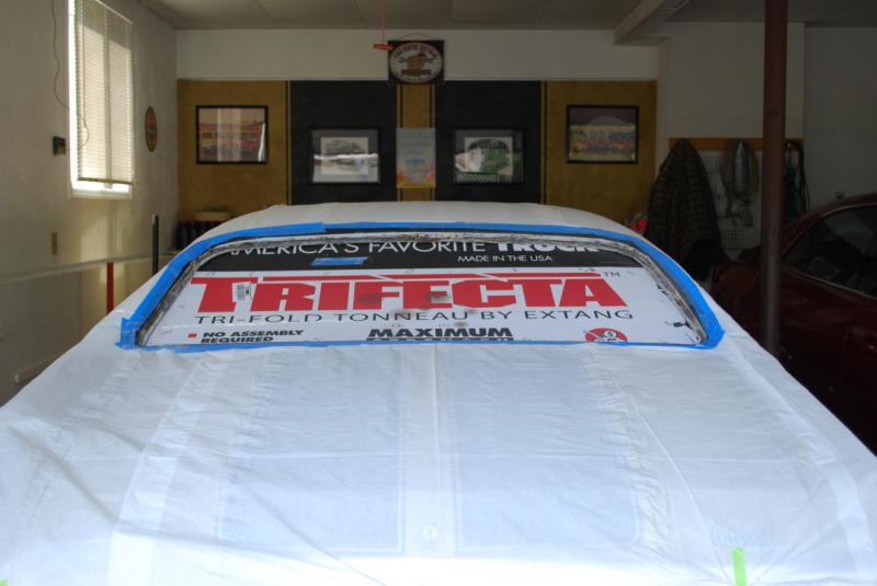

Got my rear window installed, what do you think? The old one was clear and let in too much sunlight. This one definitely blocks a lot more sunlight.
Started cleaning out the pinch weld today. Cardboard will hopefully keep some of the crap out of car. A brass wire wheel to remove the urethane, butyl, and mystery goop I couldn't scrap and cut out. Spot blaster to remove the rust Not too much, lower corners as expected. Didn't get the rear finished today, close to 90* this afternoon. Once the sun moved past the shed and I was in the sun I quit. Don't really want to blast that crap out inside the garage. I'll have to start early tomorrow to take advantage of the shade. Then on to the front windshield.

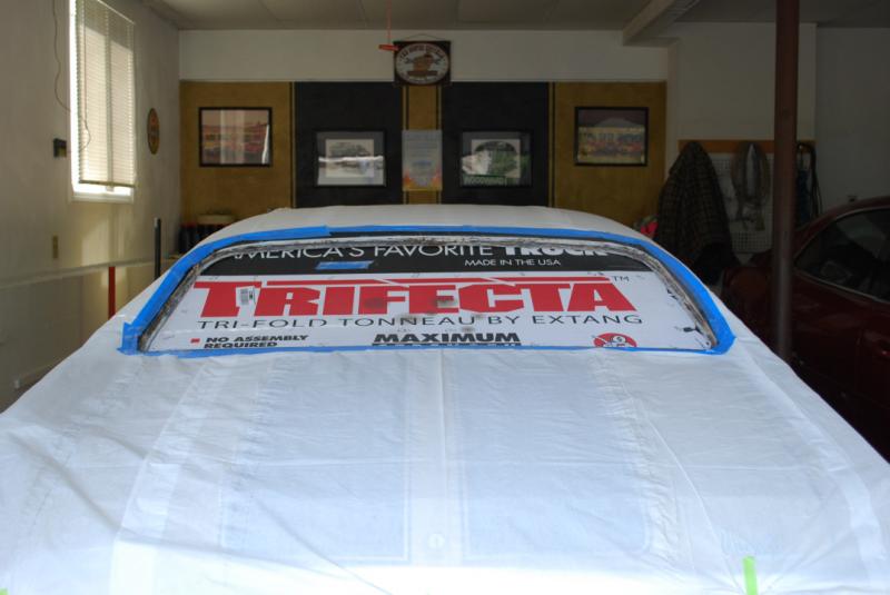

I'd be scared to do that to mine with the vinyl top as I'd expect the worst. In 1981 I went to Alabama and bought a 73 Elcamino and it was nice and when broke the back window out it was so rotted that I had to spend big bucks to have it redone just to hole the window in.
