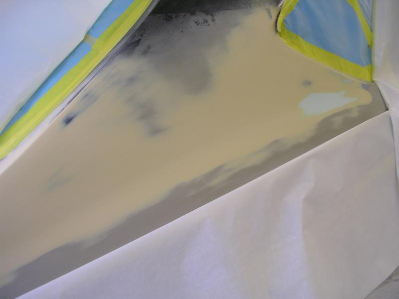

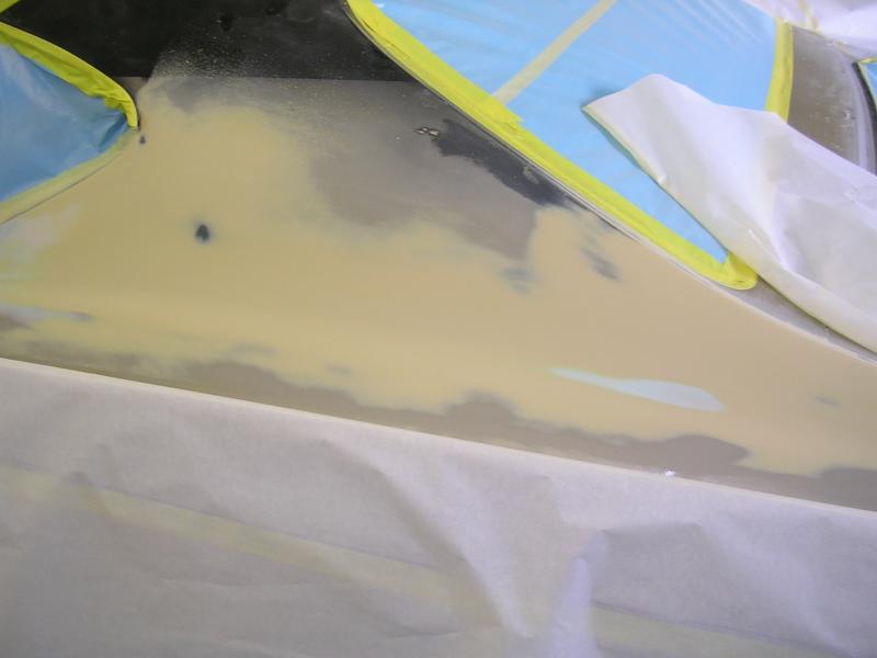

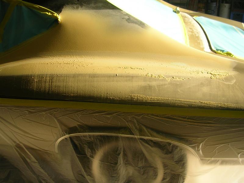

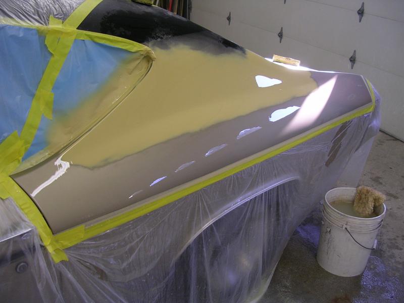

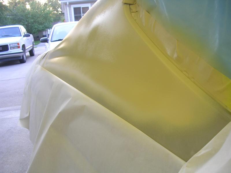

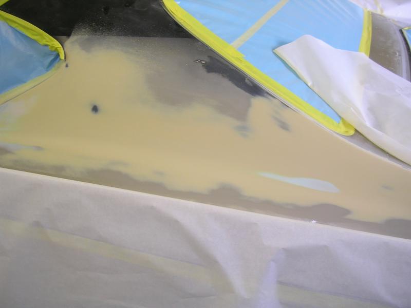

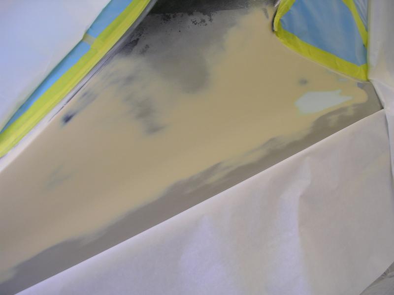

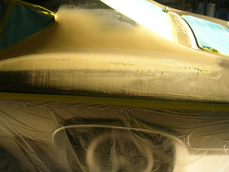

Today after work I blocked down the primer I applied yesterday,and I used 240 grit exclusively.You can see some areas where I did not get enough material off before it was primed.It's hard too judge when your dealing with repair area of these size's not to mention a gradual curve with a negative radius of this length....can be somewhat tricky
But it did turn out nice after one blocking. I put three more coats of primer on the area's with some extra reducer in the mix so it lays a bit flatter/smoother for easier final sanding before the topcoats. If things go well I should have the custom mixed paint tomorrow and possibly spray color/clear tomorrow night
Here's another round of shots.............

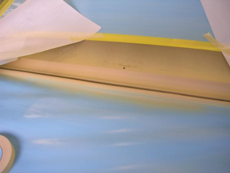

I also got some primer on the rear gutter........

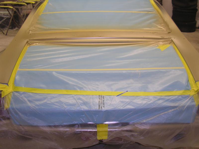

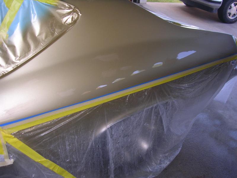

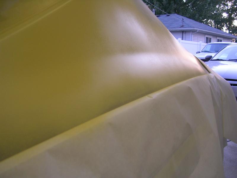

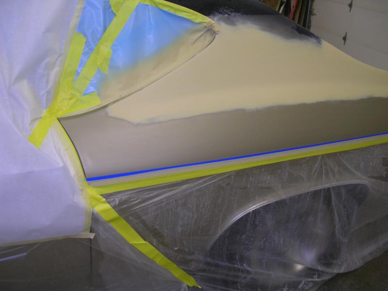

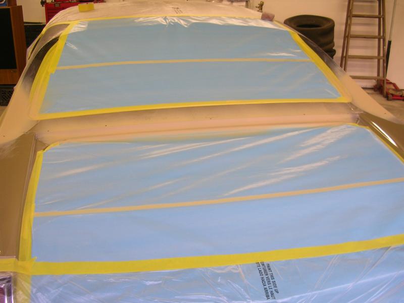

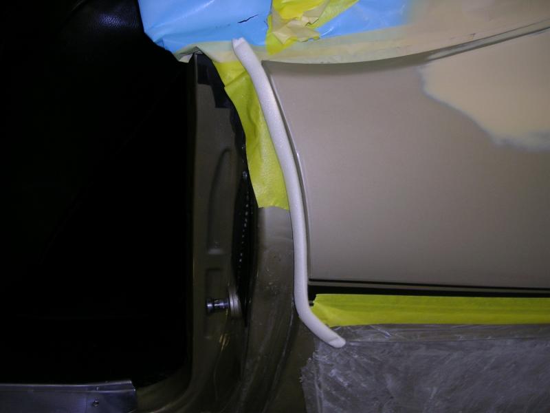

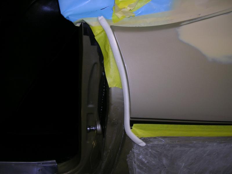

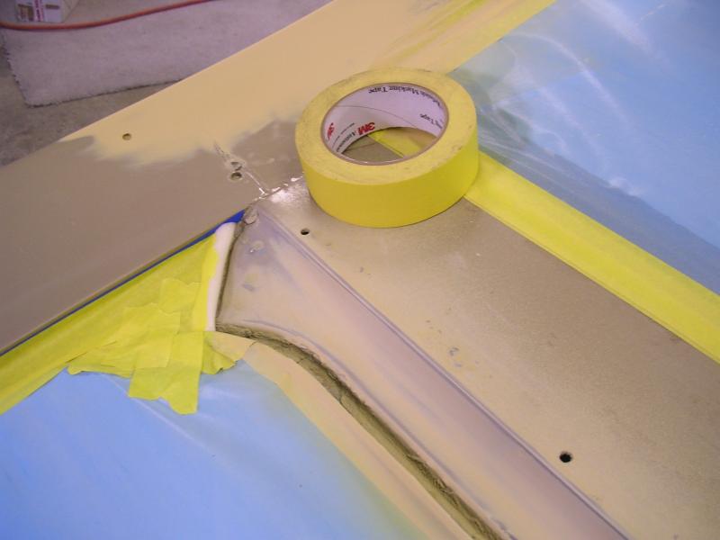

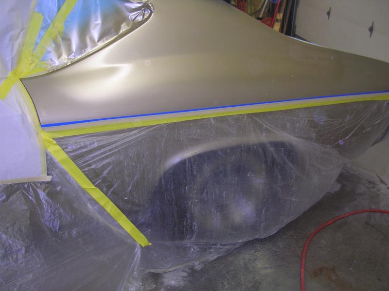

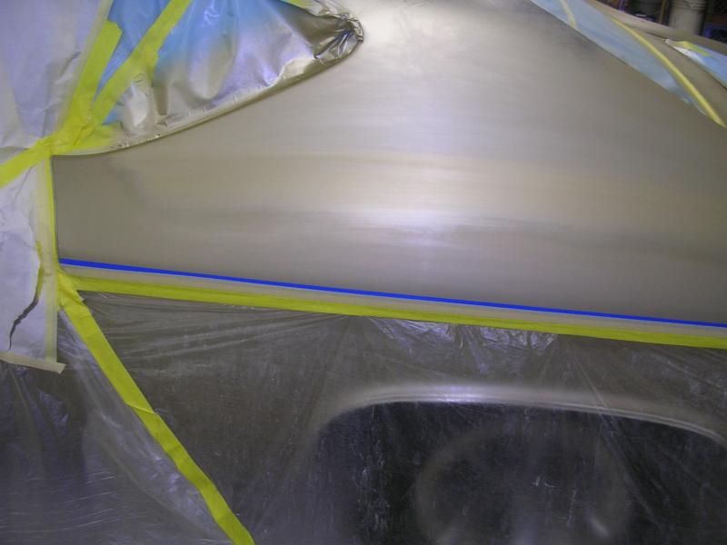

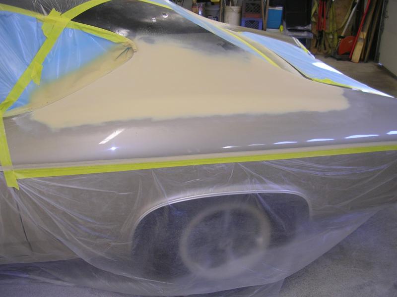

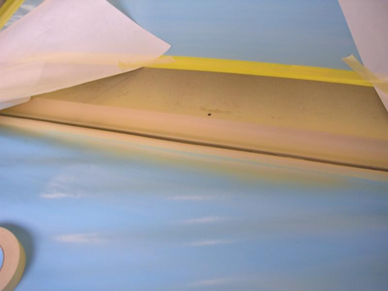

Ok, I started with blocksanding with 320 grit(dry) on the reprimed area's and finished up by wetsanding the entire surfaces after that with 600 grit to get them nice and smooth/flat for the topcoats....

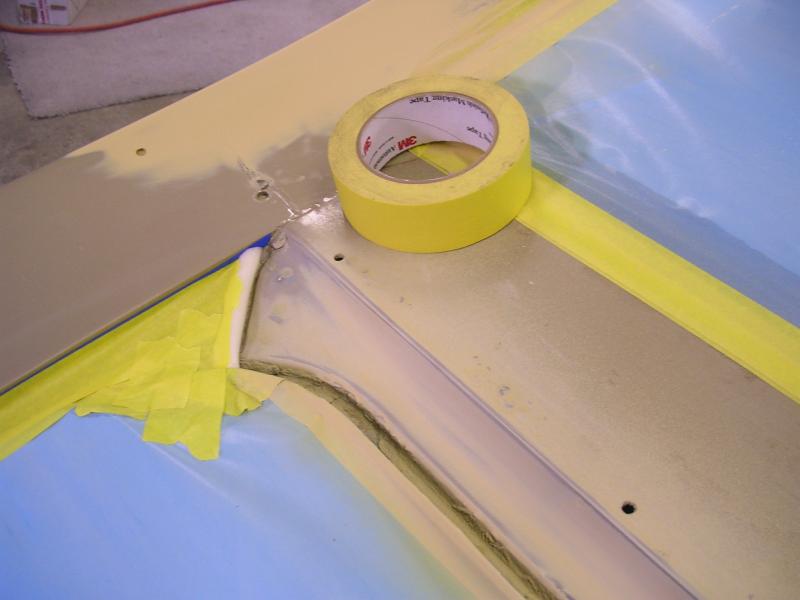

Next is to get the car dry and start to tape everything for paint.This is a very important process that gets overlooked by many.You want to make sure the tape is secure so that it does not come up during the paint process.Solvents in these chemicals tend to attack the adhesive on the tape making it lift so I keep an eye on this during the entire process of the job from having unesessary overspray getting under the car cover.
I use "jamb" tape in a couple locations so when the paint is sprayed here,it will go in "tapered" instead of having a sharp line.Usually after the job is complete you can hardly notice an edge.
I will be applying clear all the way down to the stripe so I use "fineline" plastic tape on the edge of that. Regular masking tape will tend too (bleed) through the edges and under,leaving a shitty mess.If you've done some painting at home using this you will know what I'm talking about...........

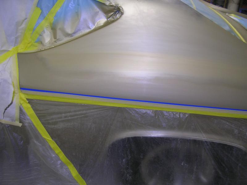

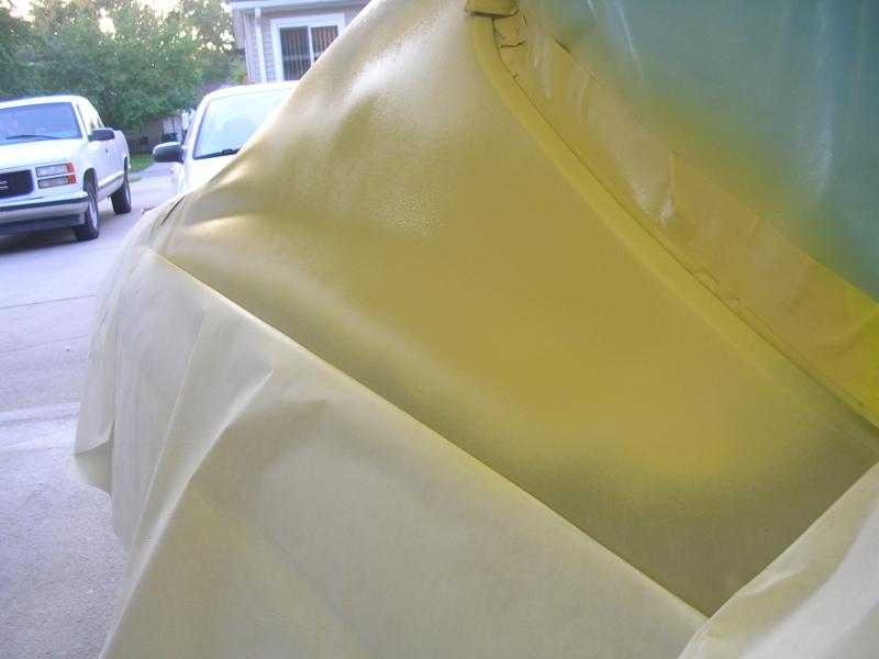

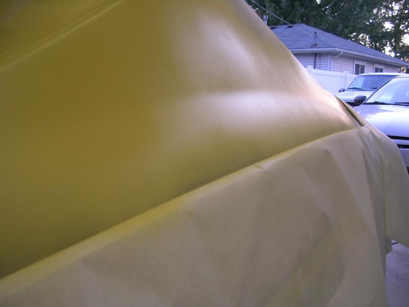

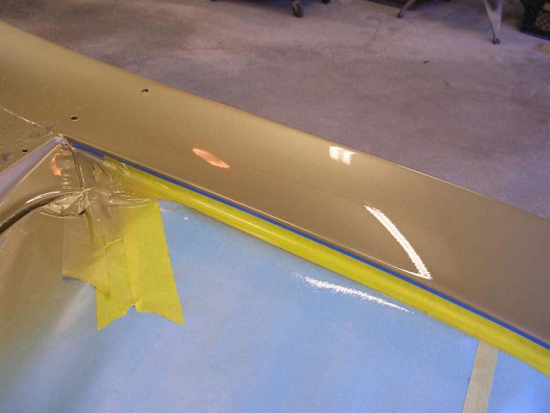

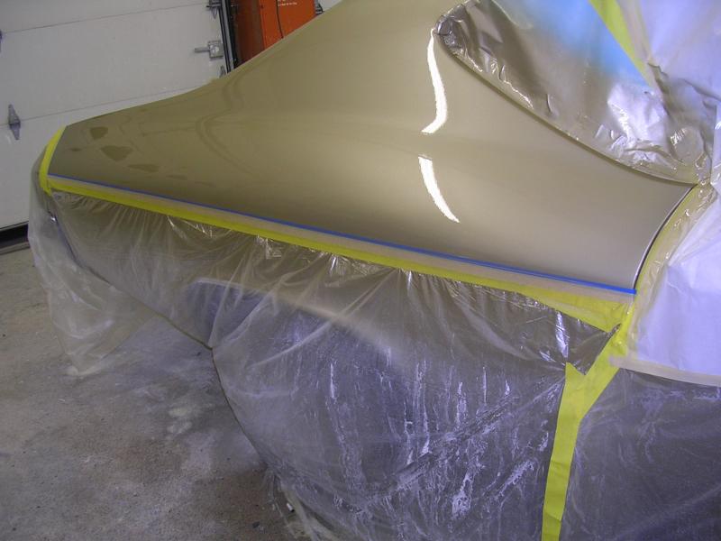

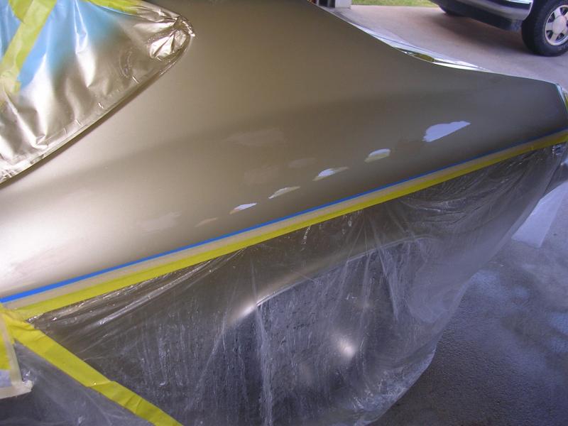

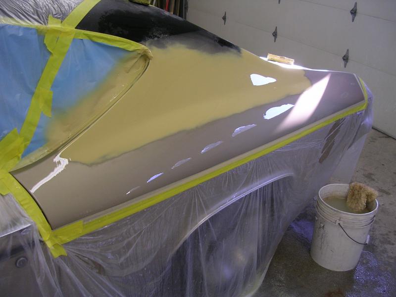

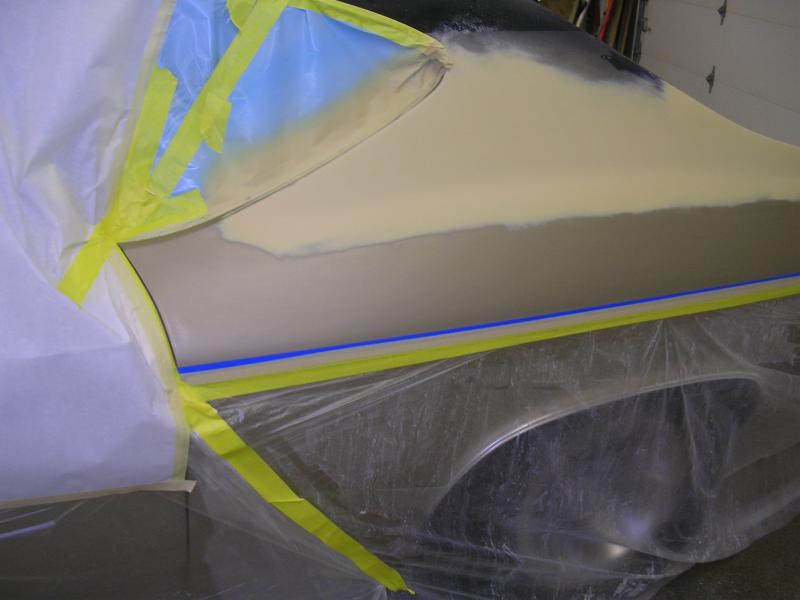

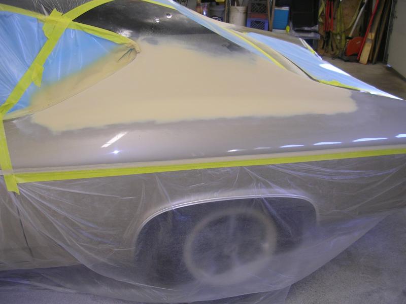

I don't have any sealer and frankly,I don't want to use it here cause we are to close to the doors.So what i did was to use the paint and apply two descent coats over the primer and allow that too dry and sand that down as to "seal" were the two different materials meet...If you don't do this you will see a funky line where they come together.
After this I apply another coat of the color and start to make judgement on the tint......it is too light !

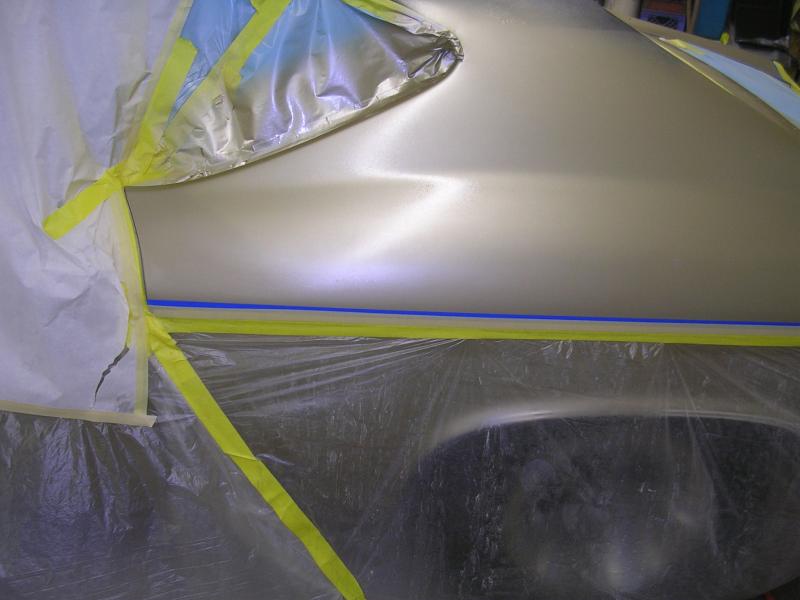

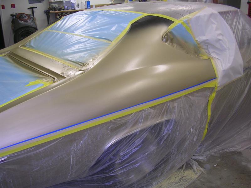

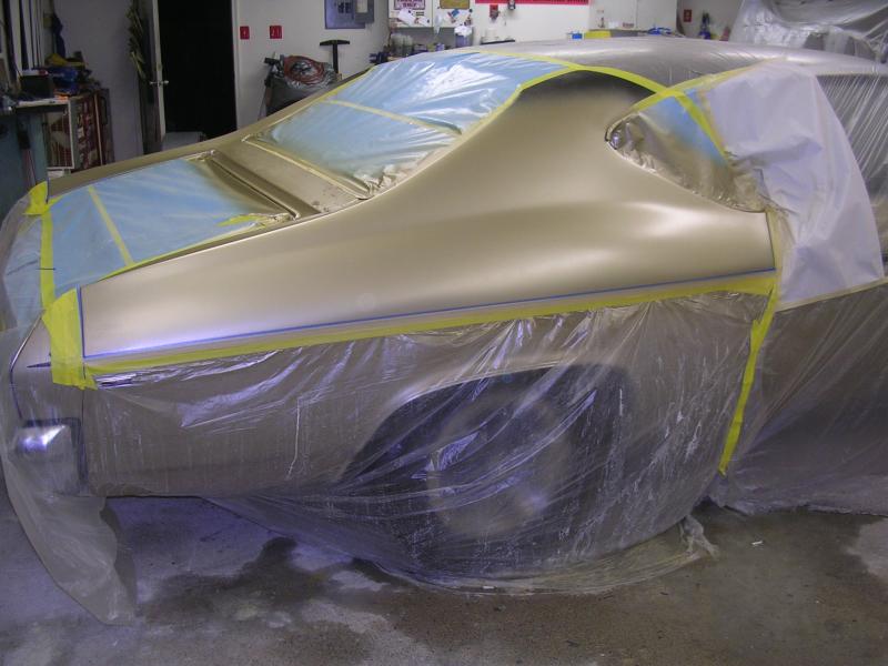

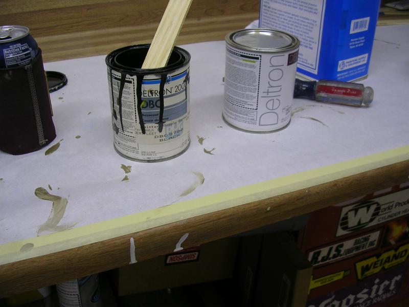

They supplied me with some silver tint but that would have gone the wrong direction so what i did was end dropping in about 10 drops of "black" paint into the mix to "dirty" it up which helped alot from what we had,definately a step in the right direction. After spending some time at the edges of the blends ,it's time for clear.......

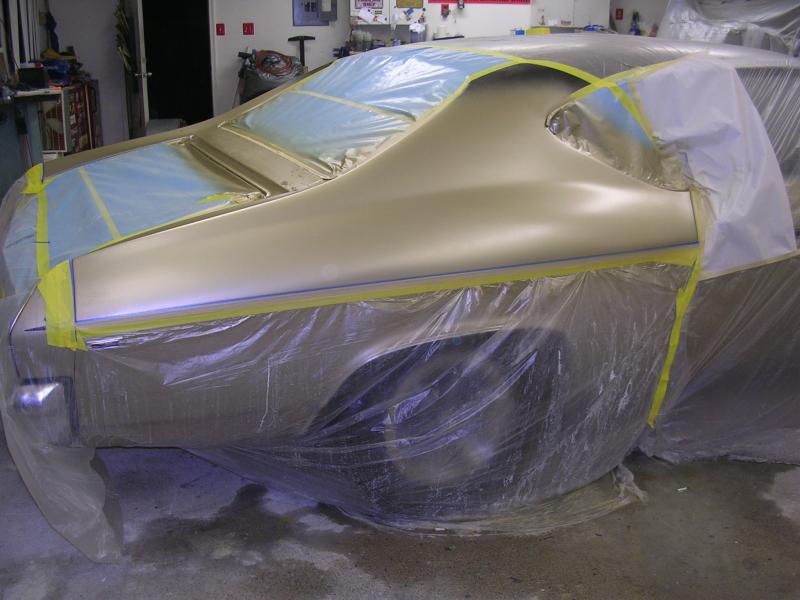

  #18
Old 10-08-2011, 04:07 PM
GDwrench GDwrench is offline
Join Date: Sep 2011
Location: SE lwr Mich
Posts: 35

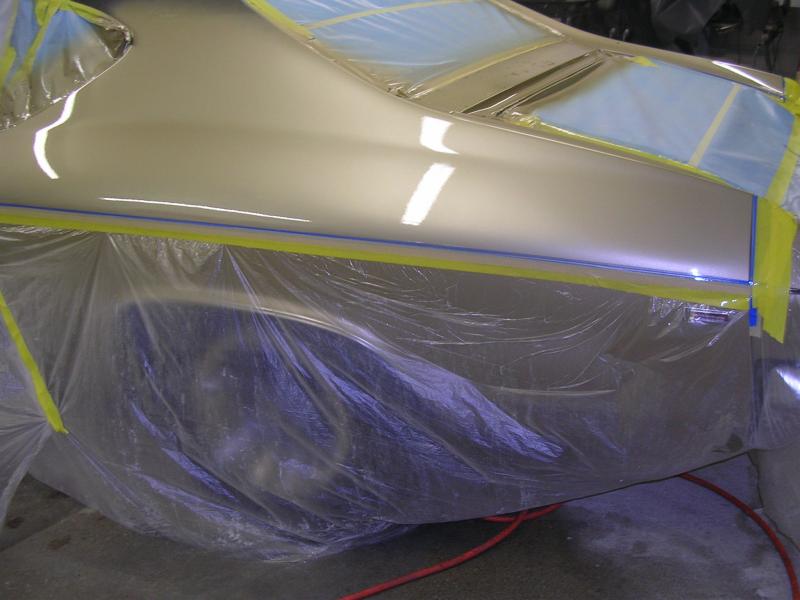

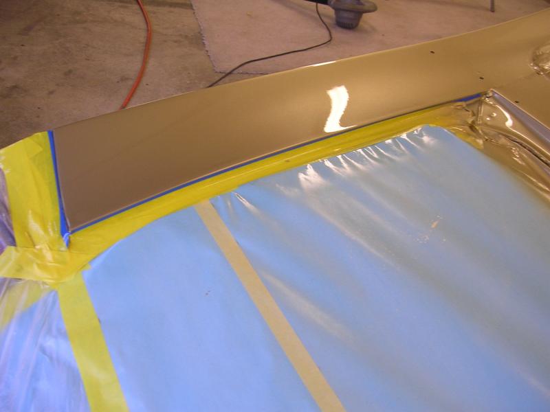

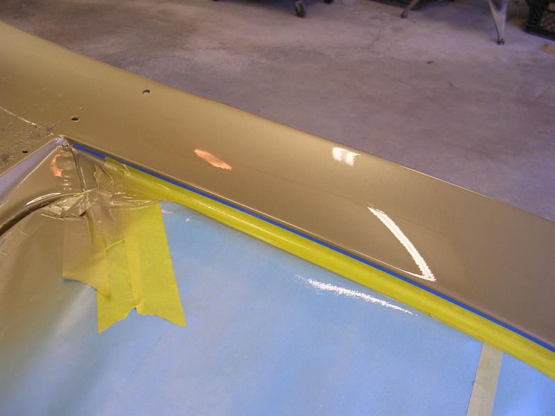

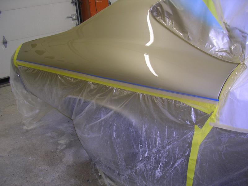

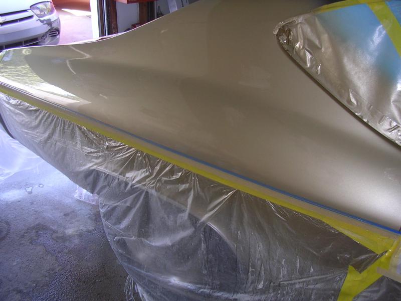

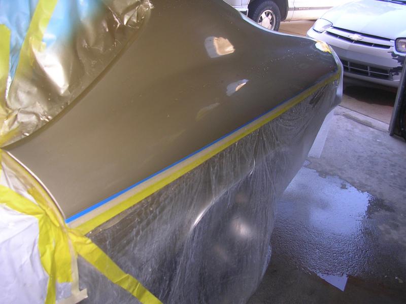

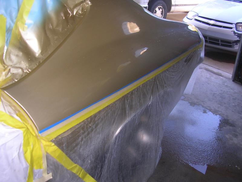

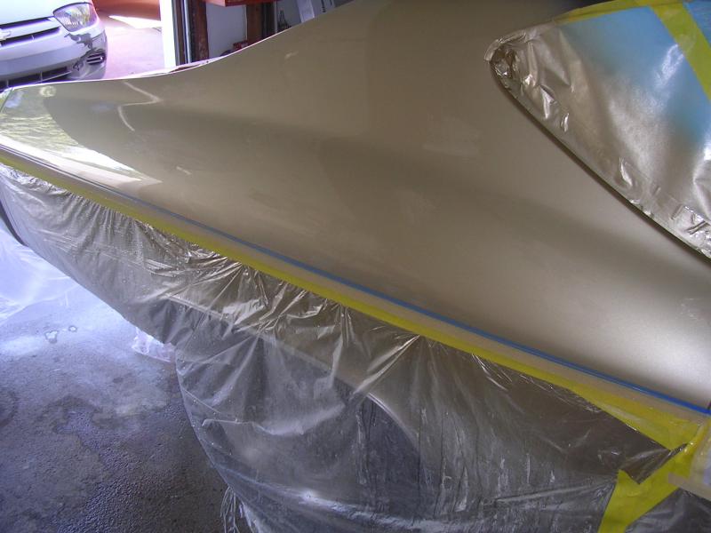

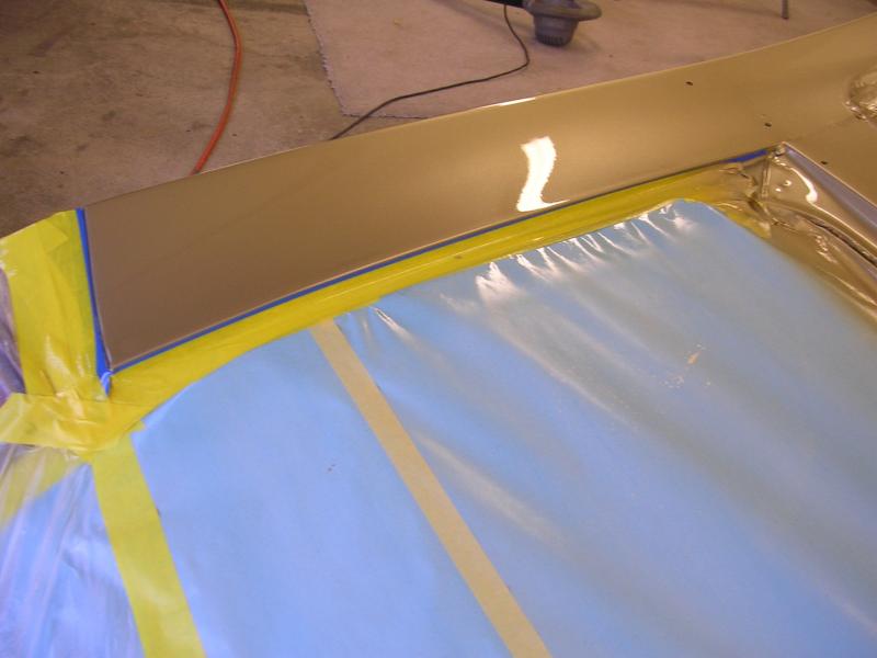

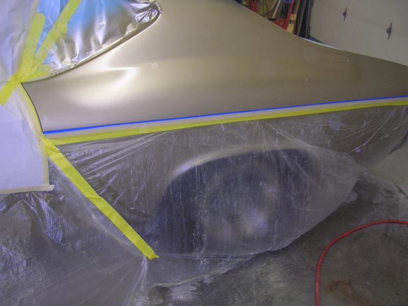

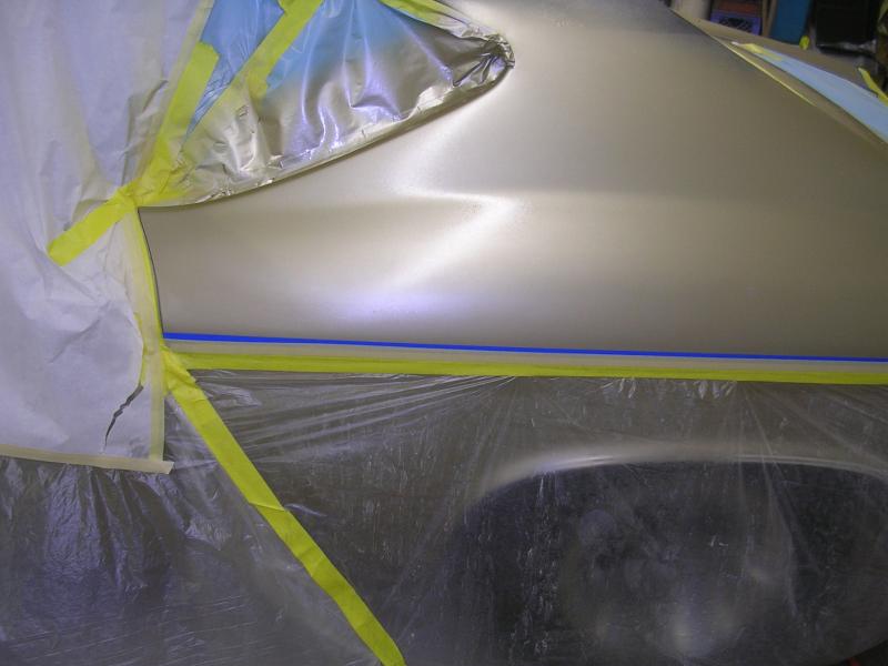

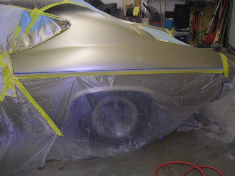

Now from these shots with the clear you can see how i tried to stay away from the stripe,the front and rear of the panels, and away from the decklid on the tops of the 1/4 panels....very tedious stuff let me tell ya !! This color is very difficult.....In fact the mix we have is not a perfect match by any means but the way it's blended makes it presentable and thats what we're after here. Absolute perfection would be too respray the whole car and thats not going to happen.

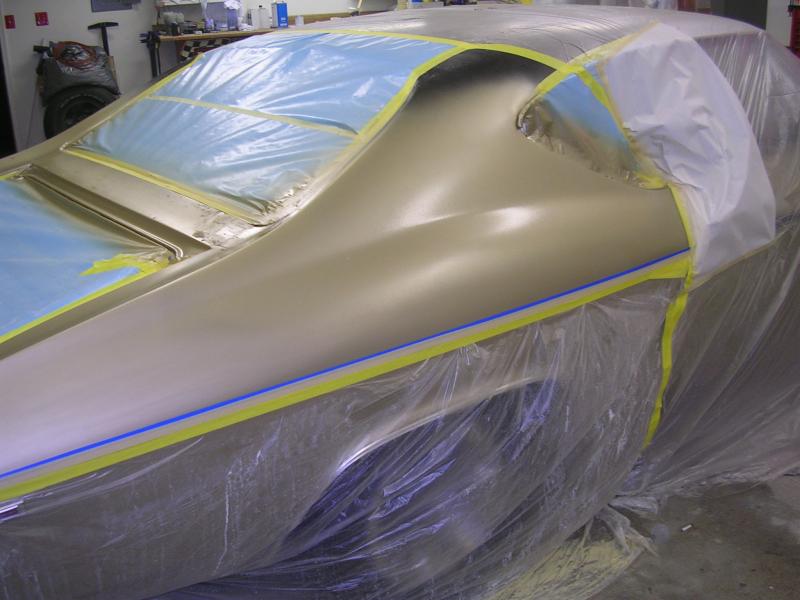

  #19
Old 10-08-2011, 06:57 PM
Looks very nice ,love to see work in progress pics like you have posted .Thanks for taking us along for the ride and send more pics.
  #20
Old 10-08-2011, 07:54 PM
Join Date: Sep 2011
Posts: 35

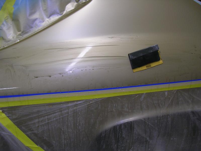

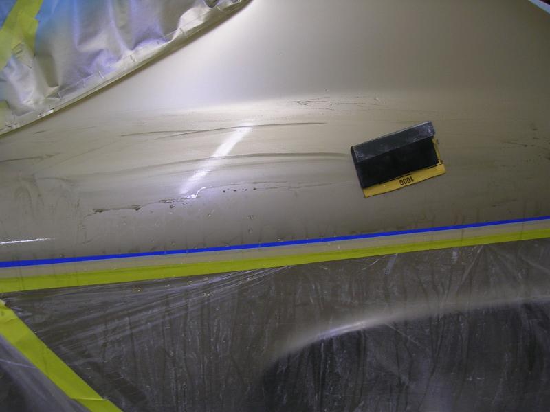

Thanks John,had too take a break for a nap.My eyes started gettin' real heavy there !!

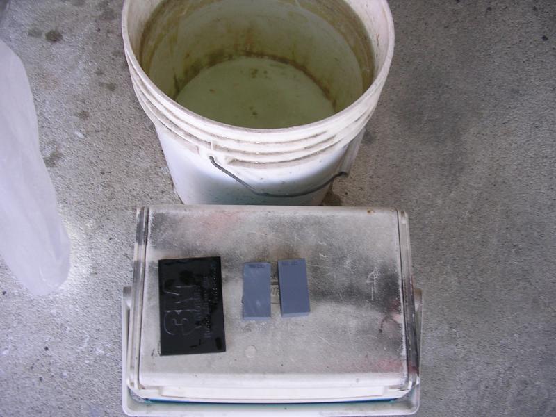

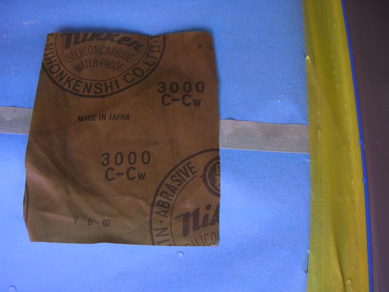

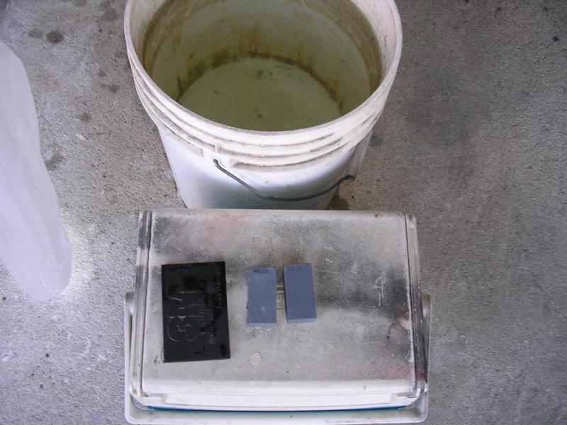

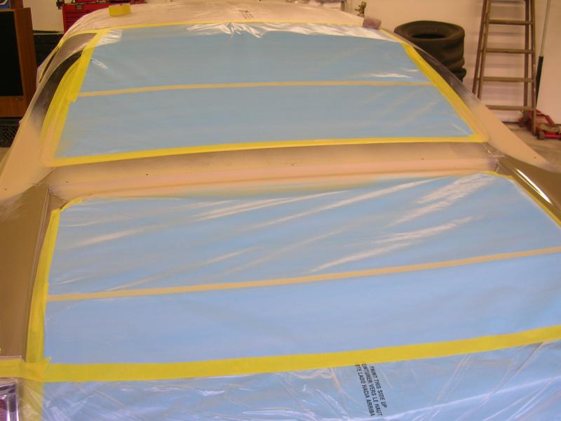

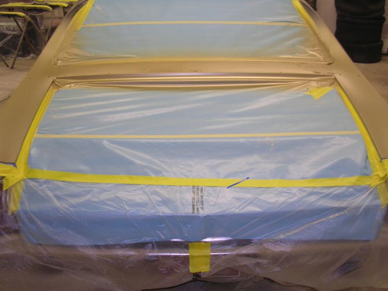

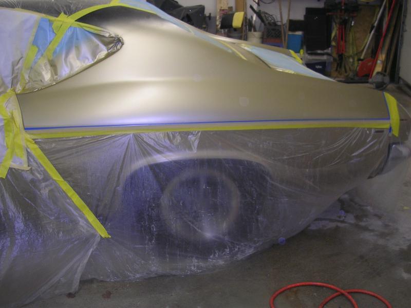

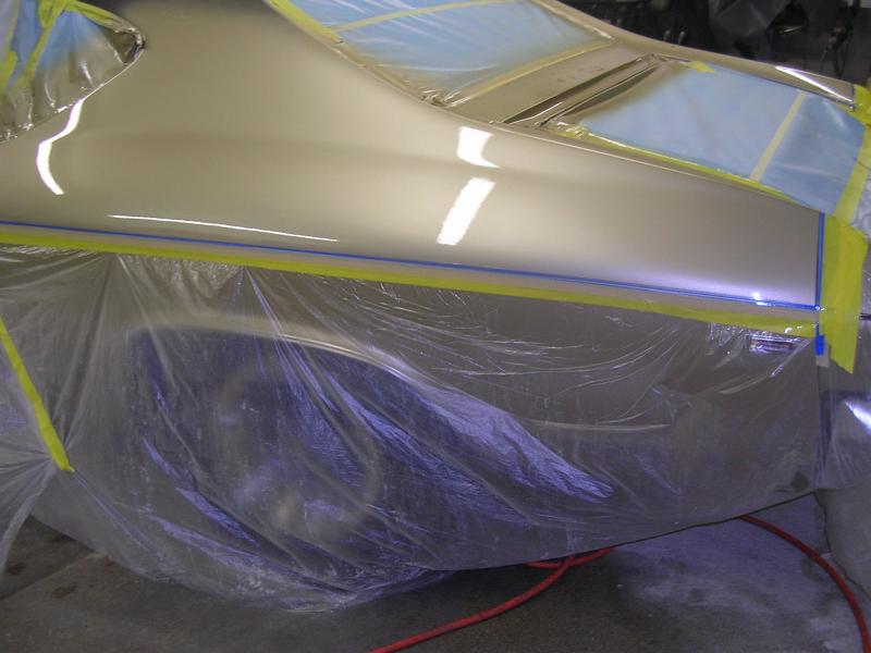

So I sprayed the car last nite and today I wetsanded the minor dirt nubs in the clear with a 2000 grit block thats available from Meguires...Now I do "just the nibs cause I want to leave the "orange peel".if I sand flat it wont match the rest of the car. After this I sand all the clear with 3000 grit under a foam pad and then polish with a machine.
