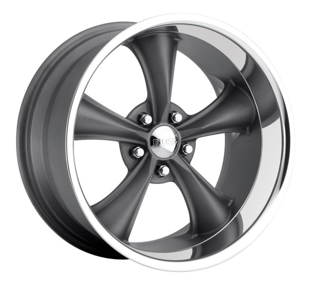

heres a pic of the new wheels on the way already....17's up front and 18's in the back.....took me about a month to decide what size wheels and tires to go with...
