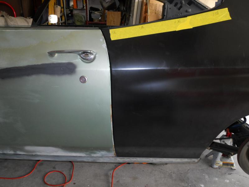

Posts: 446

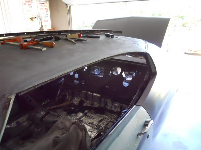

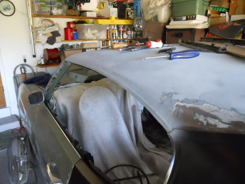

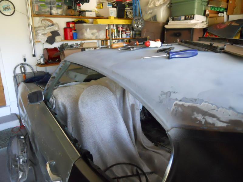

Decided to shave the drip rails.
Needs a bit more work yet but i sprayed some primer to get a better look.

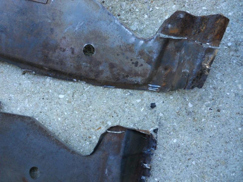

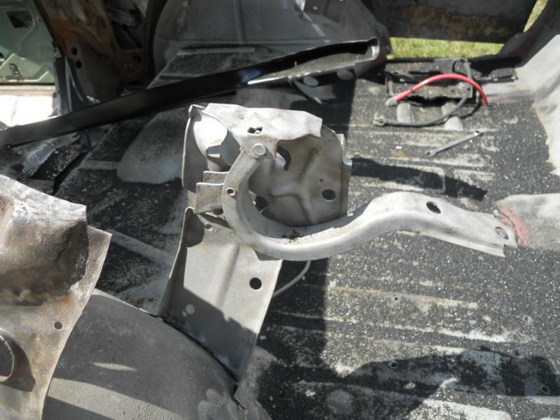

  #12

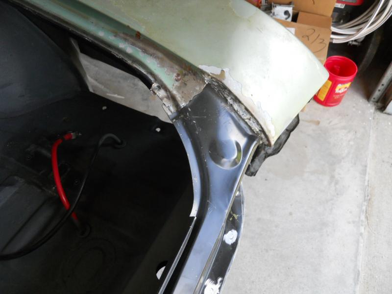

Old 02-19-2015, 09:47 AM

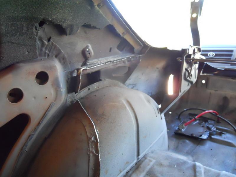

Posts: 446

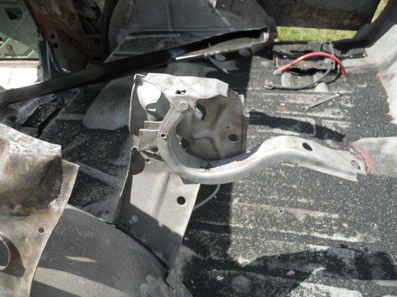

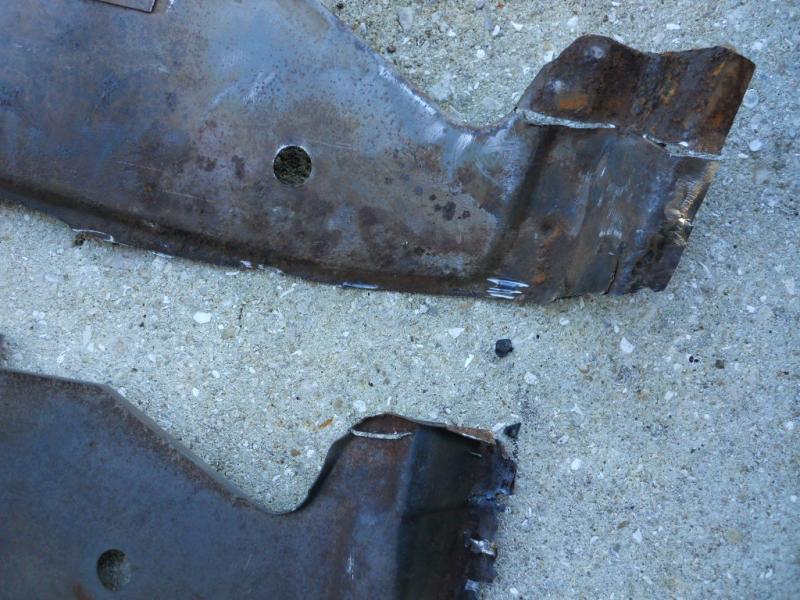

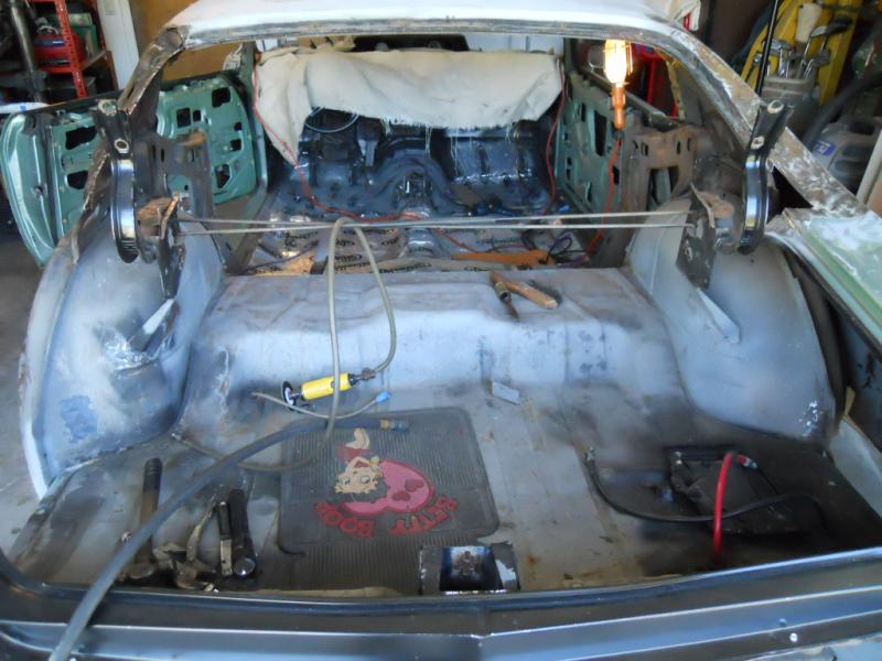

My package tray repair panel showed up...yippe.
So time to cut out the old one and say goodbye to the rust and pinholes.
Came out real easy...A little clean up and test fit is in order.
Or just leave it out and have the only 70 that sleeps two with a matress in the back...lol.
ID:	3466   Click image for larger version
ID:	3467   Click image for larger version
ID:	3468   Click image for larger version
ID:	3469   Click image for larger version
  #13
Old 02-19-2015, 11:44 AM
Originally Posted by mestorod70 View Post
Have the only 70 that sleeps two with a matress in the back...lol.
Dusters had that. Package tray was there but the rear seat folded down and made a nice bed area
  #14
Old 02-27-2015, 10:32 AM
Posts: 446

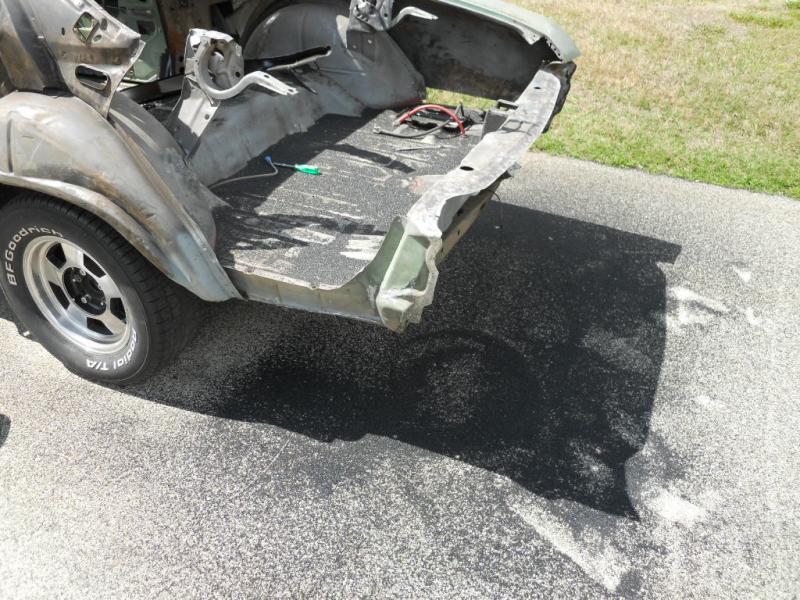

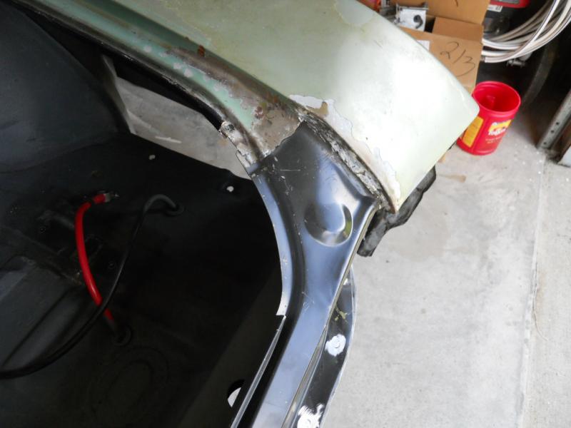

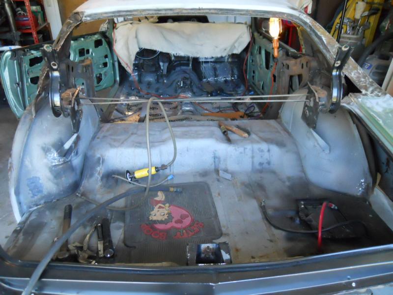

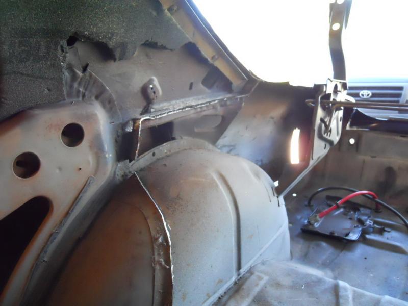

Package tray repair panel was a real PITA to get in.
Took me two hours for the test fit...but looks like it will work.
Taking it out was another story...decided to remove the left part of the tray
and out in two parts.
Right quarter patch is cut and fitted.
Also got outer wheel housings delivered...just useing the rear part of them.
pics to follow.

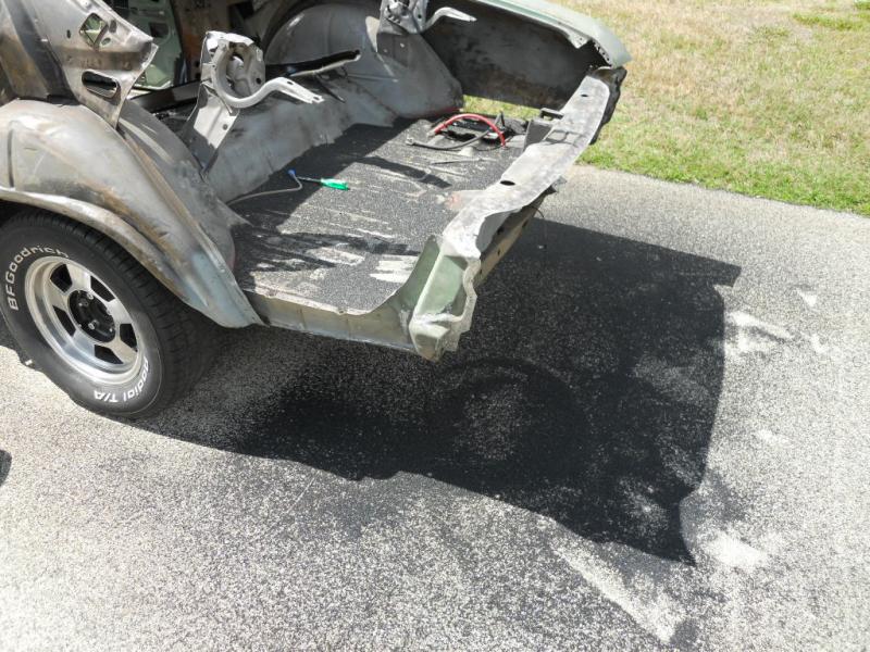

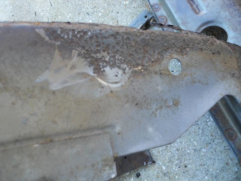

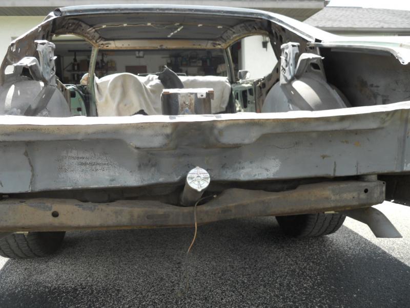

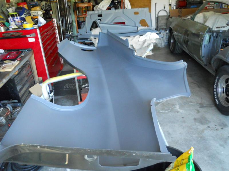

Old 03-04-2015, 10:21 AM
Posts: 446

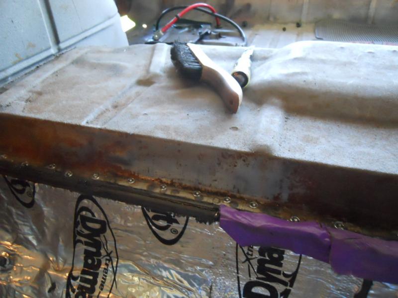

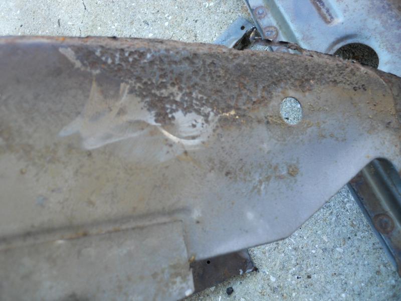

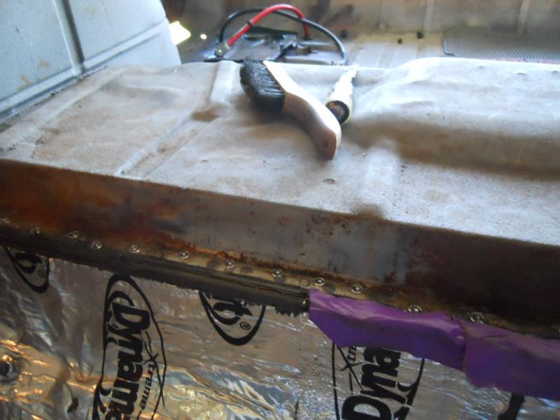

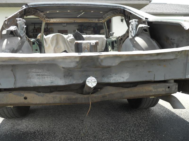

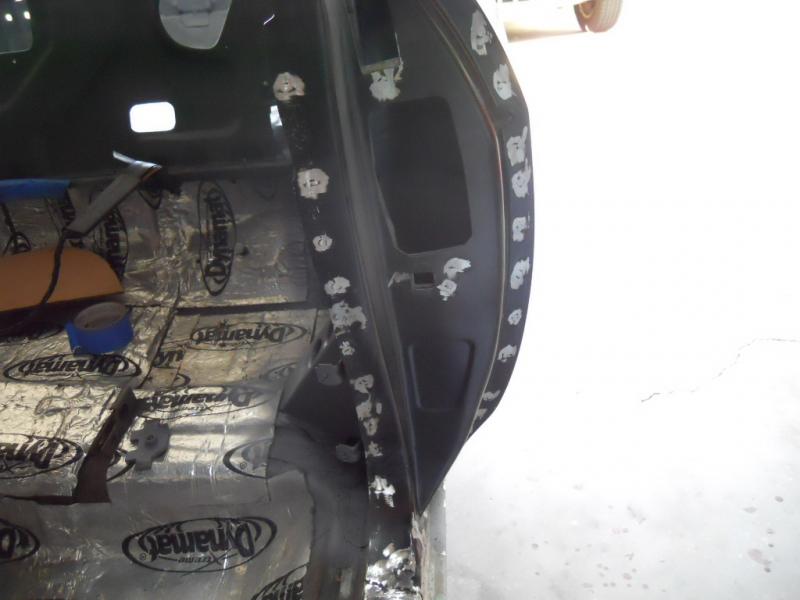

Did a little blasting in the driveway useing black diamond from tractor supply
A little messy but clean up with the shop vac was easy.
Got rid of some surface rust and the rust on the hinges.
Also the rear panel down to primer...that saved some sanding.
Next up is some epoxy primer on the inside of the replacement metal.

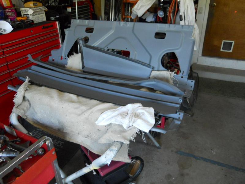

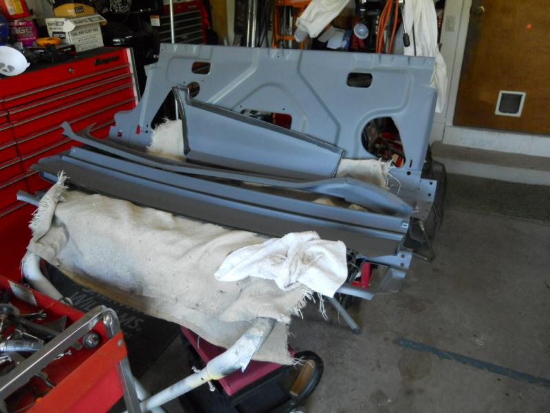

Old 03-12-2015, 10:53 AM
Posts: 446

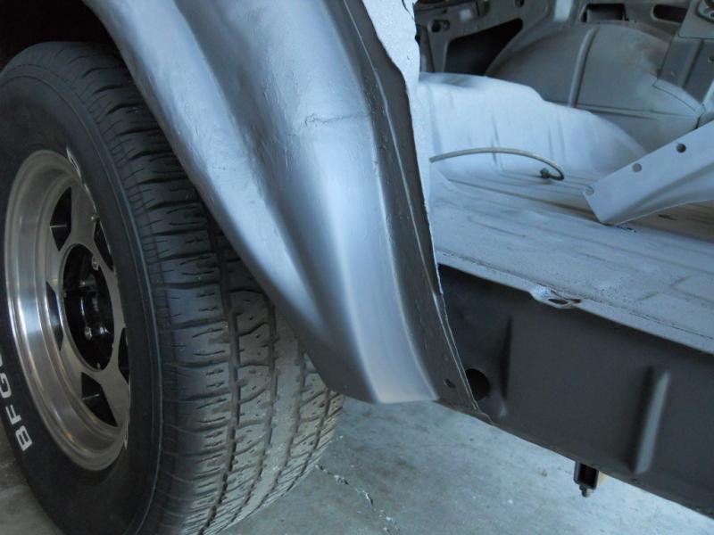

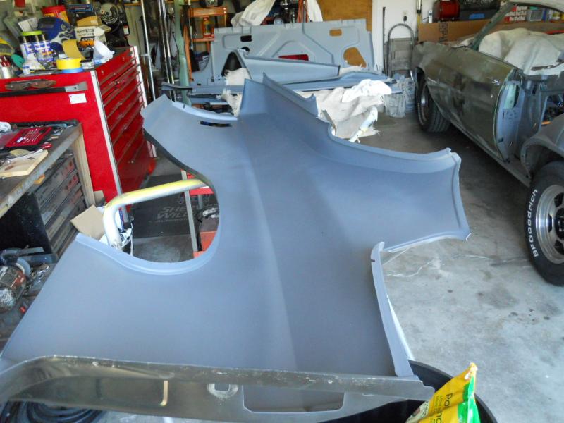

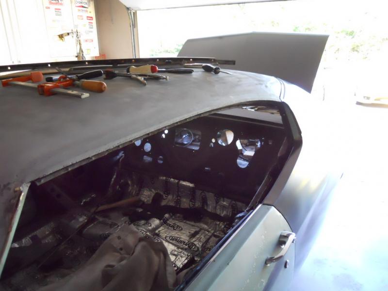

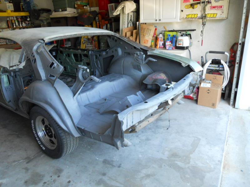

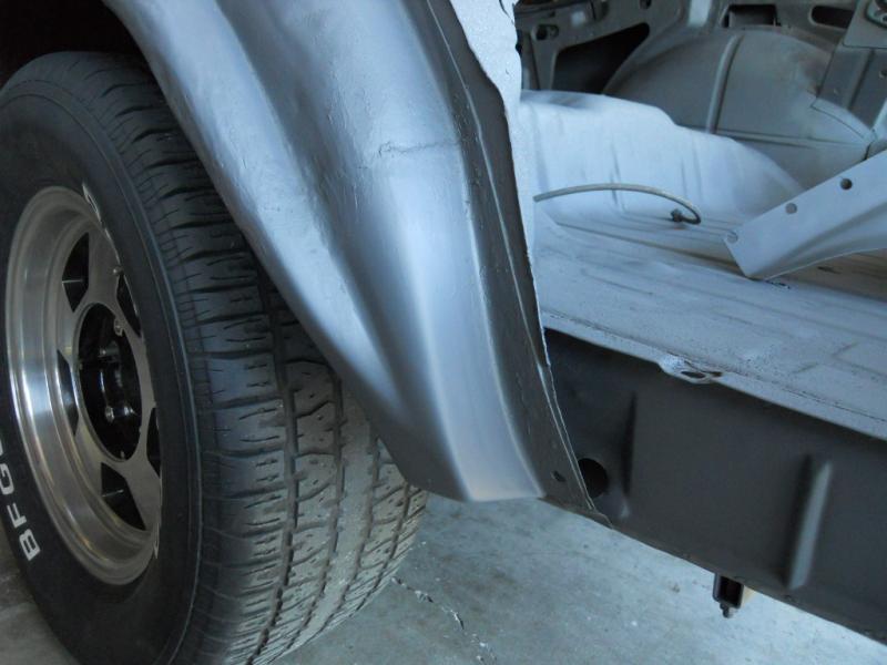

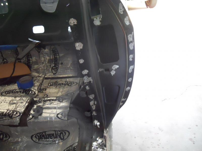

Fixed both my outer wheel housings at the rear..new metal.
Replacement panels scuff sanded with 220 grit and epoxy primed
Also shot the trunk and inner quarters.
Im starting to like the devilbiss finish line gun i picked up.
Next is punching a billion holes for plug welding....lucky me.

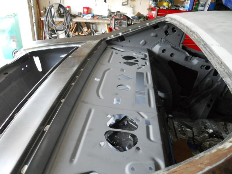

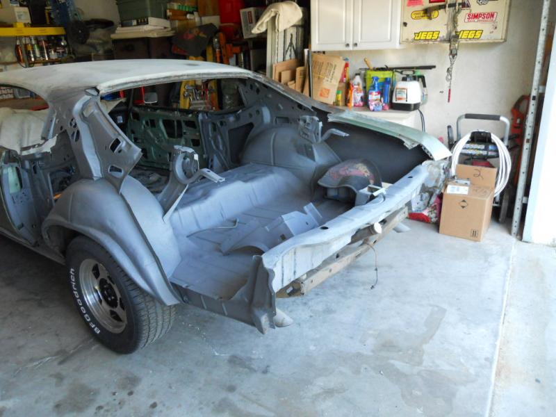

Old 03-23-2015, 06:17 PM
Posts: 446

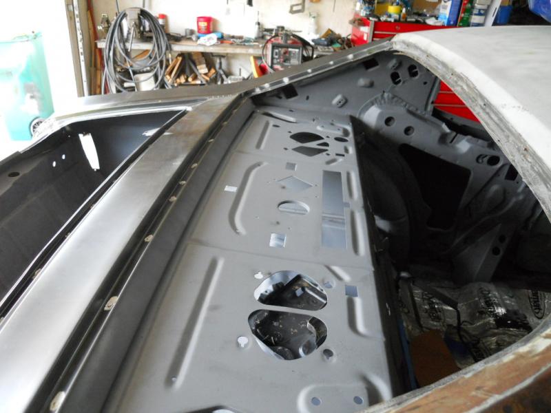

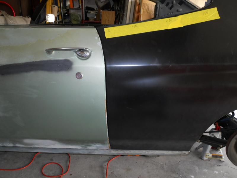

Lots of welding done...things line up quite well
a bit more and some spot putty and seam sealer will make it look fine
