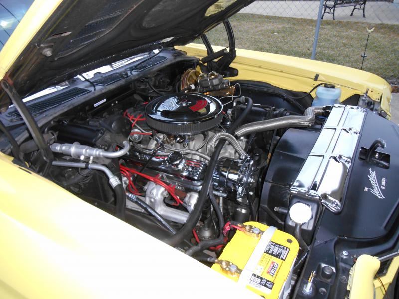

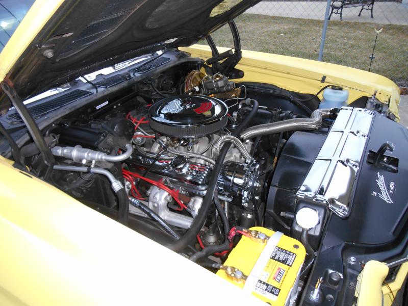

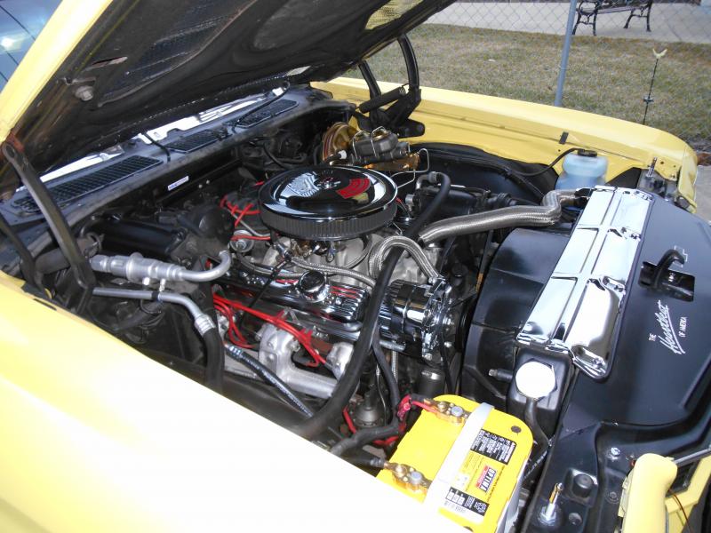

I finally received the new radiator. I noticed the filler neck is installed on the top and concerned me that it might interfere with the hood. My current rad. is at a 45 degree angle. Dewitt's tells me the top mount was standard and they have had no complaints with other Chevelle owners and that the filler neck at a 45 degree angle started with 73 Chevelle's. That I know is not true. Whether or not I have a problem with it fitting I won't know until I check.
  #17
Old 05-14-2015, 05:31 PM
I have no interference issues with my car.
