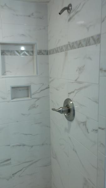

Tony, the side of the toilet is about 12" from the vanity. Mounted the holder right onto the side of the vanity.
Hank, that niche in the shower is in between the wall studs. Judy uses it for shampoo bottles and soap dish. The floor pan is made out of fiberglass, sitting on a sand & mortar base. Shower doors are heavy duty 5/16" glass. All the fixtures are done in brushed nickel. Floor is 12"x12" tiled.

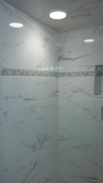

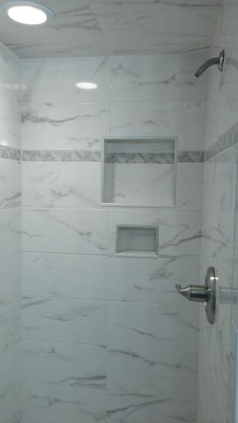

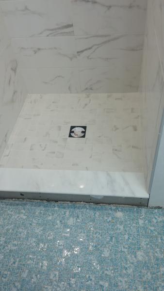

So it's been a low priority, slow job but the shower is done. Ripped up the tile floor in the bathroom today. Not fun hauling all that crap from the 2nd floor to the 1st floor then down to the family room then outside.

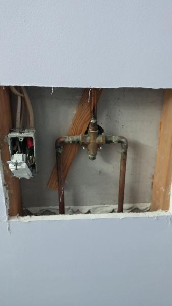

Backside of shower. Some dumb ass, I won't mention any names but his initials are "Hank", didn't think things through. The sheetrock, metal lathe, mortar and tile removed were a lot thicker than the cement board, thin set mortar and tile that replaced it. That left the faucet sticking out too far for the trim kit to fit. Had to open the wall and block the valve assembly to pull it in.
To be continued...

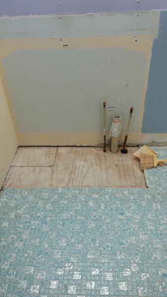

This is, obviously where the vanity goes. We found a vanity and counter top Lynda wants. Old vanity was 48" with center doors and drawers on each side. New vanity is basically a 30" cabinet with 2 doors on the left and an 18" cabinet with 4 drawers on the right. A quartz counter top with sink offset to left over the 30: cabinet. Sounds great, except. Except drain pipe comes up right where the 2 cabinets join and cold water inside the 18" cabinet. That won't work so I have to cut out sub-floor and move the plumbing to the left under the new sink.
I may have to cut out the sub-floor and replace the toilet flange too. It sits 1.5" above the sub-floor. The new cement board and tile will be around 3/4" so the flange may sit too high. I'll have to drag out the toilet and measure the bottom drain flange and see.

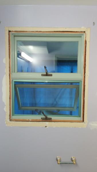

Removed trim around the window so I could measure the rough opening. Only window in the house that I haven't replaced. Figured I better do it now. That's it for now

Shower looks real nice Hank. You do good work.
The closet flange should sit on top of the tile.

Thanks guys. I know the flange should be on top of the tile. Just worried it may be too high above the tile. The new floor won't be as high as the old one.
