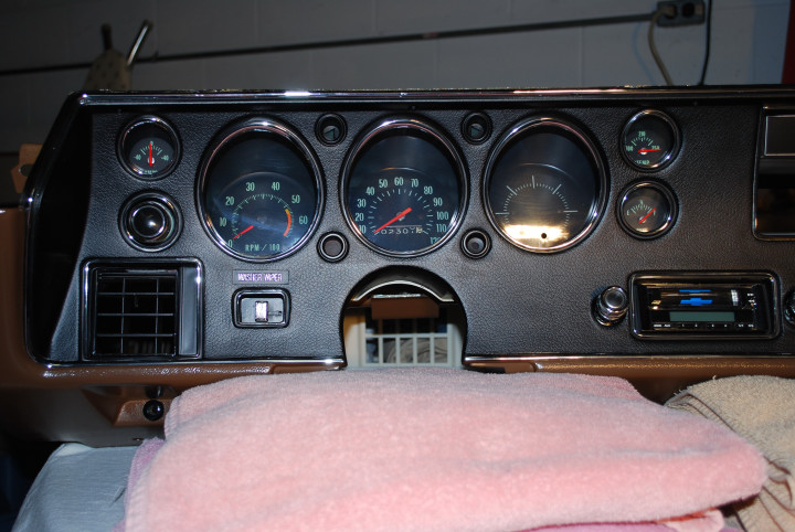

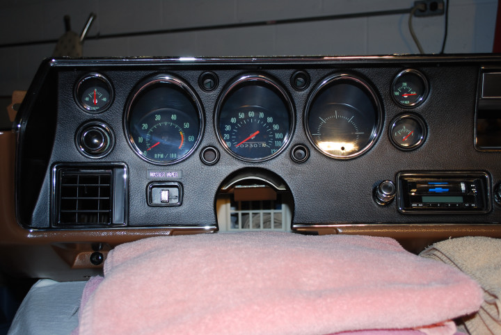

It's a bit of a challenge in a few areas. Right now I'm trying to get the radio to fit properly. I don't think it's the dash though, had the same issue with the original dash. It's a Ken Harrison cassette radio that's supposed to fit these dashes. The face slides through the dash so there is no movement up or down once it's in. The volume knob post is not centered in the hole in the dash, too high, the tuning post is centered. The fader and balance knobs sit down in the holes, at least they're supposed to. Because the post isn't centered the knob won't fit down in the opening.

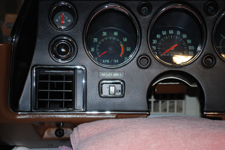

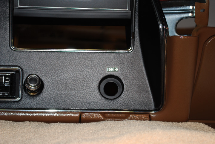

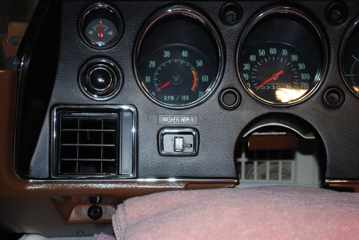

Loosened the volume post and faceplate on the radio to try and get better alignment of the post in the hole. Still no go. The hole in the face of the dash tapers, get's smaller deeper in. The fader and balance knobs were just too big around at the base so I cut off the back edge and got them installed. Here are some better pics of the lettering after removing the paint.

Very nice, The lettering came out great. I will be working on mine this weekend. Gauges look good in it.

It came out beautiful. I'm considering trying that on ours.

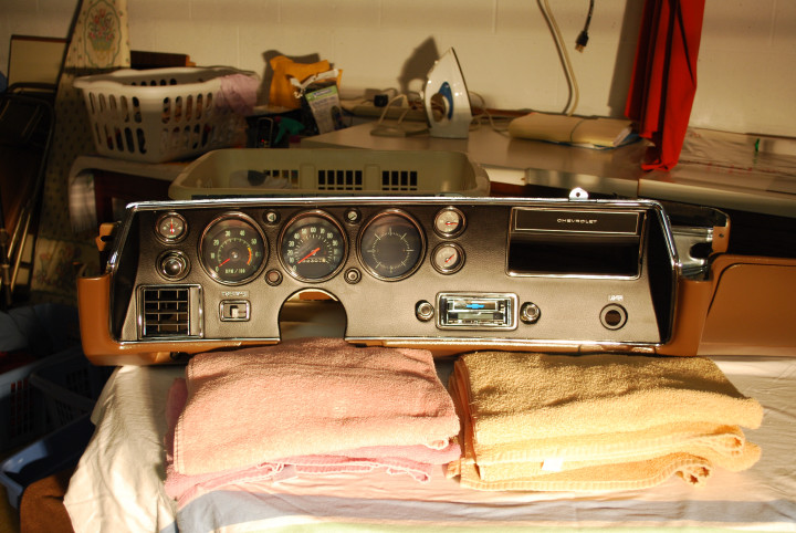

Looks great. How do you find the time with all that laundry you have to do .

I was thinking the same thing, it's really nice that Lynda lets him put his dash on top of all the laundry...or he will be in trouble if she sees this picture? It also looks like he just got done ironing but did not put it away yet.
Hank,
It looks great, I can't wait to have you help me on my interior when I redo it...I'll let you do the seats as I know how much fun you had on yours....again the dash looks great and I can't wait to see it.
