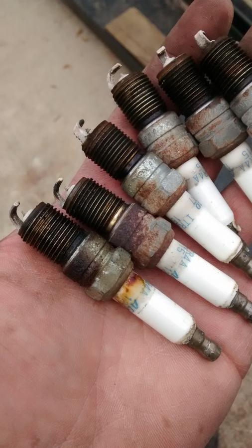

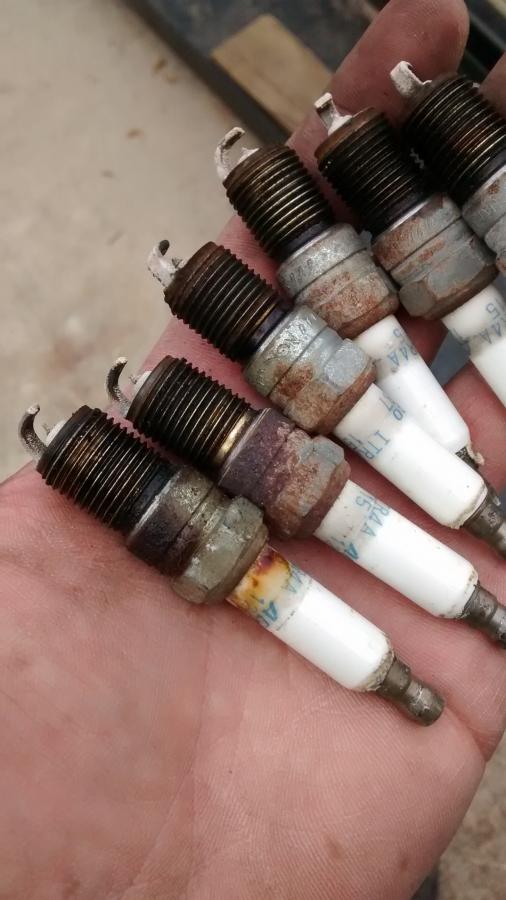

I gave the GAGT a tune up Tuesday... coil, wires, plugs, and air filter. It had developed a miss at idle in damp weather. And idled a hair rough in any weather. The original parts were toast, and the air box/filter were full of dirt and rocks. It definitely runs much smoother. Amazing that it averaged 25.5 MPG and got 27.5 a few times.

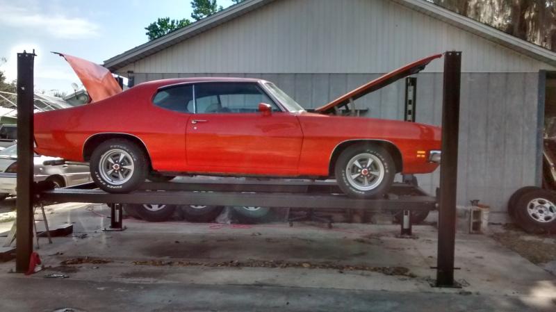

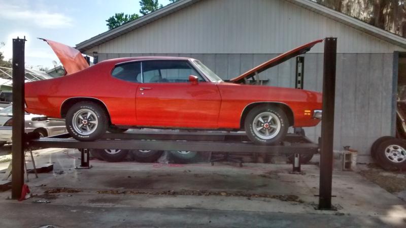

Day off, not really... worked on the LeMans. It starts better, the proper choke rod will do that. I think I have the lack of brakes narrowed down to a bad master cylinder. Also found that the distributor cap was loose. Lastly, removed the 3.07:1 geared 12 bolt rear and installed a 3.55:1 rear. It's getting closer, I just need the time to work on this stuff.
