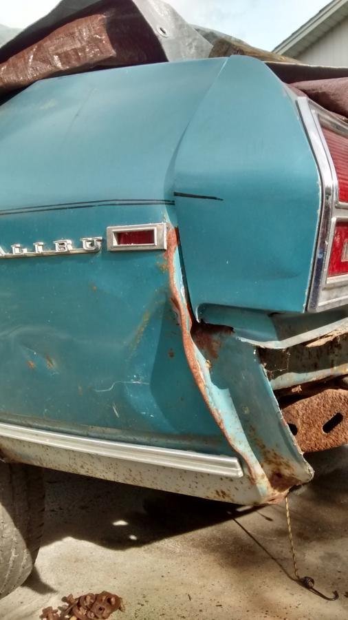

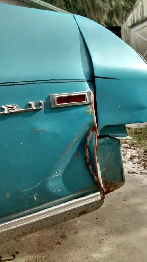

Took the rear bumper off of the 69' Malibu after work today. The car was hit, or backed into something at one point in its life. I needed the bumper out of the way to get at some of the damage. I borrowed a stud gun/dent puller from a friend last week.

Looks like a partial quarter replacement to me. Don't think a dent puller is going to help much, but I'm not a body guy.
  #2694
Old 11-16-2015, 04:17 PM
That's the last resort. (I have the panel if i need it) I am going to try the dent puller, heat - via a torch, and I am currently building a pair of plates that bolt through the inside and outside of where the tail light extension bolts. I will use the winch on the car trailer to try and pull on it from that angle.
Believe it or not... I actually used a similar method to straighten the bed off of my old truck. It was hit low, in the left corner. Crushed, and pushed a bunch of metal upward.
