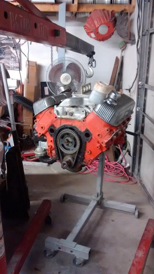

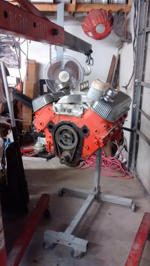

I picked up a 402 and a 69' M20 recently. The engine was running, I took it partially apart to inspect it. All checked out good, and I bought it obviously. It will be a cheap way to get my 69' Malibu running and driving. I am going with the whole day 2/ratty muscle car theme. Should be fun...

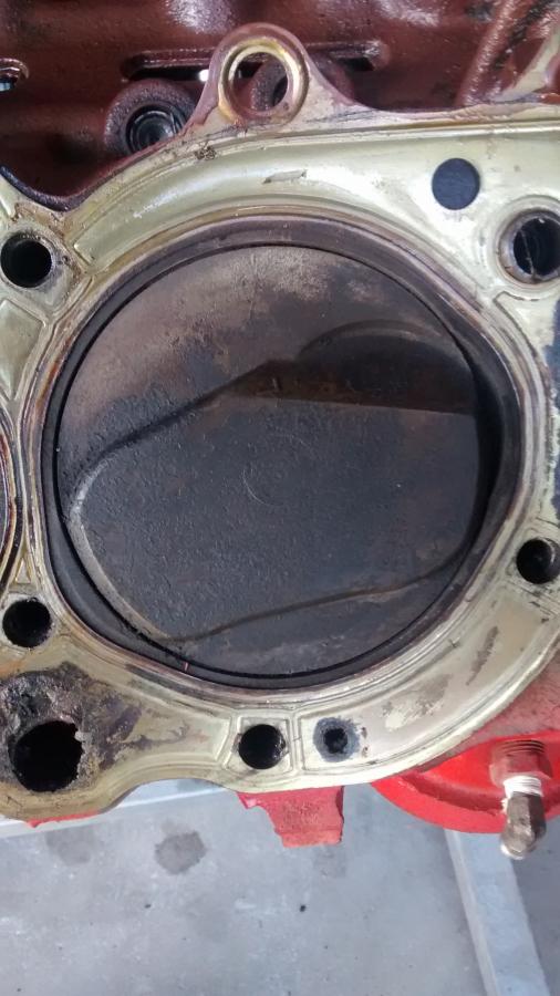

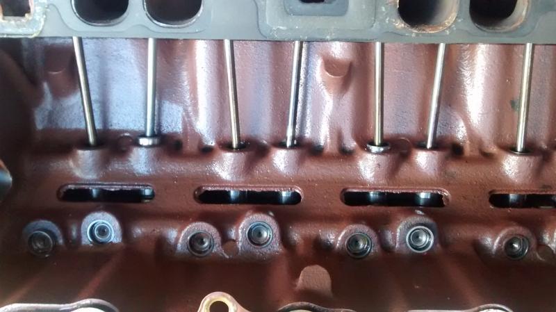

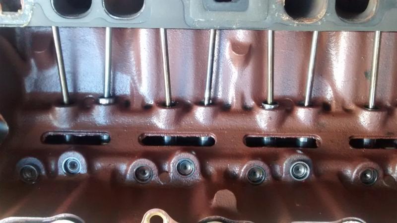

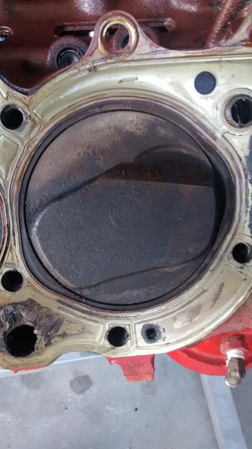

Old 08-22-2016, 06:18 PM
Did some tear down on the 402 last night, wanted to measure a few things. I am going to have to run a cam with a decent amount of overlap to bleed off compression for pump gas. With the closed chamber heads, it comes in at a tick over 10:1 SCR. I think I have it narrowed down to a Lunati "bootlegger" cam. Should have a nasty idle, hope it's fun.
