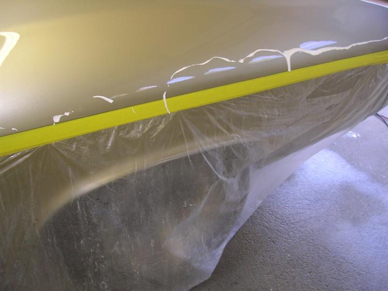

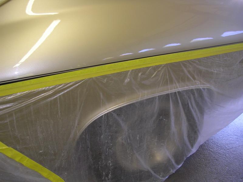

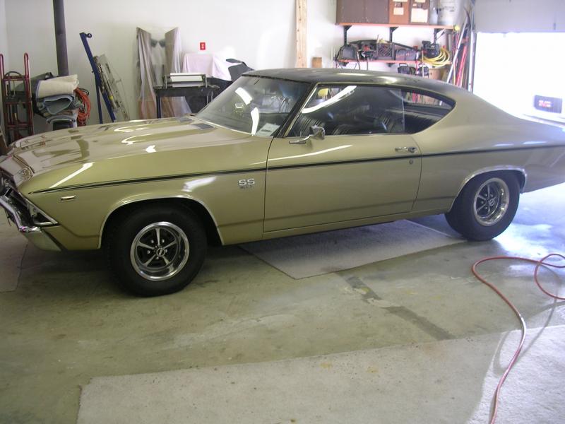

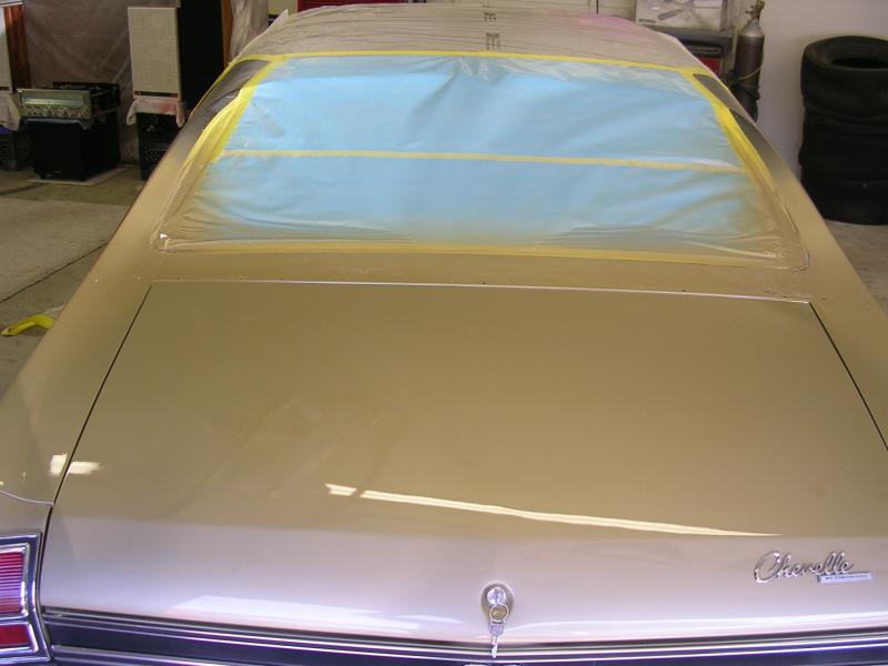

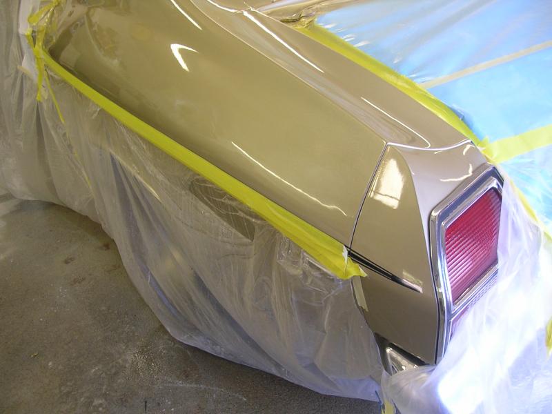

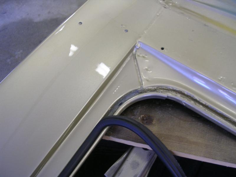

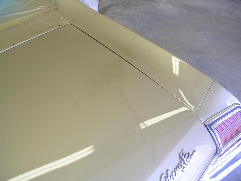

After I've polished everything with hardcut once I have the stripe to deal with before final finishing..When I pull the fineline tape up there is a "sharp" line along it that must be knocked down. So I pull just the fineline and replace it with 1.5 inch and lay it about 1/16 of an inch below the existing tapeline and hardcut this sharp edge off whith the polishing wheel,doing this makes it less noticable that you used the stripe as a border
After that I expose the 1/4 extensions and use a fine compound on all surfaces and then polish by hand.

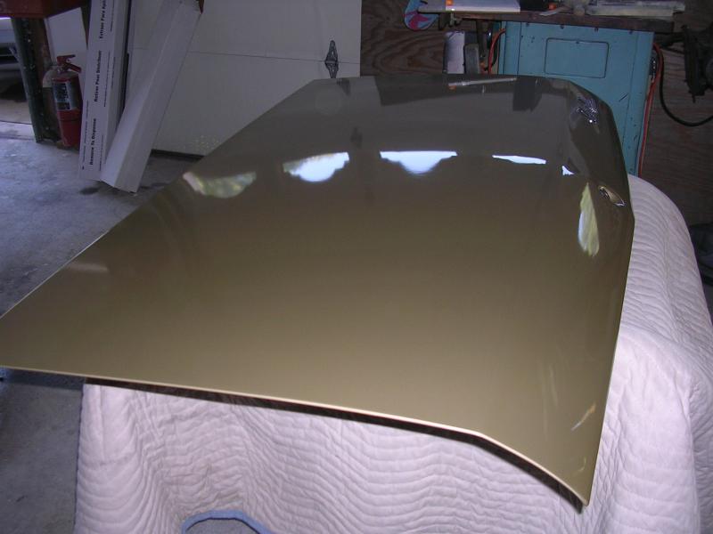

Since I didn't paint the decklid I hardcut that with compound and final finished it also so it would hopefully shine as nice as the top[s of the rear !/4 panels and it did turn out well......

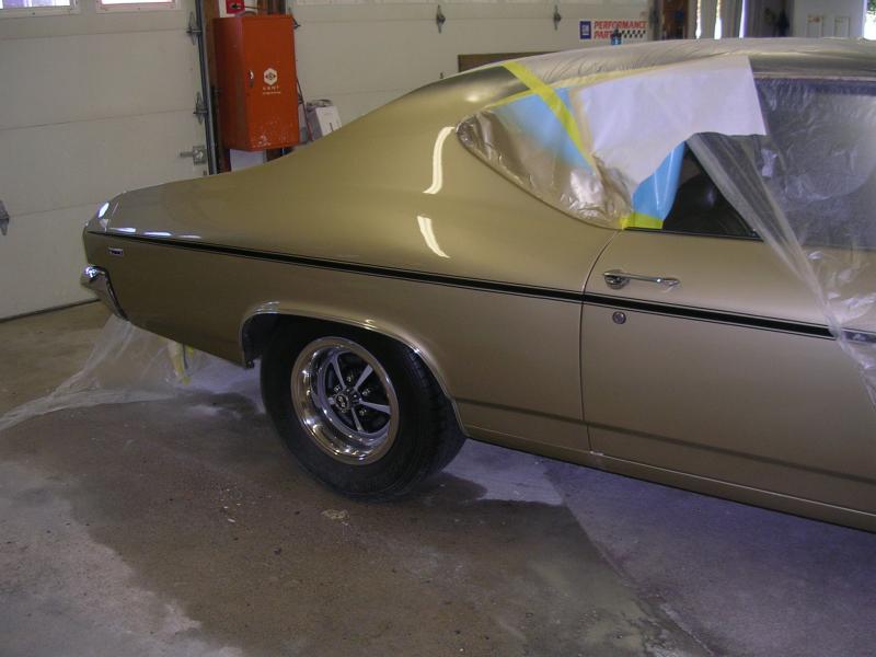

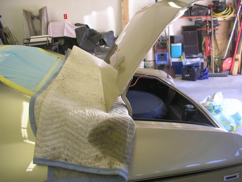

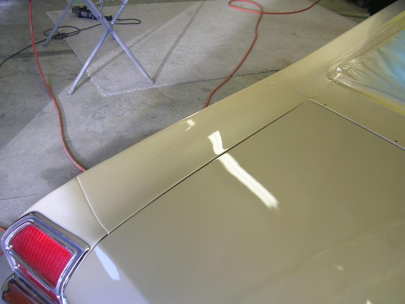

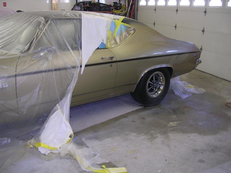

First couple pics,semi finished product...Then I took a shot of the difference in the color even after the black added,at certain angles it looks perfect at others, not so. But blended looks good.
This is how you hang a decklid with only one person

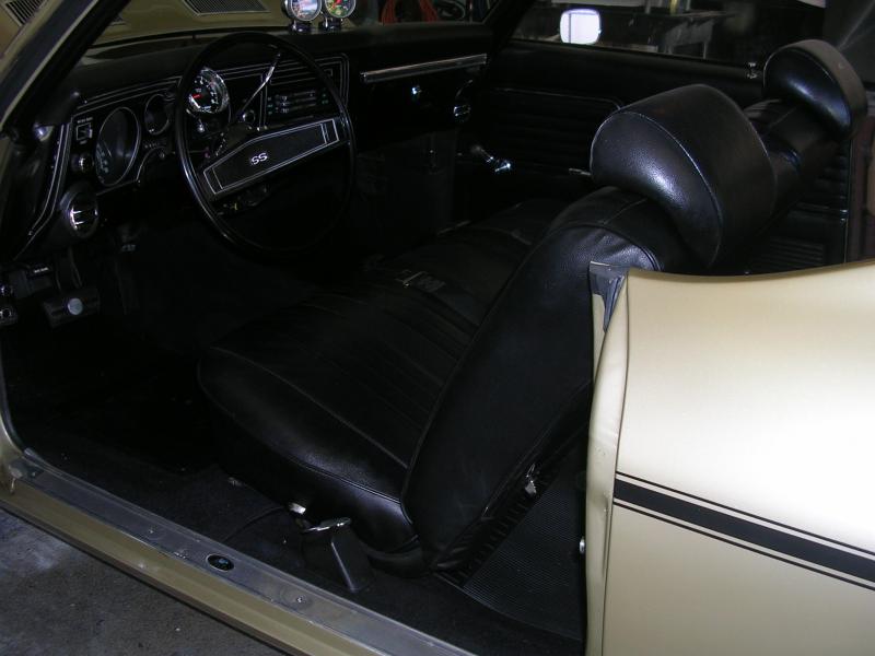

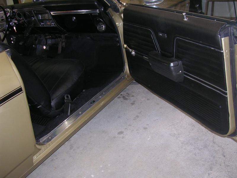

Couple pics of some interior............

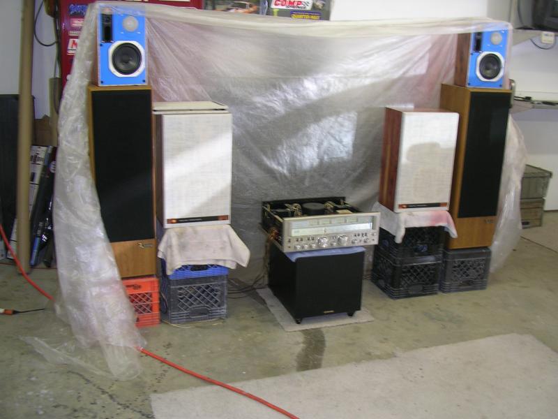

And this is the setup keeping me entertained during the whole Fiasco.My Garage ROCKS lemme tell ya !!!
And that would be rap folks,somewhat time consuming but when the Vinyl top is on this it's going to look like a million bucks !! When that part of the job is done I will get some pics of that also and post them up too finish this thread off
