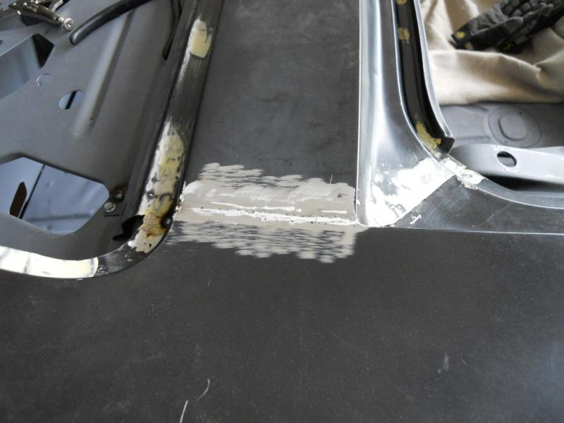

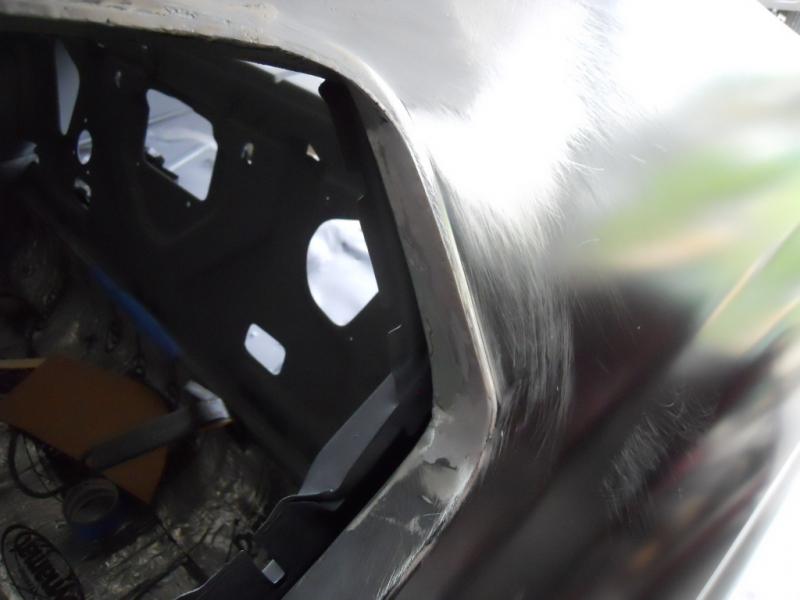

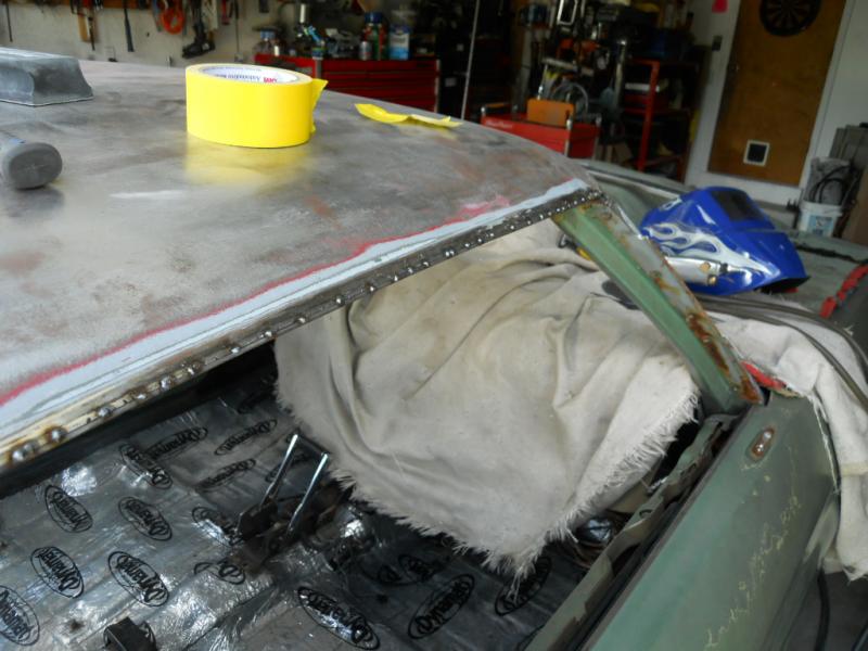

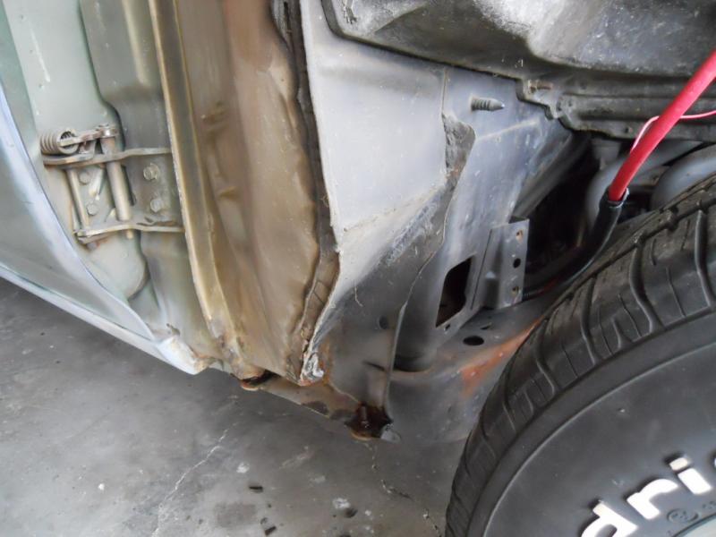

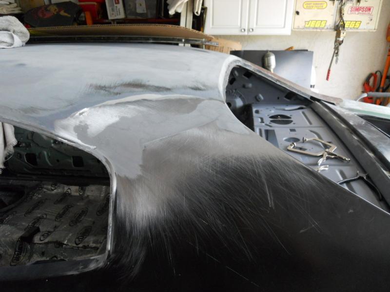

little more done today.
SMC metal filler on the roof to quarter gap after welding
ruffed in with 36 grit then some 80.
welded the filler panel to the quarter...(frowned upon by the purists)
And continued my quest for the shaved drip rail look.

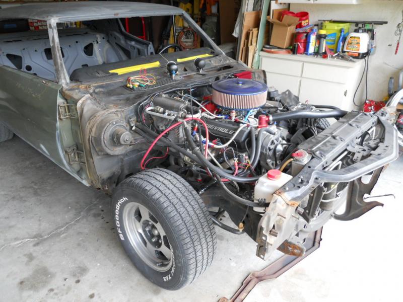

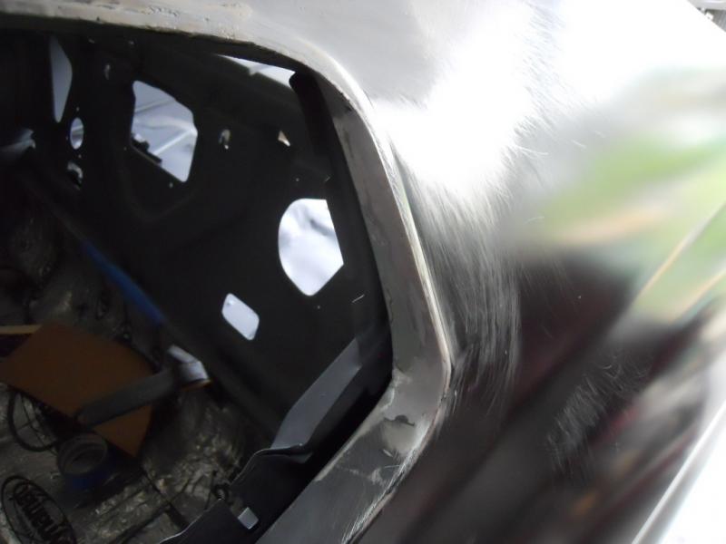

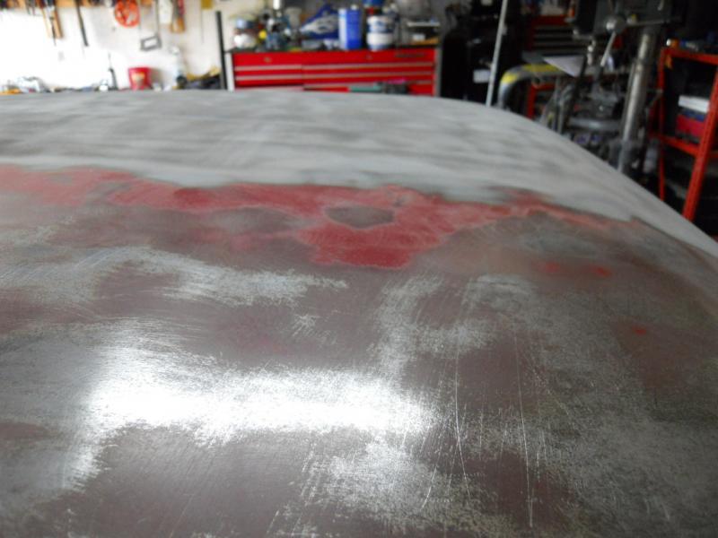

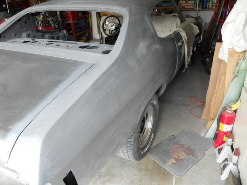

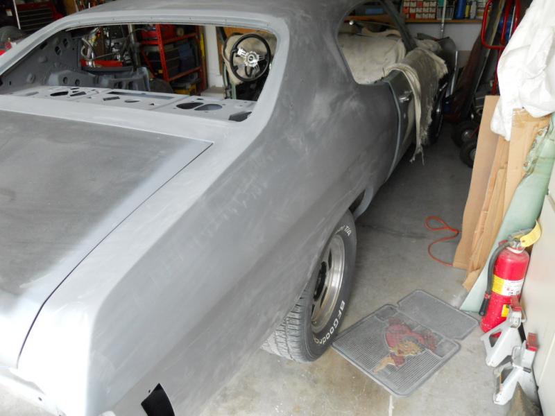

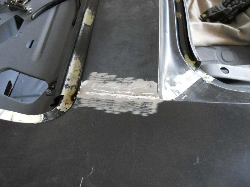

Still going at it.
Most of the major dents are gone.
The roof and right quarter are striped and in epoxy.
The custom drips got a 1/8 metal rod welded on the edge to give em a nice feel

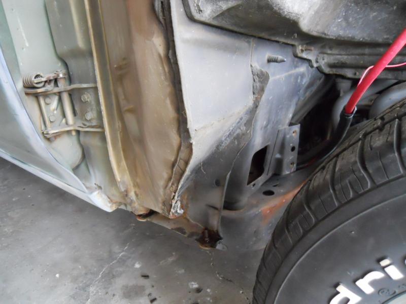

The hood is in the parts showroom (my front living room) and the doors and fenders are off...Found a local media blast place that will take em down to bare metal.
The lower cowel is rust free on the outside but inside i dont know yet.
Anyway a few more pics
