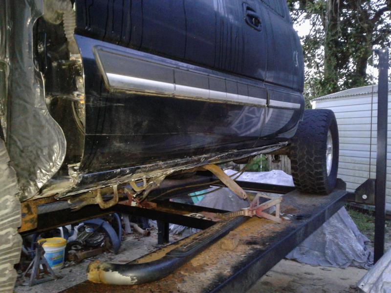

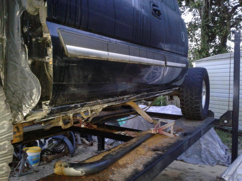

Got the outer rocker tacked in on the GMC today, the heat & humidity was horrible. I never want to do this again, huge PITA. plus it is keeping me from working on my cars.

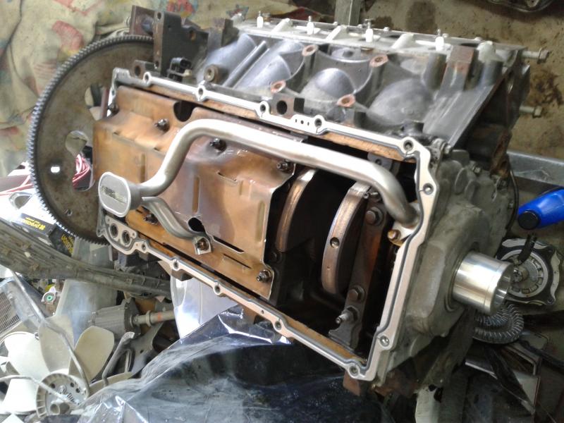

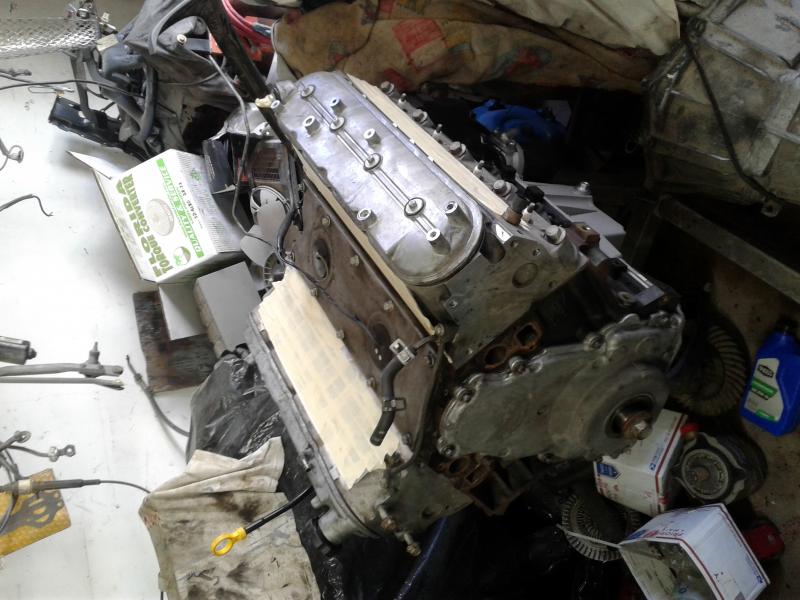

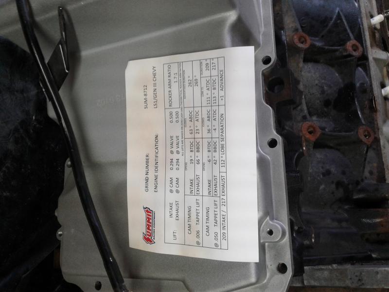

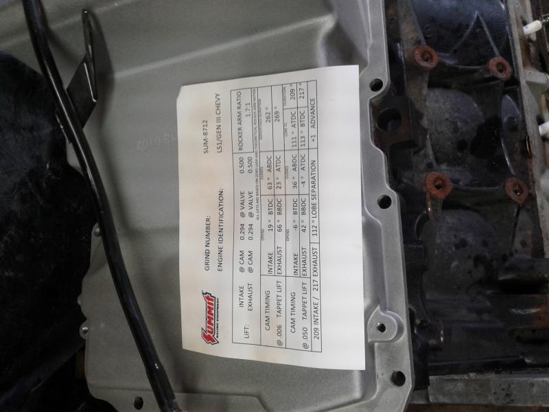

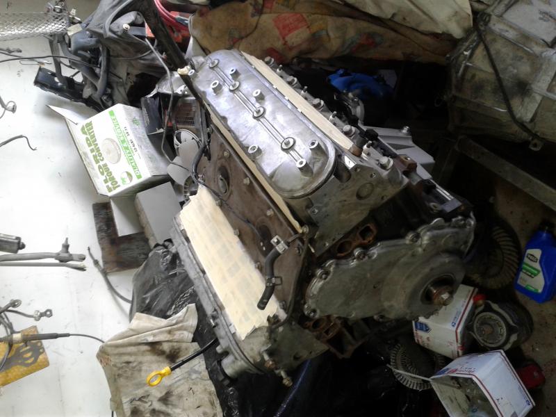

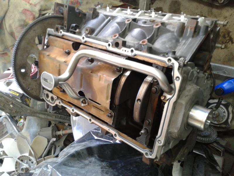

I finished putting the 5.3L together for my fathers 63 Chevy II convertible. Cam change, and an F Body oil pan swap, along with new gaskets. I put a very mild "truck" cam in it that requires no valve spring or pushrod upgrade. It will run great in that light car.
