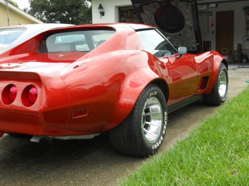

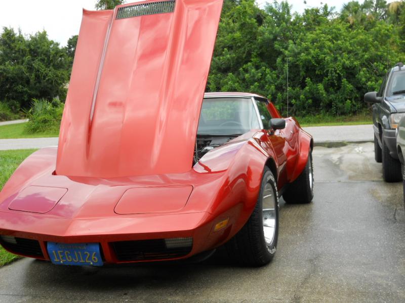

Default before i sold my vette
Built this in 2006
just sold it
