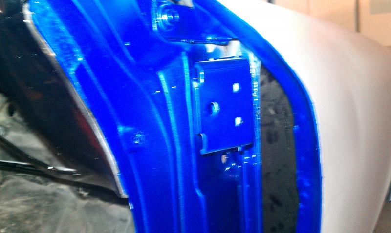

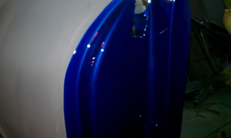

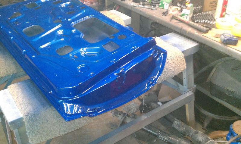

Best laid plans of mice and men go astray. Equipment delay so I had a chance to spray the jamb. Now I off to work on mom's house.

WOW ,that looks good .

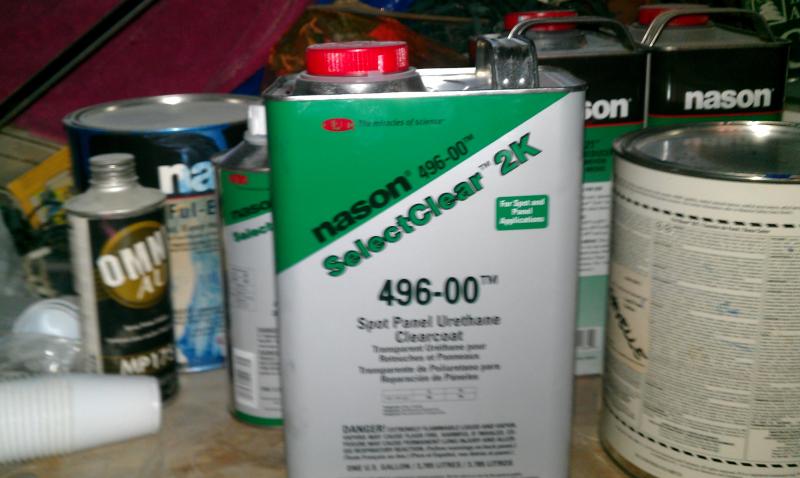

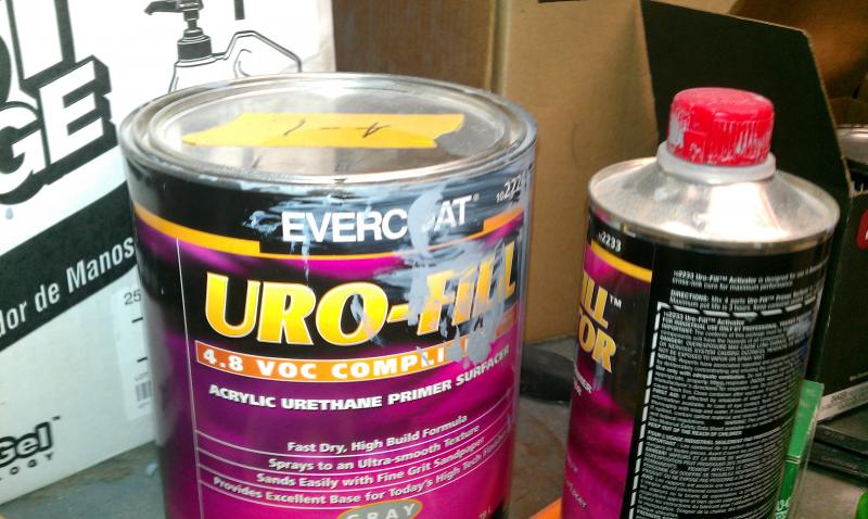

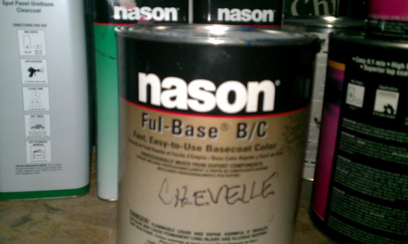

May I ask what brand paint are you using.
And is the clear 2.1 or the 3.5 waterborne.
also what hybuild primer do you use.
Thanks in advance.
  #64
Old 05-07-2014, 07:27 PM
Thanks in advance.
Nason is the paint name. Here is what I am using.
First to metal everything. Rust converter on everything even good metal.
Then epoxy primer. That is the dark grey under everything.
Hybuild. First yellow during rough bodywork. Grey once the finish bodywork and blocking started.
Base coat.
Clearcoat.
