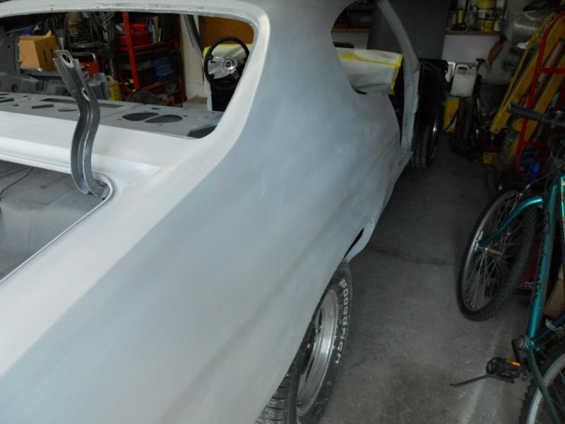

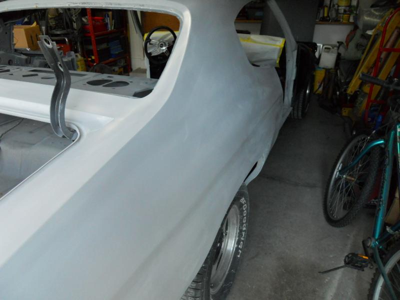

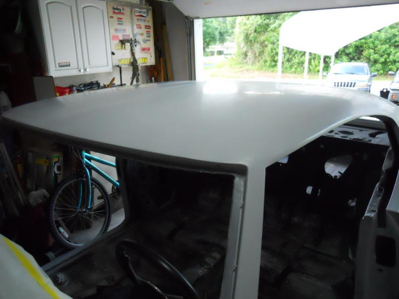

Default im in 500 grit wet

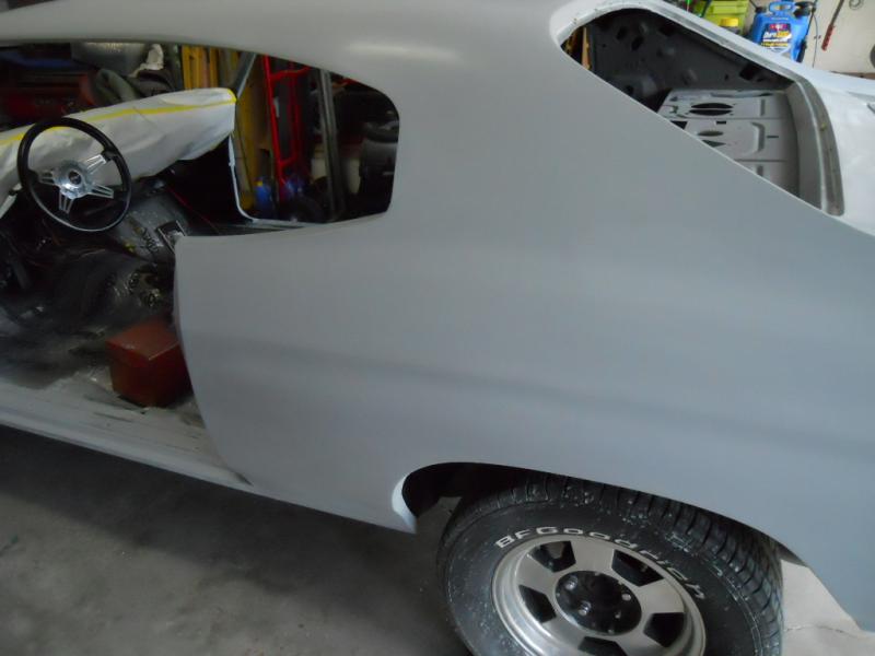

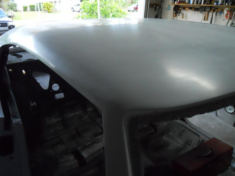

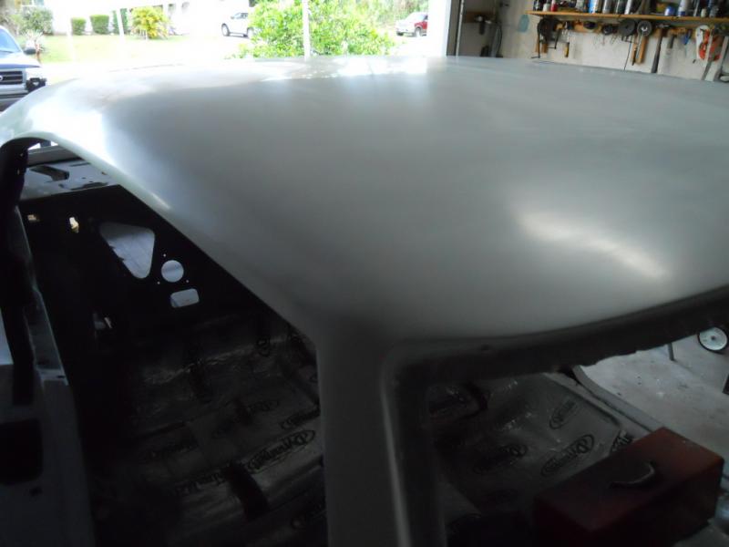

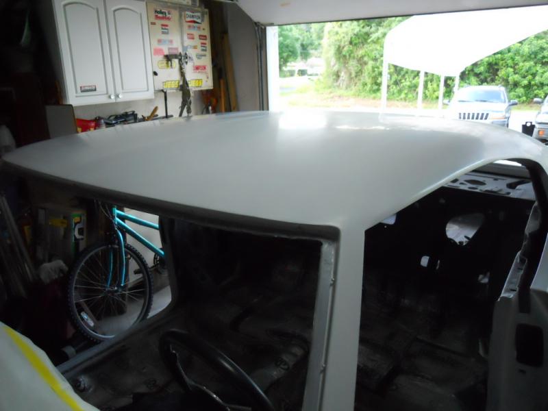

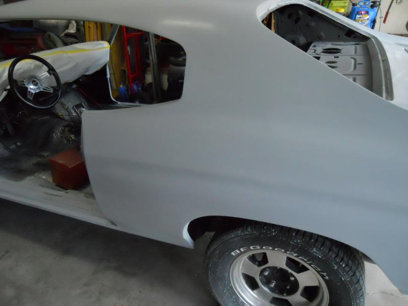

Got the body in 500 grit wet sanded.
found a few pin holes and a couple of boo boos
quick fix and a little more primer.
angio on tues is gona slow me up a tad.
Now to pick a paint color......russo corsa red.

Looking outstanding. Going to really look nice.

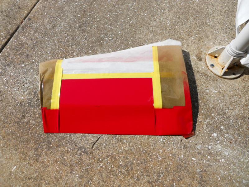

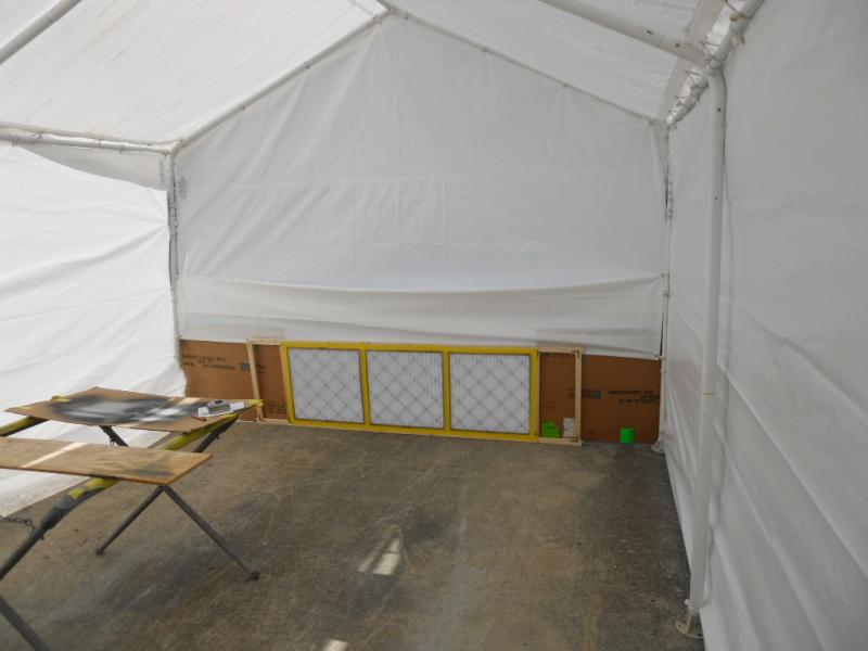

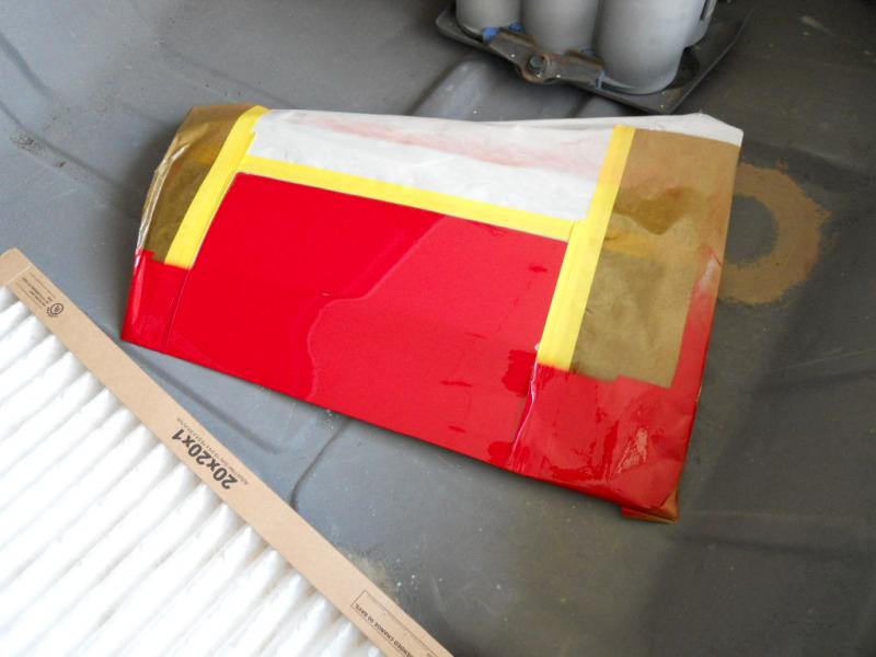

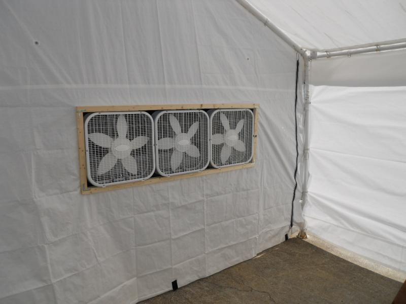

Default paint color and booth

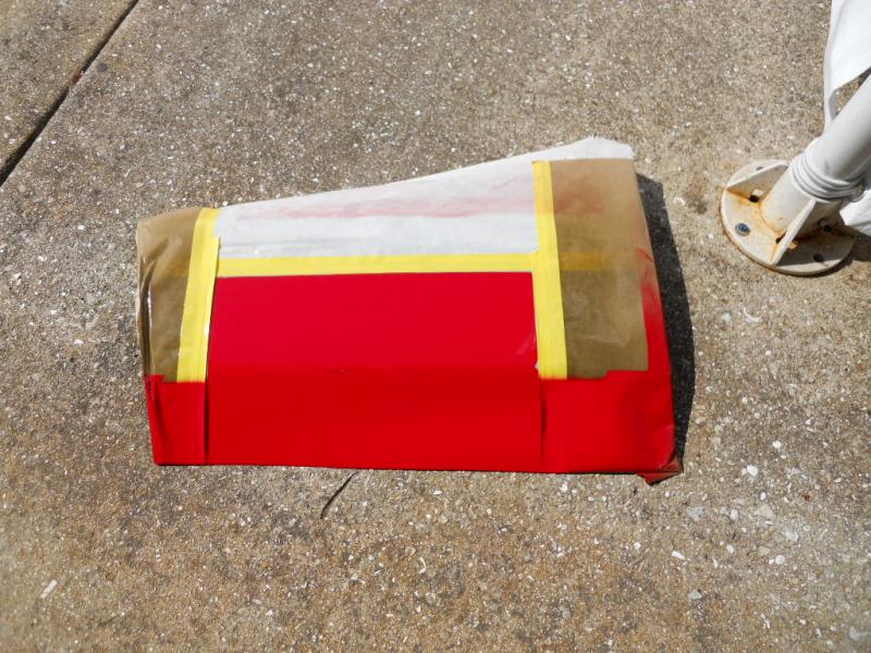

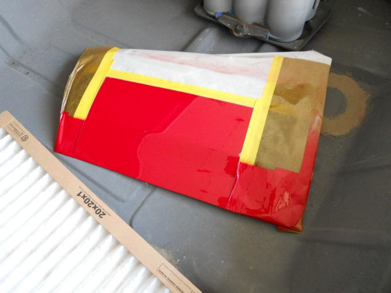

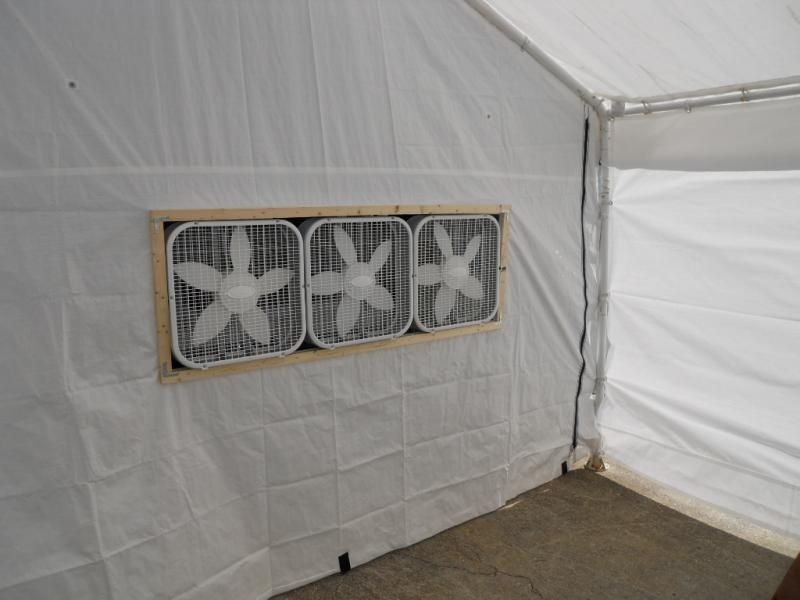

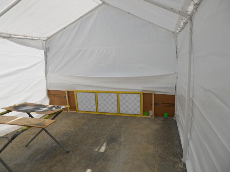

I picked this red for a color
And am still working on my tent booth

I wish i had that booth when I did mine. That is a good looking tool you got there. Nice red gonna look good.

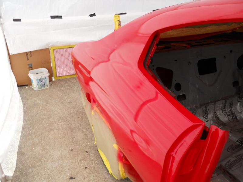

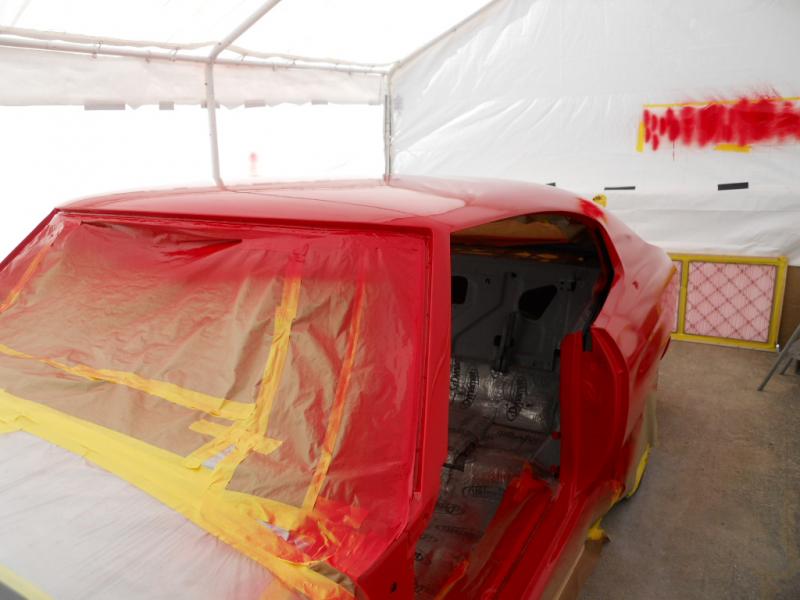

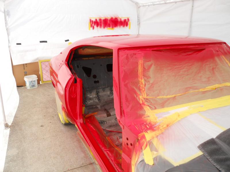

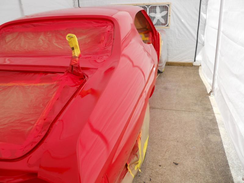

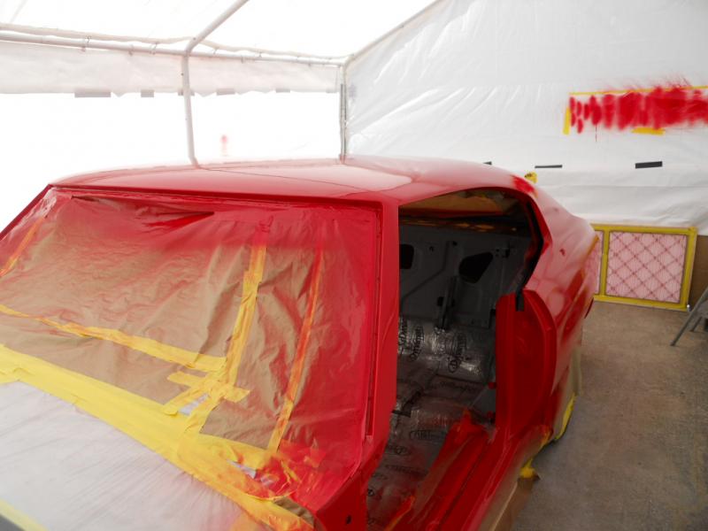

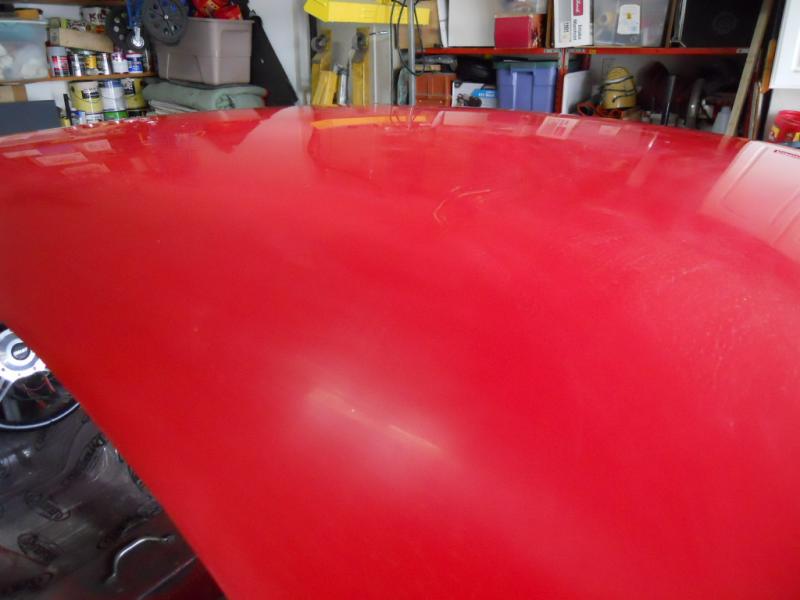

Default its red and painted

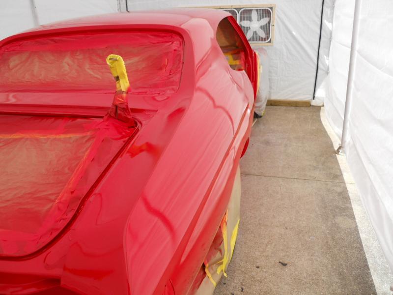

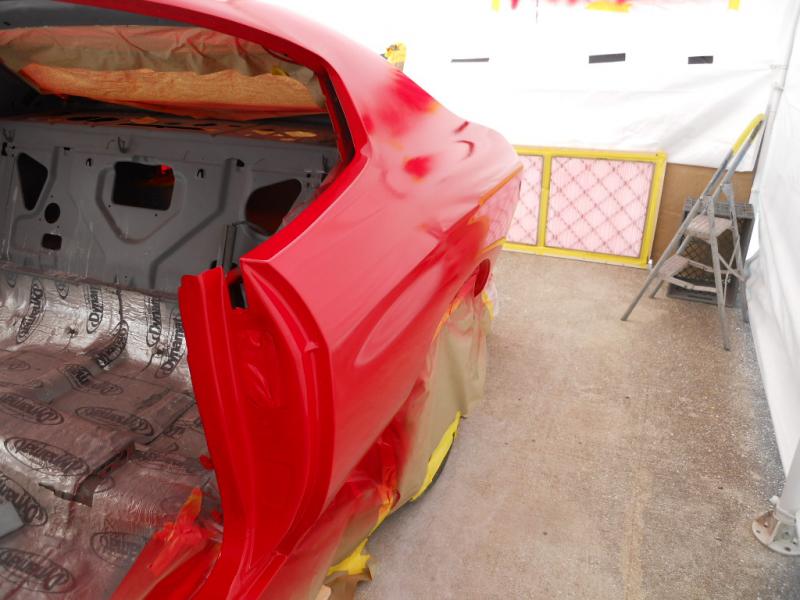

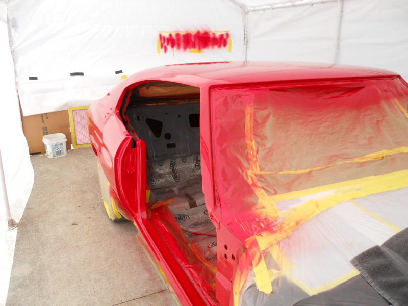

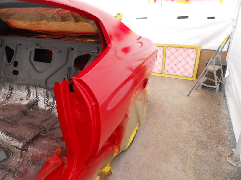

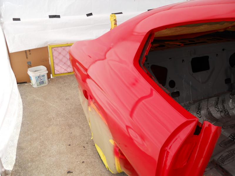

Finally had a break from rain....2 nice days in a row
So got the car in the driveway tent booth thing and shot some paint.
it got 3 coats of base and 3 coats of clear.
There is color sand and buff in my future....lots of it...lol
anyway a few pics.

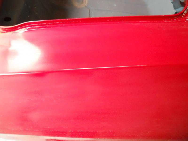

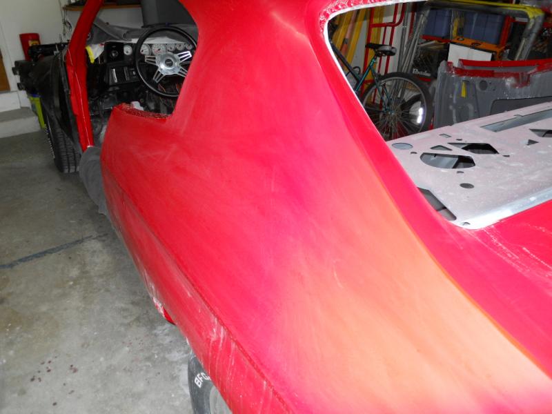

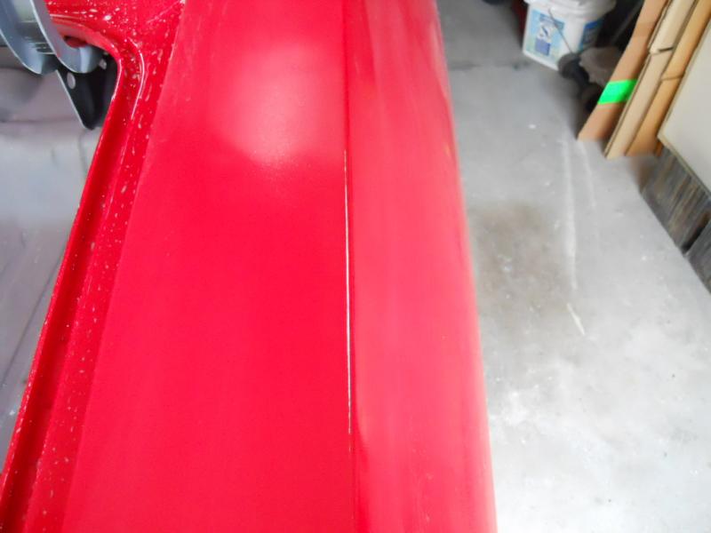

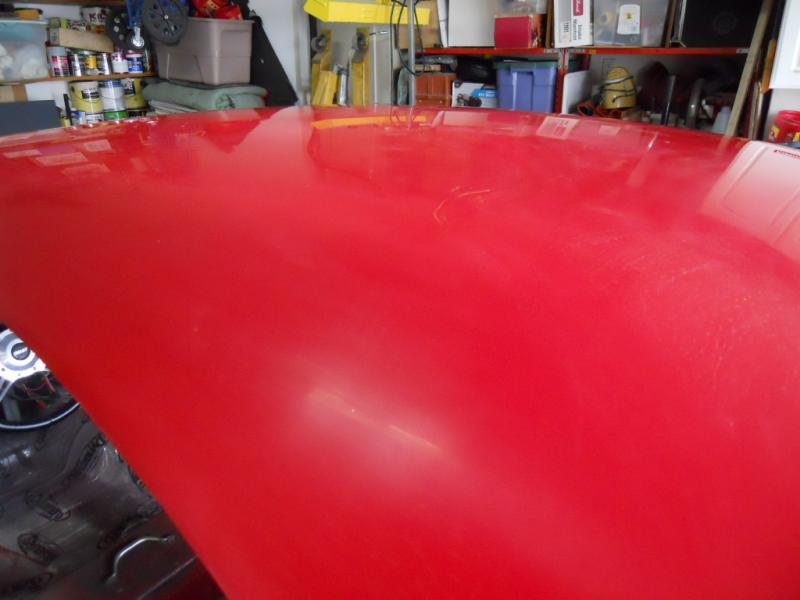

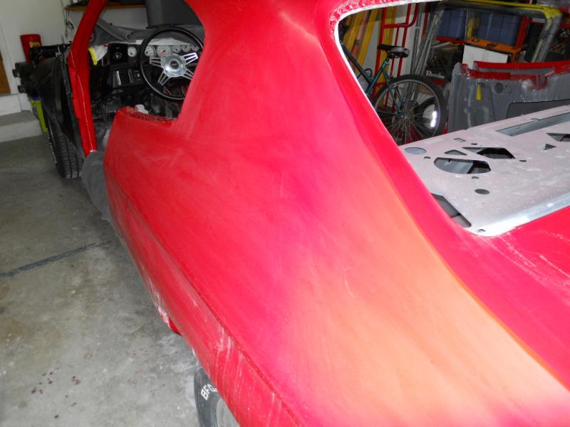

Default Oh crap...big bo bo.

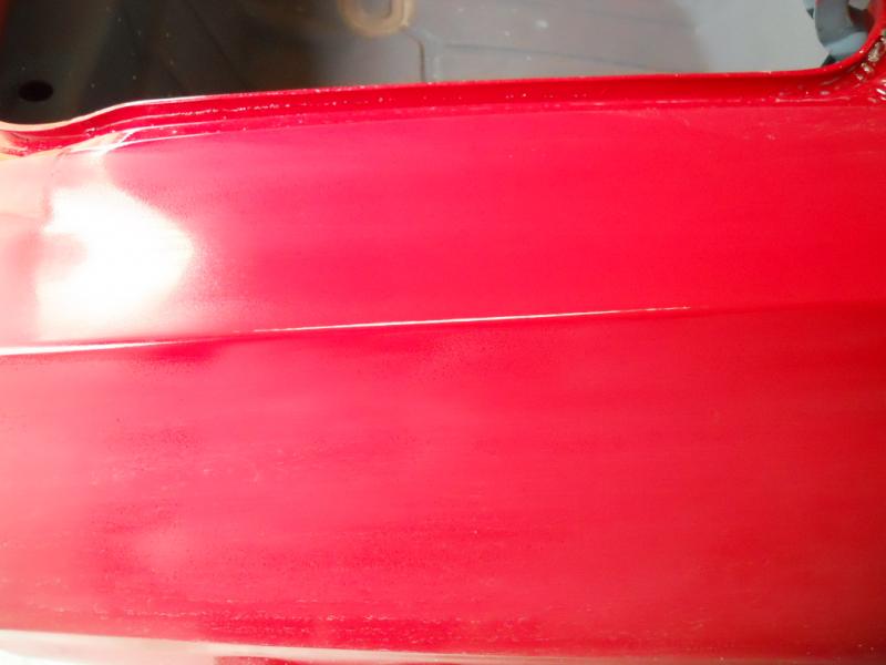

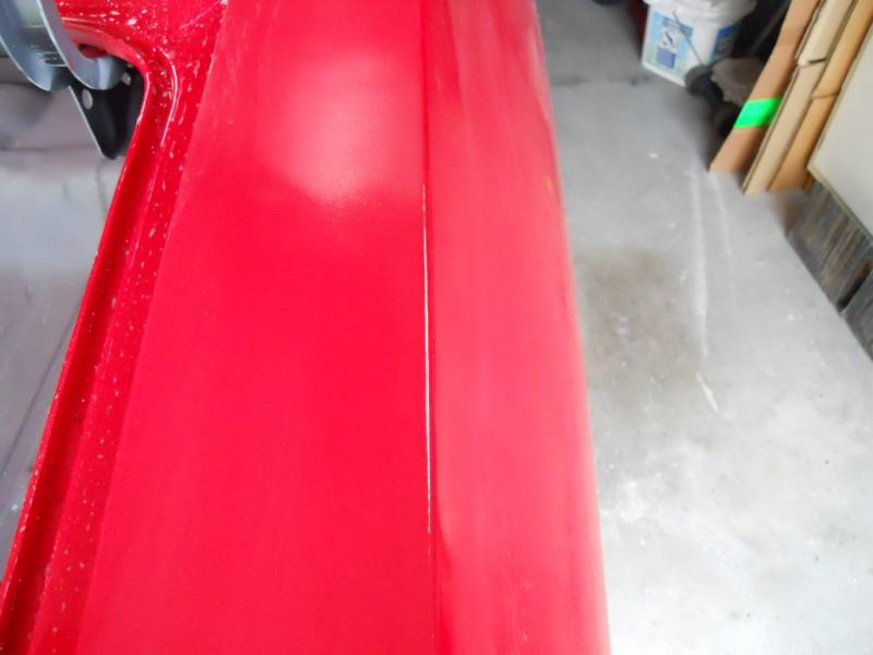

Thought i was doing good and wining the battle.
Then i did this on one of the places that the clear was a tad dry
with some 1500 wet sanding.
looks like im shooting some base again
then 800 wet the whole tub and a few more coats of clear
I could do a blend....but want it better than that.

Old 05-31-2016, 06:24 PM
I am with you there. I went through on the tail light extensions and another place. I fixed the tail lights both of them can't tell. The other if you look real long and hard from 3 inches with the light held just right you can kinda see it. I am over it. It look fine going by at 65. Once it is done a month or so you will forget all about it.
I tell myself once it gets its first rock chip. And it will it is unavoidable. That place is the least of its worries. I won't even mention the scratch I put in it and never fixed yet doing the lower trim LOL.
We all want perfect. But we are not. Guy I watched painted cars for guys. They were getting entered into Cavelcade of customs as a kid. And took first second and third in all catagories. Till they banned him to one entry he did per category. He would bitch moan and complain and show us 2 kids who faithfully watched and helped do anything he let us. Show us the things wrong with his work. And if that guy can't get it perfect to his liking. What chance do us mere Gelflings have.
Looks great. It be over soon.
