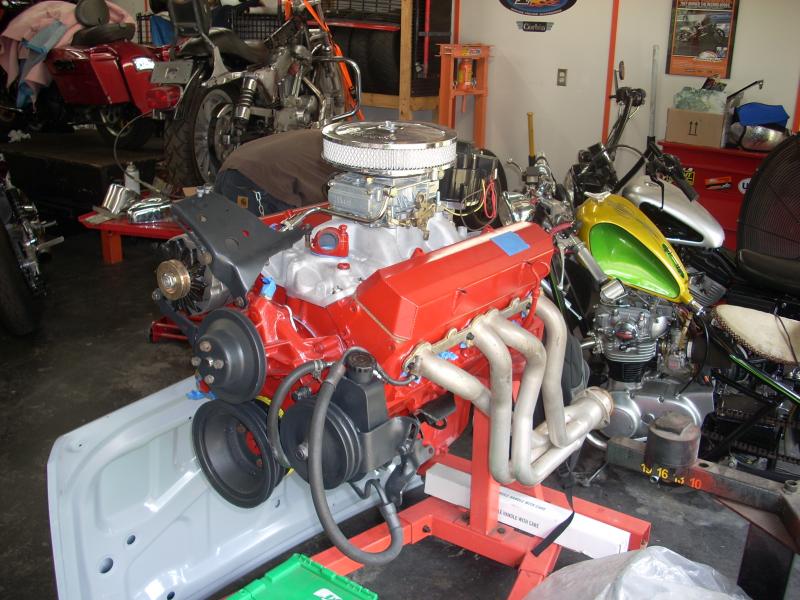

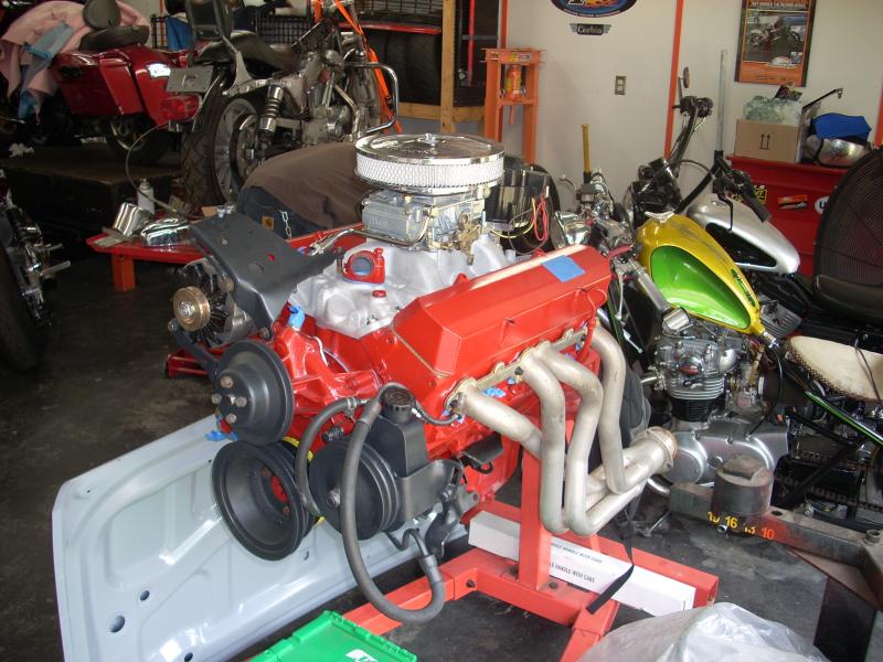

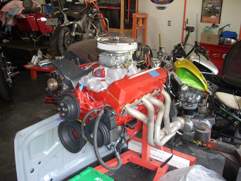

June 4, 2011 Saturday I was finaly able to do some work on the car. Not being able to get the quarter panel sanblasted this weekend. It was decided to work on the motor and finish it up. The cam I ended up using is a Summit #SUM-1787 Its 260/260 adv. duration and .427/.427 lift. Also used stamped roller rocker arms. Got it completly buttoned up with all new mini starter, updated alternator, new harmonic balancer etc. Valves adjusted. Couldnt find the oil filter part that bolts to the block. It must be at the machine shop. So I wasnt able to get it primed. Need some break in additive or break in oil. Next I Need to find a turbo350 core, as mine was junk. They are getting hard to find.

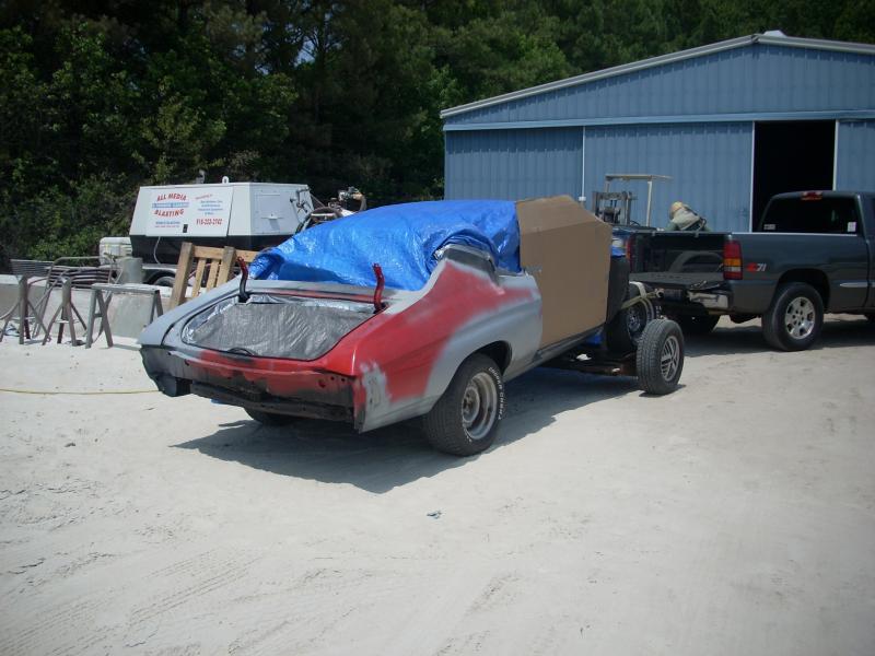

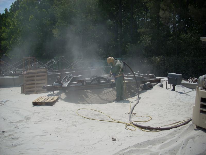

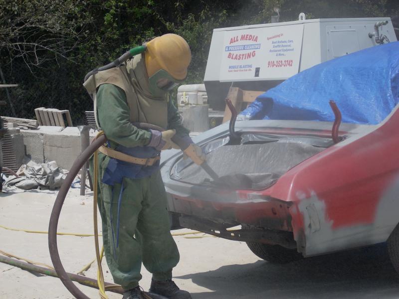

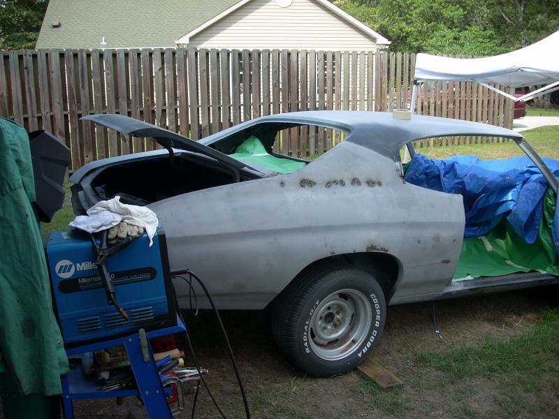

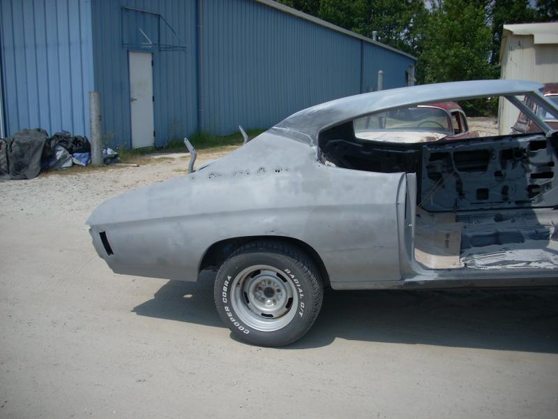

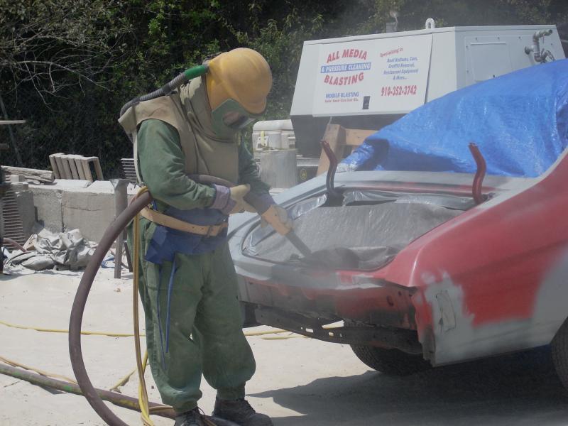

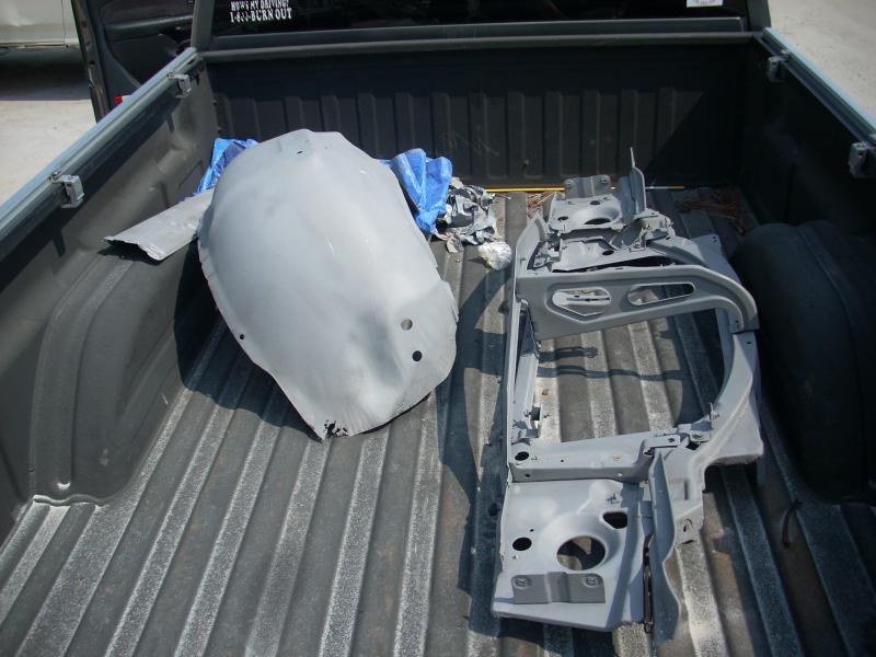

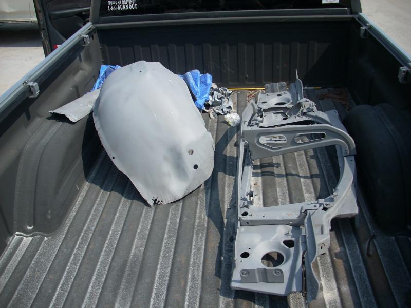

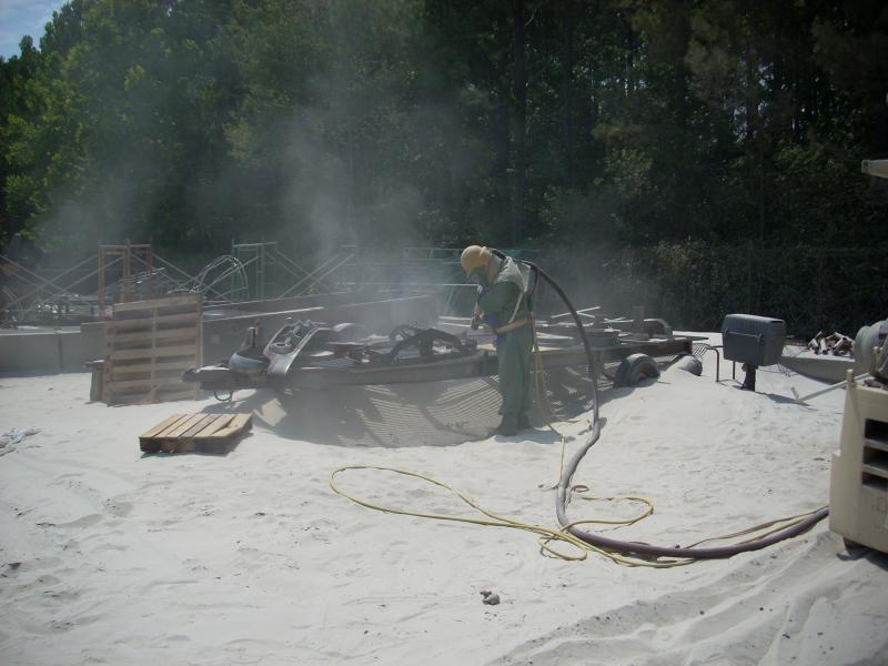

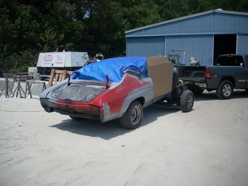

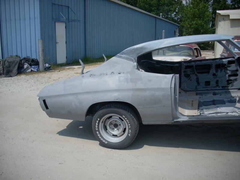

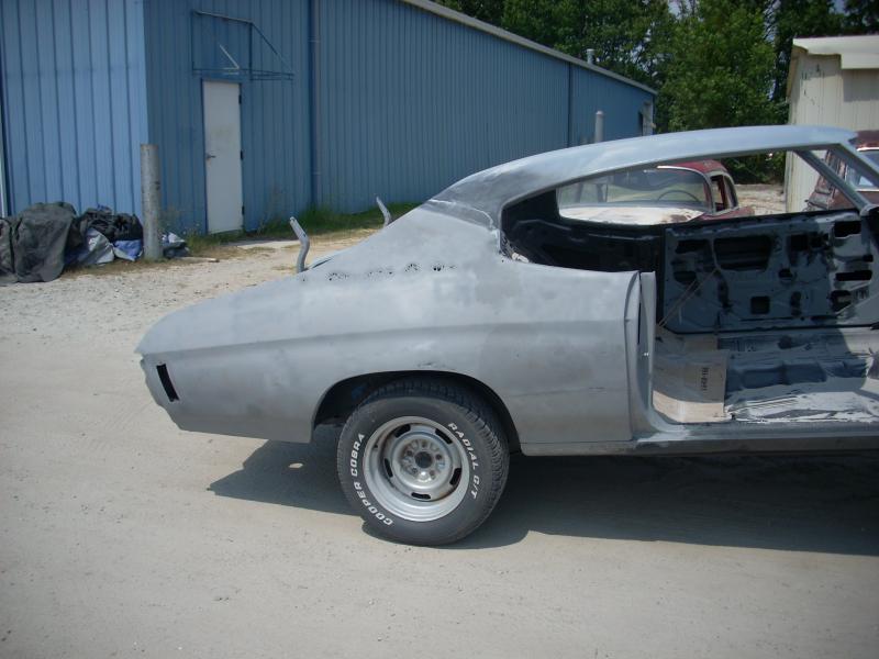

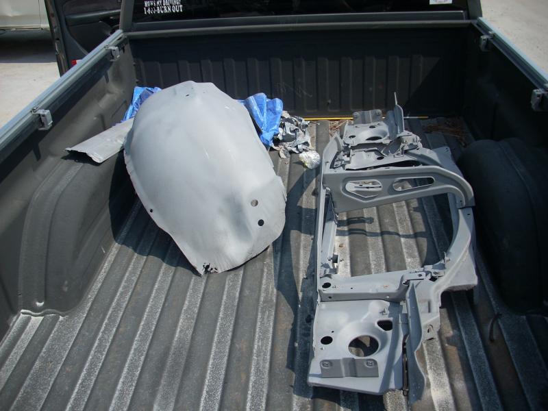

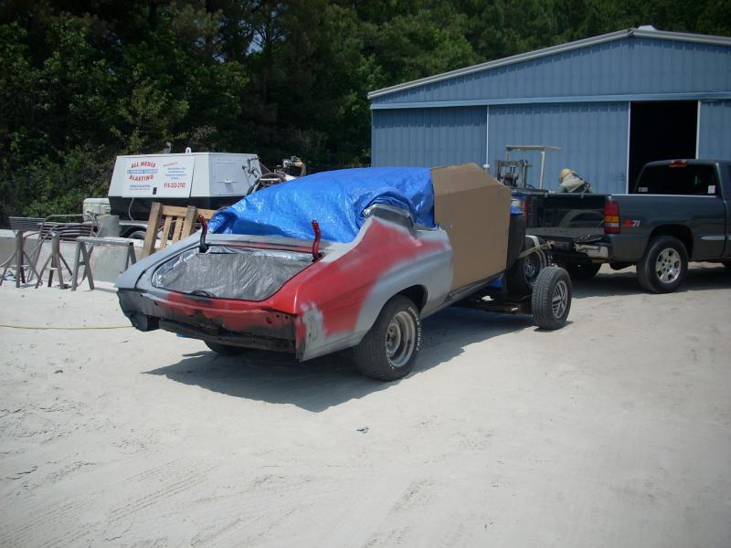

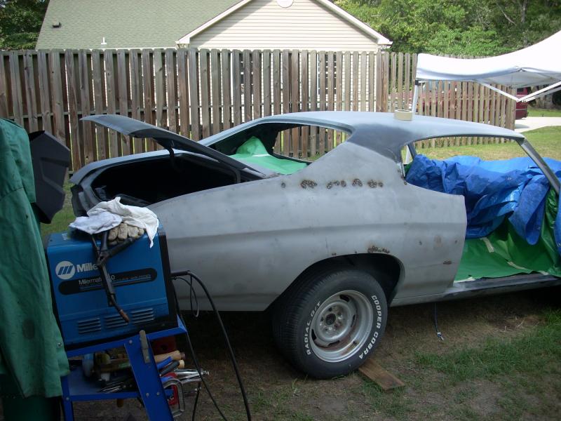

June 18, 2011 (Saturday) Was the day I was able to get the last of the sandblasting done on the Chevelle. What little rust holes that showed up I was able to stich weld up with my mig gun. All of its grinded and ready for epoxy primer. I just ran out of time and will finish taping off and try and get the primer on tonight. When the right rear quarter was getting blasted. I also had them blast the radiator support and the left inner fender. Both the support and inner fender are in a nice coat of POR15 thanks to my girl Julie spending her Sunday out in the shop painting. I took lots of pictures. Just havent down loaded them yet.
I brought the controls arms with the bushings and ball joints to my buddies brothers shop and had him install them. WOW was I hosed! $241.35. Two hours labor @ $70.00 p/hour and the rest was for the control arm bushings he said he "could only get in a kit". But there done and back on the car with new springs, tie rods etc. Also installed the disk brake spindles and rotors from my disk brake swap kit from Right Stuff. The caliper brackets dont seem to beefy, but will work. Other than that the kit is very nice.
Also got the lastl ittle bits on the motor finished and got it about ready to be dropped in. Just need to add the oil and prime it. And I was lucky enough to find a core TH350 on Craigslist for $80.00 bucks and have that at the rebuilders. So things are coming along. After I get the primer on. I wanna get both doors on. Then the rad support so that I can start getting my new fenders on. The hood, etc. Make it look like a car again! Pictures to come soon.

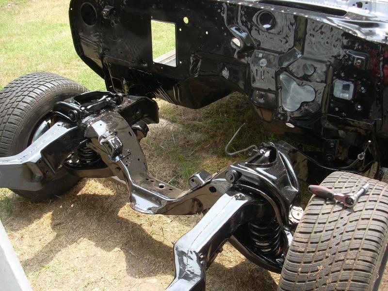

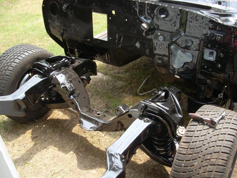

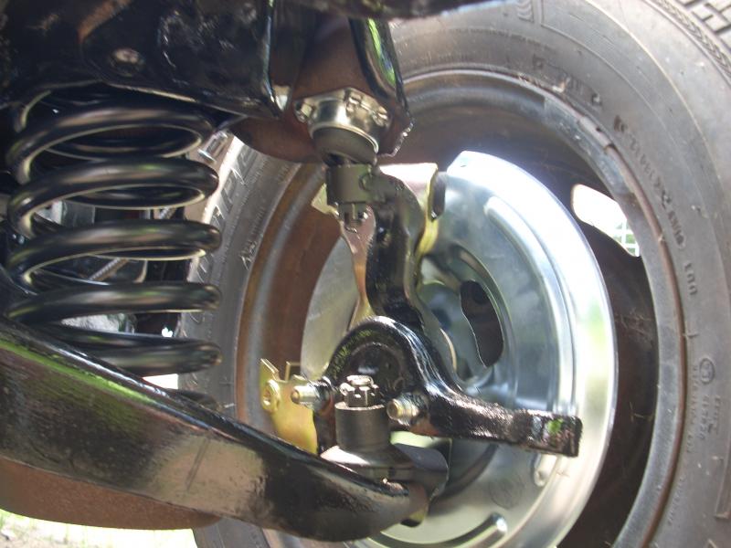

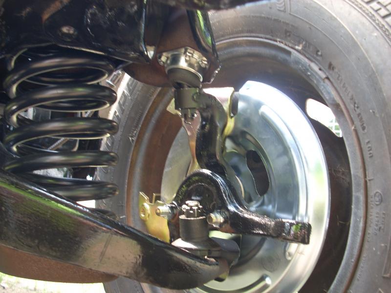

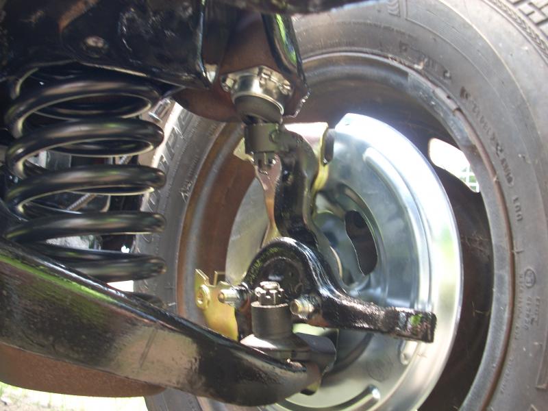

Some pictures. First picture of the upper balljoint, if you notice the boot dosent fit the top properly. Is this because there is no motor in the frame? Will it fit/look right with the weight of the motor on it? Or did I assemble something wrong?

More Photos and Julie my sweetheart helping POR15 the radiator support and inner fender.
