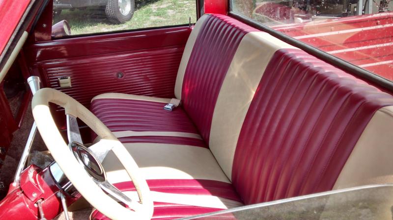

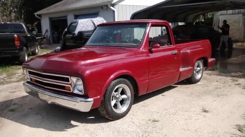

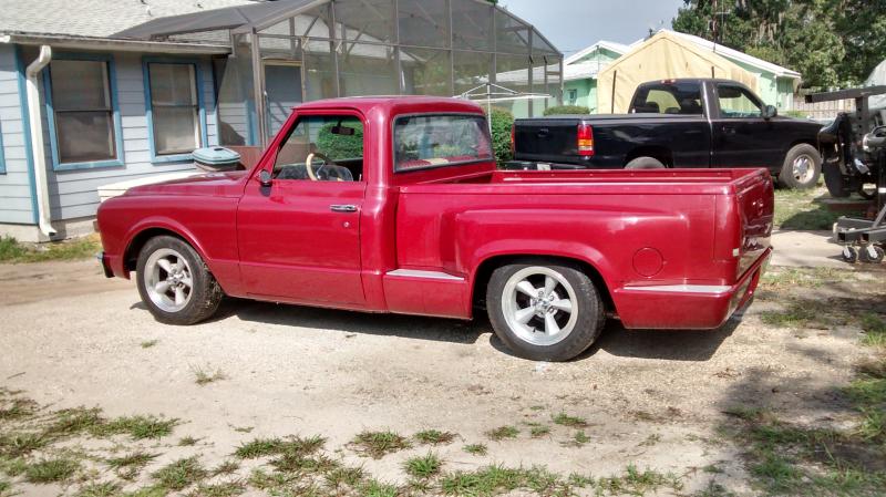

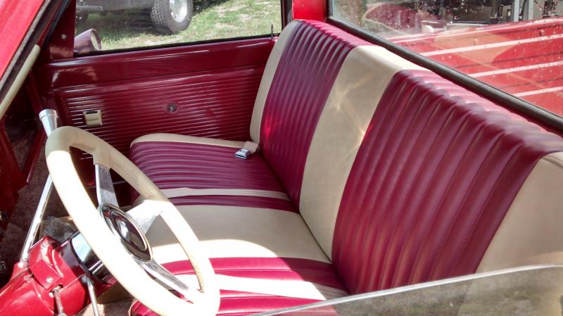

Here you go John, seat is in and a/c is hooked up. Next up, get it in the garage and fix the ride height.

Wow ,that looks great ,I picked up another one today ,my 72 is still not home though .

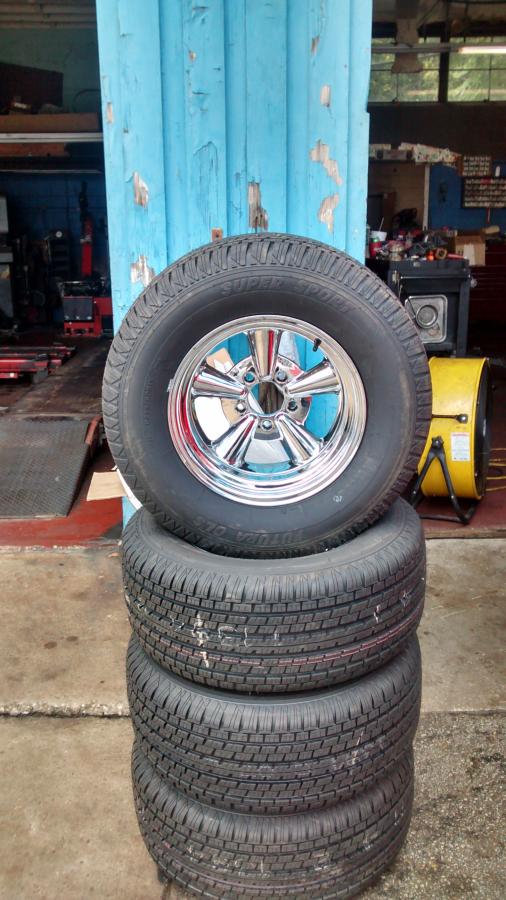

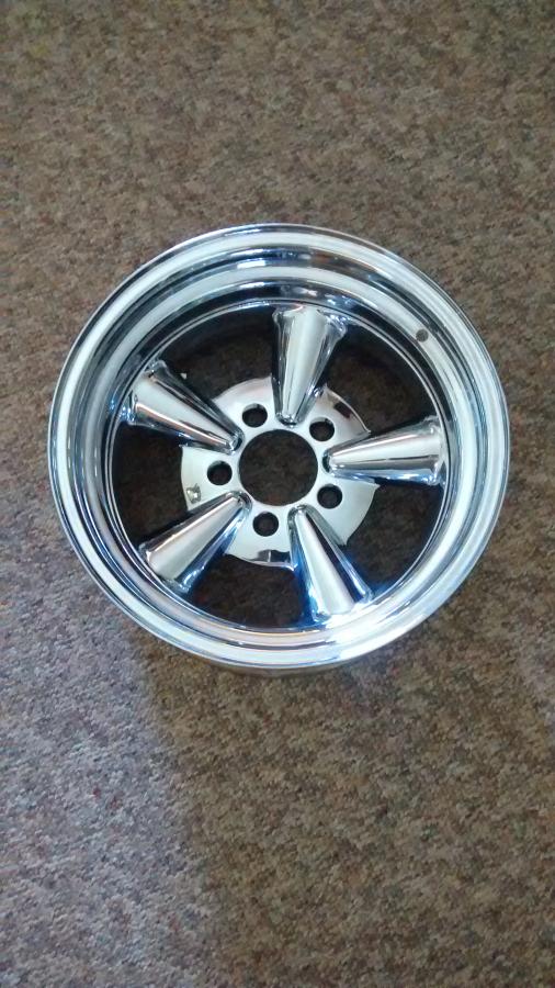

At long last, we've got wheels!

Old 09-02-2015, 04:17 PM
Those look good but the old ones did too .Someday Im going to get to enjoy my truck ,I hope.

The only thing wrong with the current wheels is that they are reversed to the inside too much. (4.5" back space) I was trying desperately to get wheels with a 2" - 2.5" back space. But, those are made of unobtainium. These have a 3.5 back space, it should help a decent amount. Going to run small, 3/16" spacers on the rear to even things out better.
I still have to pull the rear out to flip the perches to the top of the axle tubes. That will fix the ride height.

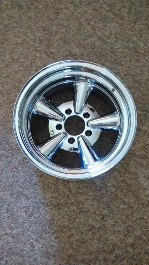

Cannot wait to put these on.

Old 09-22-2015, 10:57 PM
Cant wait to see them on the truck.
