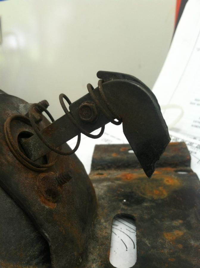

Old 07-21-2013, 10:54 AM
smokenjoep01's Avatar
Join Date: Jul 2010
Posts: 576
Anybody know were I can find the 90 degree piece that connects the vacuum diaphragm to the flapper inside the cowl on passengers side??Click image for larger version

  #310
Old 07-21-2013, 12:44 PM
I would try Hinshaws .
