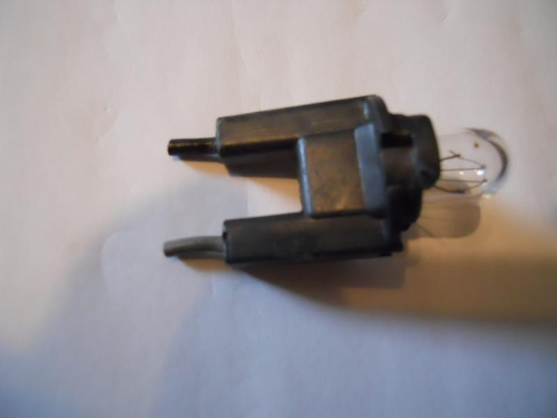

Anybody familiar with how this strip of dash bulbs gets power? I see no wires going to it???

  #338
Old 10-03-2013, 09:54 AM
Posts: 446
One of the bulb sockets should have two wires going to it.
Check your other sockets to see if they got mixed up.
Did not see one that looked like that.

  #340
Old 10-07-2013, 10:23 AM
Posts: 446
Default bulb socket
It should look like this with a black and grey wire
and go at the end away from the speedo.
Name:	bulb socket.jpg
