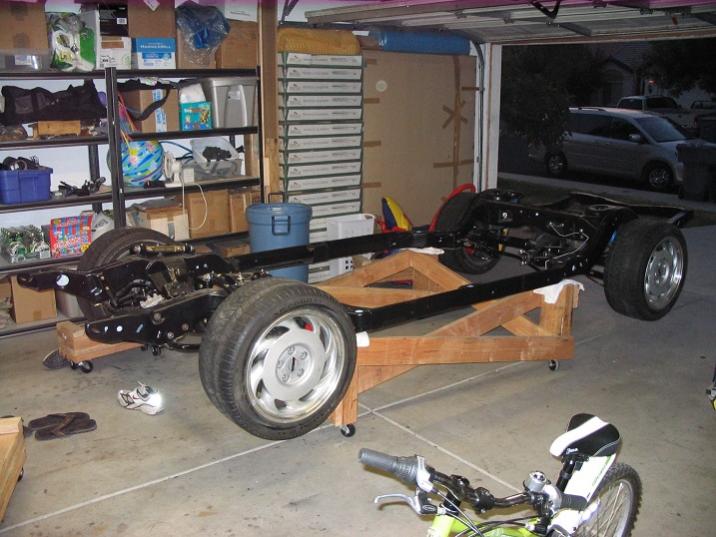

A year later - completed chassis.  Full GW suspension, Moser 12-bolt with TruTrac diff and 3.90 gears.  C5 front hubs with C5 brakes on all 4 corners.  I also installed SpeedTech AFX spindles - awesome pieces.
