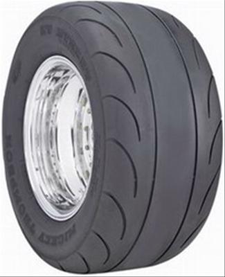

This weekend I ordered another set of 15x10 SS wheels (after much deliberation and after being VERY close to ordering a complete set of Billet Specialty Street Lites) and some tires to be used for track days.
MT Street Radial 28x12.5R15
Also picked up a new Bell M.4 helmet in matte black. Getting closer to terrorizing small children and little ladies with this thing!
