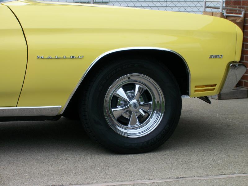

What they look like.

Actually the tires looked good, no dry rot, lots of tread, nothing bad until just lately. That day on the expressway was the first time this year we took it over 65mph. Glad we found the problem before we had a tire blow.
I had that happen to my 74 Monte, front left tire decided to have the tread come off on the expressway at 85mph. My inner fenderwell exploded, the tread was flappin all over, took off my wheel opening trim, bottom mldg on the fender and dented the fender real bad.

That's crazy if they actually were 14 years old, lucky nothing happened on the freeway. IMO think the car looks pretty sweet as it sits now, but you could have her look at several car so she could show you the look she likes and start from there to help you decide on a tire/wheel size.

Stormer, it does have 275/60/15 on the rear now but they are on 7" rims. I will take a couple more pics closer up.
Old 06-30-2014, 09:12 AM
8" rims would be better, 7" is too narrow for a 275/60 tire. If you go any wider on the tires you may run into problems. Rubbing the fender or wheel well. You can always roll the fender lip, make sure you get the correct back set if you go with a wider wheel. You may not have a problem but I think 275 is widest tire that is pretty much guaranteed to fit.
215 on the front. I'm not a fan of skinny front tires, I know some people like them. I'm running 245/60/14s all the way around, stock rims, and they fill up the opening pretty good. My car is a big block though and I think the front my sit a little lower than yours. I also have a set 275/60/15s for the rear on 8" rims. Personally I wouldn't want anything bigger than that but that's just my preference.
