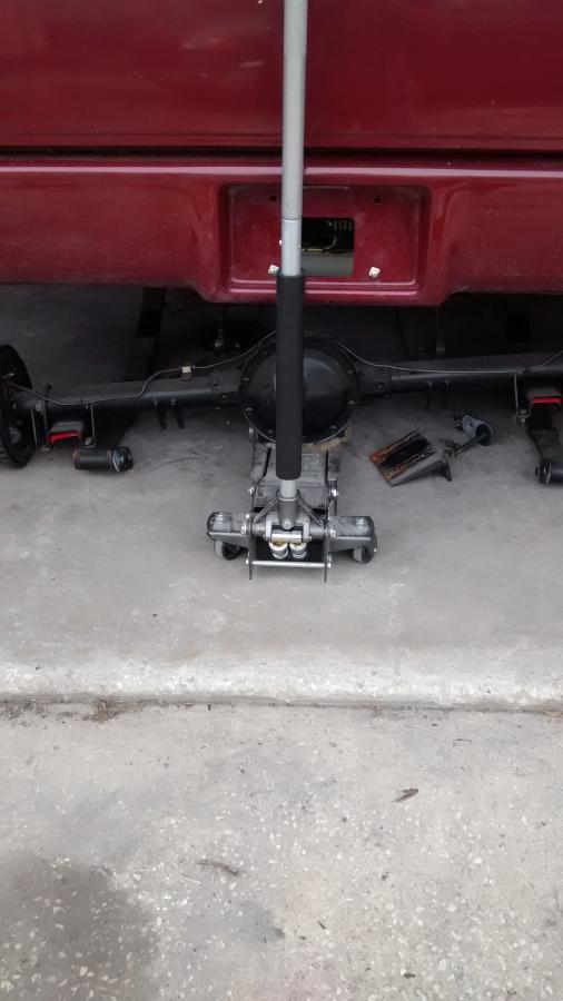

Truck is in the workshop now, I got the rear axle out in a little over an hour today. I'll change out the bent axles and fabricate new shackle mounts this week.
