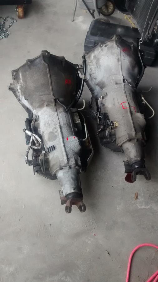

Problem solved! Picked up two 4L80Es today.
