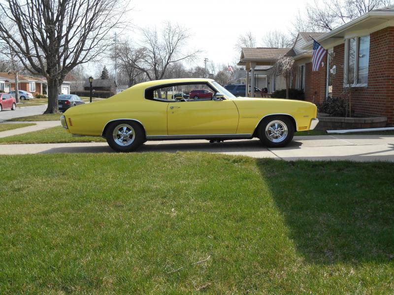

Ken Hayes's Avatar
Perry, my 70 has 15x8 4.5 inch with 275/60 and the car is lowered 2" with no alterations what so ever...........lots of room.
