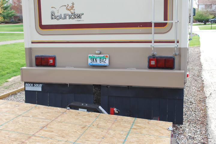

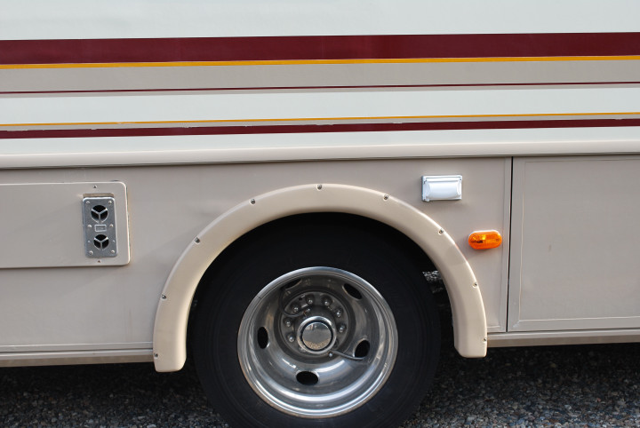

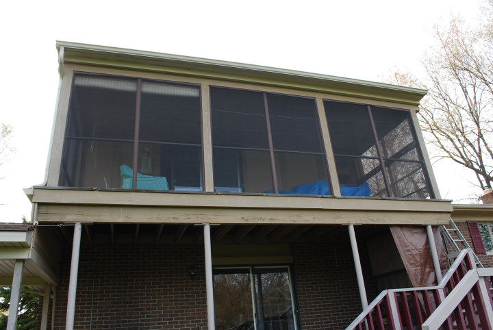

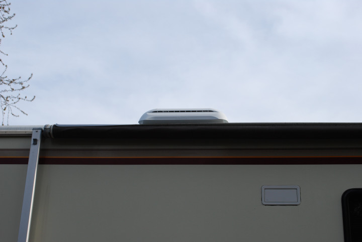

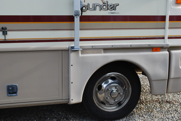

...being unemployed is too much work. The rear bumper on the motorhome was crunched in the middle, top and bottom were buckled. So i pulled it off, cut the back side open, beat it back into shape, welded the back on again then painted it. It's not perfect, that metal is a lot thicker than auto sheet metal but it looks better. Krylon Khaki is a pretty good color match, not perfect but close, first pic. So I got some Krylon Fusion in Khaki and painted the rear plastic fenders and one front fender, 2nd pic. You can see from the pic of the other front fender how dull and faded they were, 3rd pic. Also replaced the frig vent cover, the plastic was cracked and brittle, 4th pic

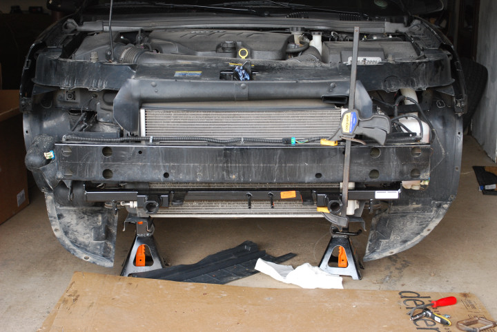

Ordered a tow bar, base plate and wiring kit so we can tow the Malibu behind the motorhome. The first base plate was bent so they overnight-ed another one. Didn't notice the bend until I had taken the front of the car off to install it. You can see from the pic what has to be removed to install the base plate. Not done yet, it just came today. Have to drill some hole and bolt it on then put everything else back on.
