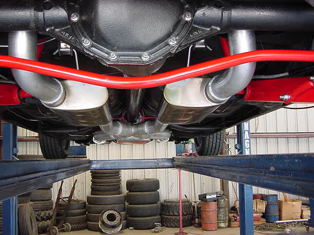

Old 06-05-2013, 11:24 AM
SS Shaun SS Shaun is offline
Join Date: Mar 2011
Location: poconos pa
Posts: 1,921
i found a picture of it on my photobucket
that is the only thing i have is that what you are looking for?

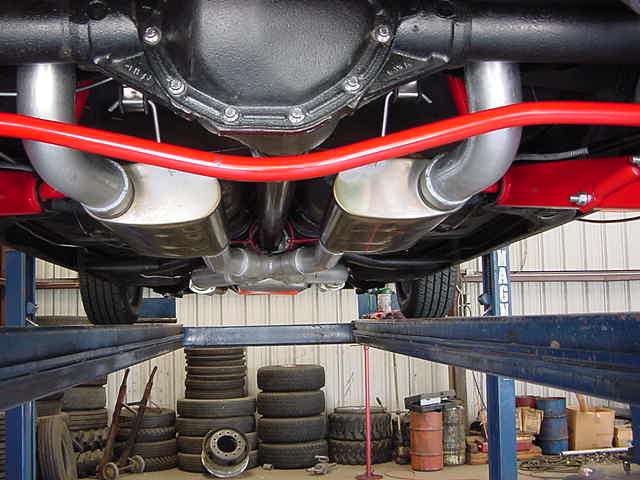

Old 06-05-2013, 02:53 PM
Outlet on those mufflers you've shown need to be offset...not center...for the tailpipes to fit correctly on a Chevelle.
Like this.....
