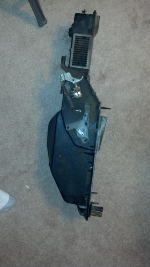

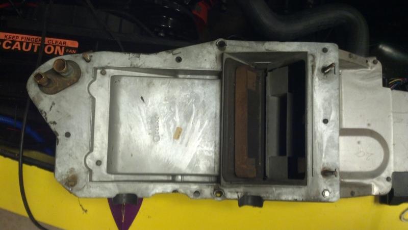

so as i was getting all the stuff together for the Christmas Decor i was in my attic and i found my heater! i didnt know i even had this...lol So no my question to you guys is is it easy to install? where does it go on the car? I know it bolts on somewhere by the firewall but i am not sure where exactly. I am asking because my firewall has a bunch of sheet metal riveted in and i dont want to remove something if i cant fill it in. some advice and pictures would be great

It is a challenge to put in with everything on the car. Installed mine before I had my inner fender wells in since some of the bolts are behind that.
This is what my non AC car looked like,
You will notice om 70 the fan motor sits above the inner fender well and it only accessible with the inner fender out.
I believe 69 is different then 70.

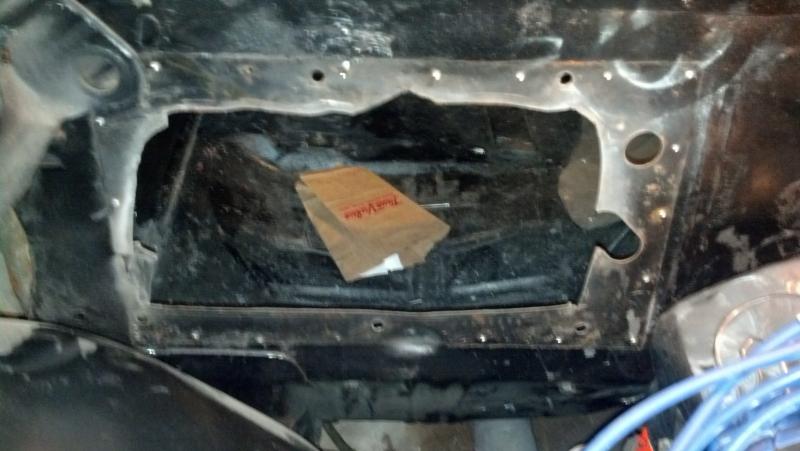

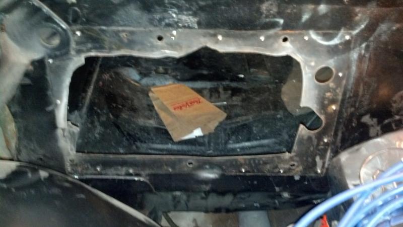

so i got the thin plates off my chevelle and this is what i got
thoughts? is this an ac wall or a non ac wall?
Name:	outer firewall.jpg

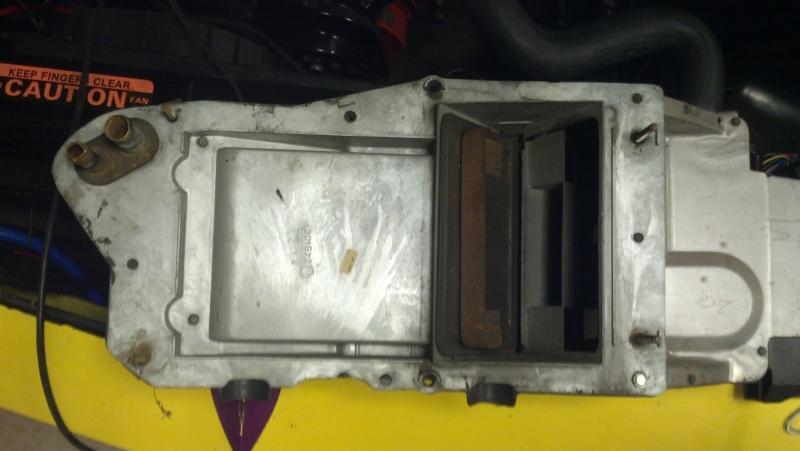

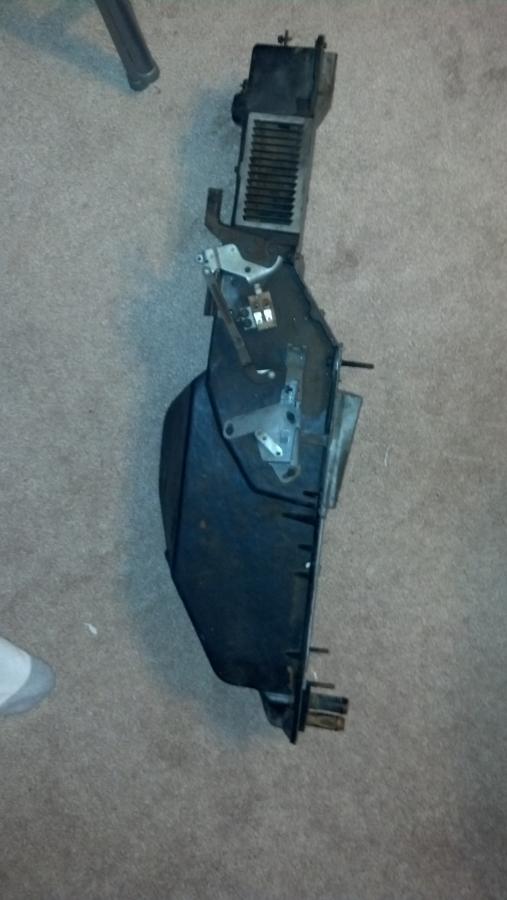

and here is my heater box. and i am going to guess its for an AC and my firewall is Non ac
Name:	front heater.jpg

Old 11-30-2013, 05:23 PM
This is a 69 AC firewall car. And yes your heater box is for a AC car, but not your firewall. Do you have the firewall side equipment?
At this point you might want to go with a vintage air system.

Old 12-01-2013, 09:25 AM
Looks like you should be able to do some mods on the fire wall and make it work. Might be able to find a wrecked 69 with ac and cut that section out to weld in. Make sure you have everthing you need, some of the AC parts for the 69 are one year only.
