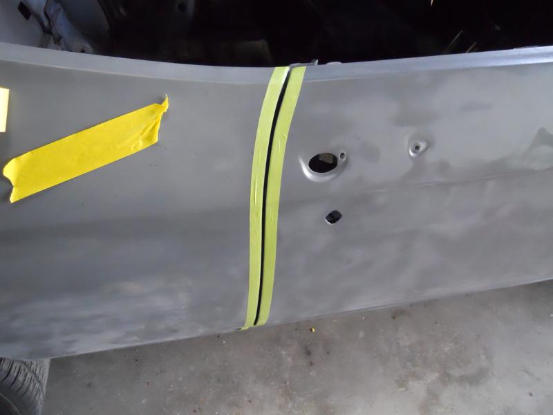

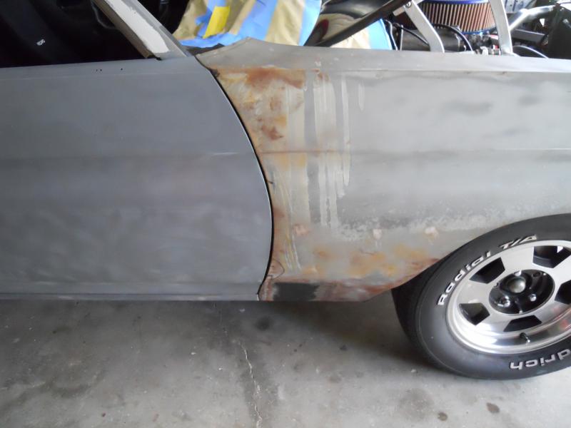

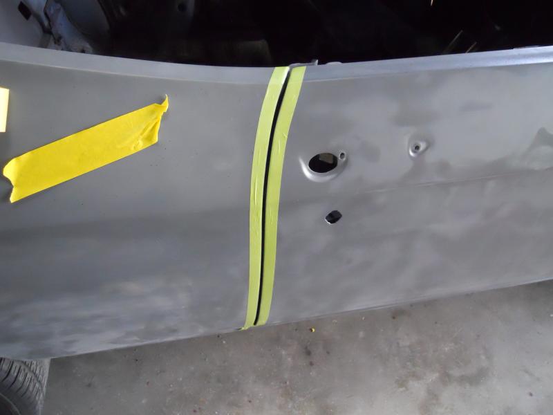

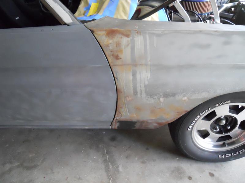

The gaps are geting better.
i removed a few shims from core support
They still need a little welding and grinding
And i had to re do a fender patch i didnt like.
