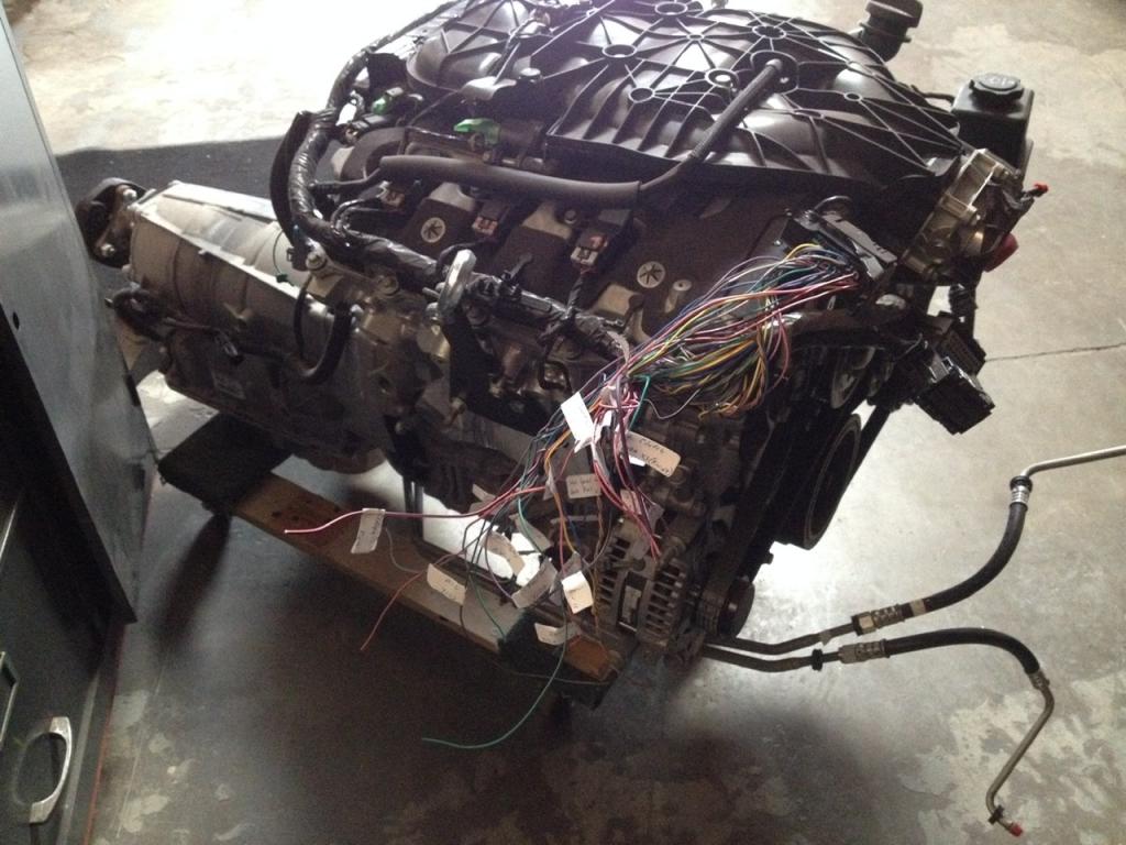

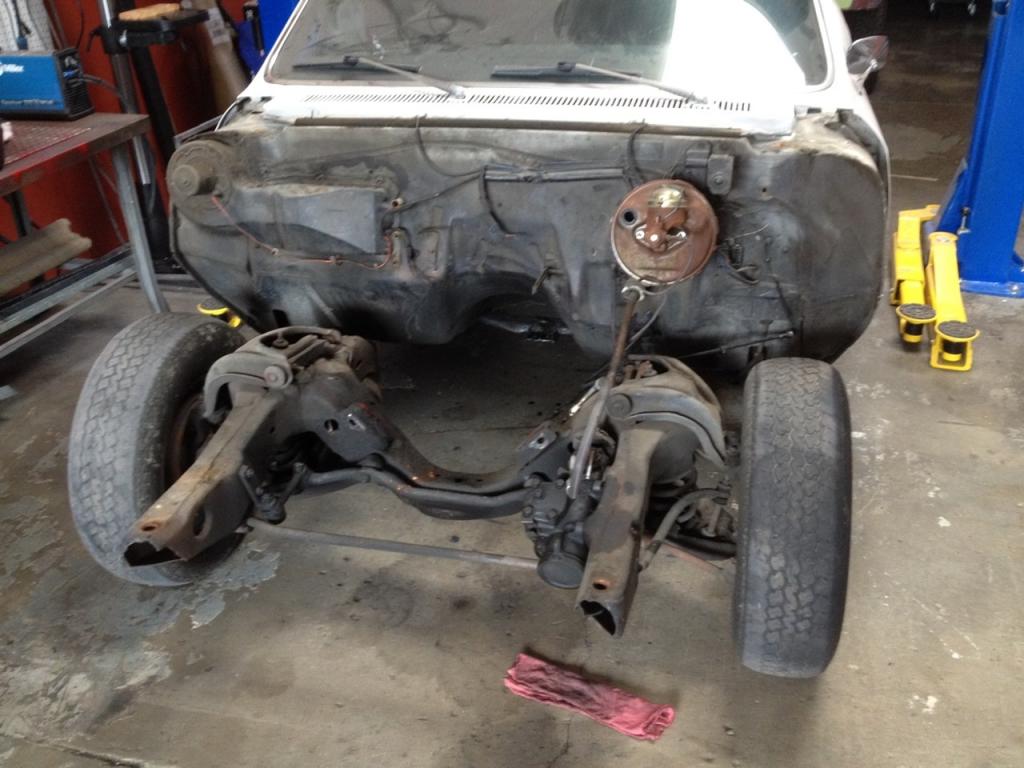

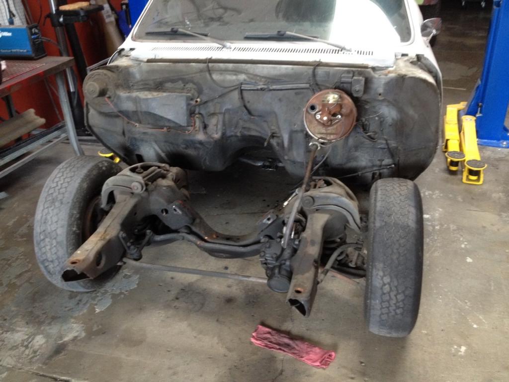

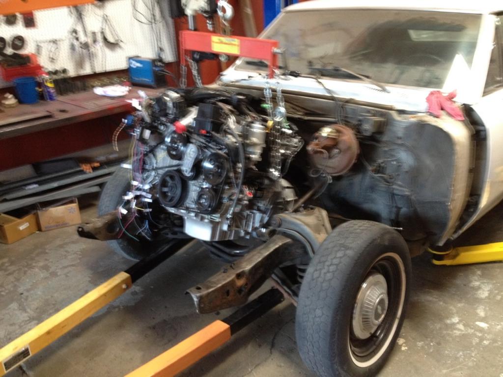

So when I got the itch again, I decided to do a 66 Chevelle and go for max mpg. I started looking around for an engine and again found an almost new Camaro (2013) with a 3.6 liter V6 and a 6 speed auto. It was wrecked with 525 miles. The project was on.

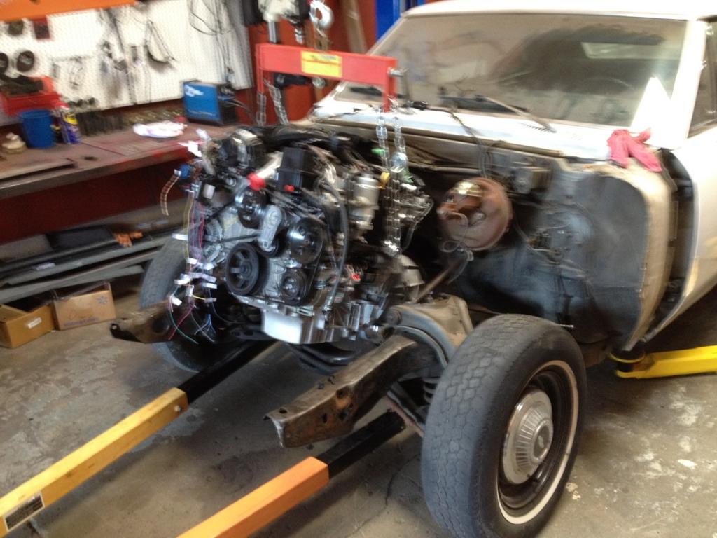

Here are a few pics of the beginning.

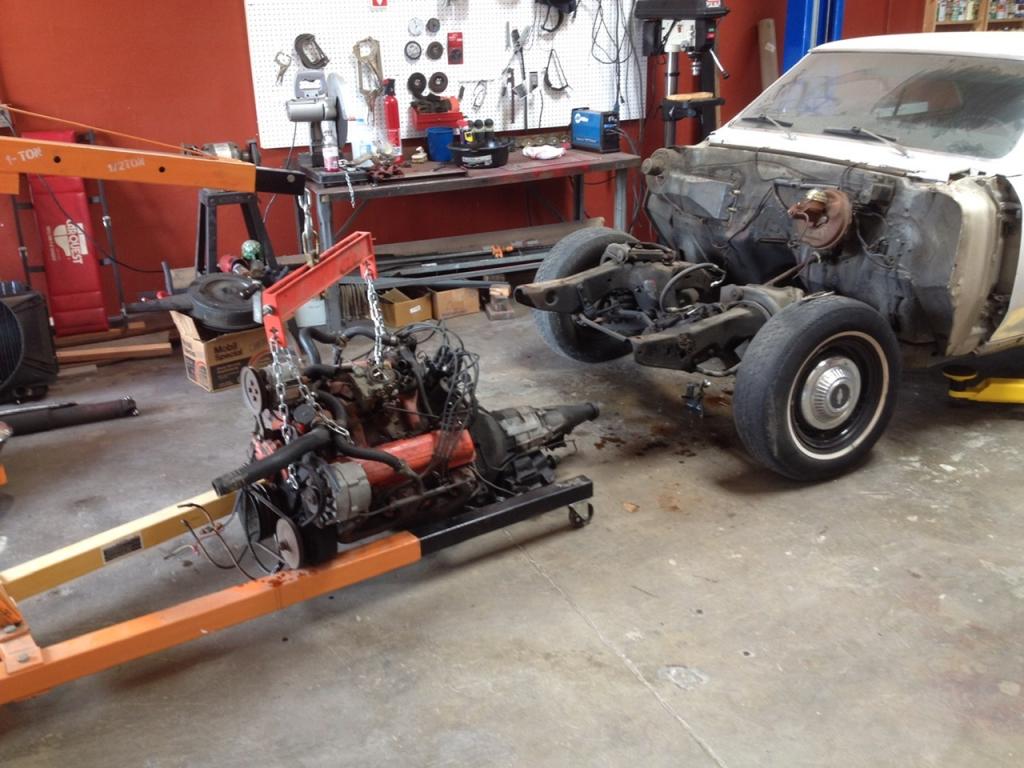

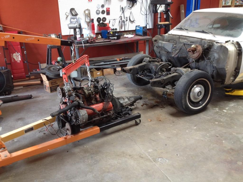

Out with the old engine/trans.

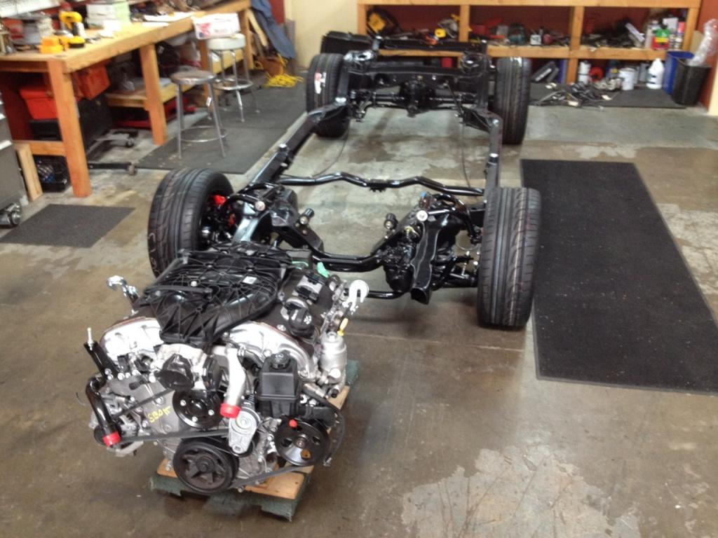

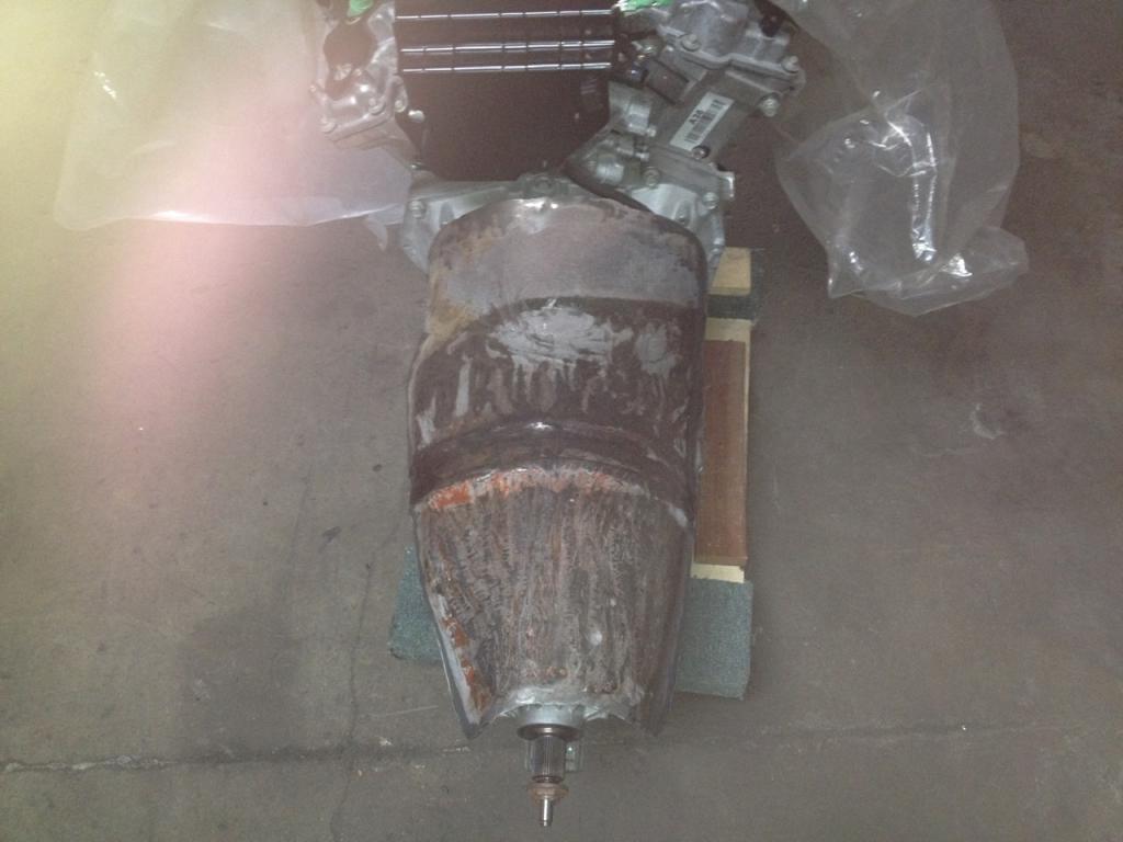

The new engine as it arrived.

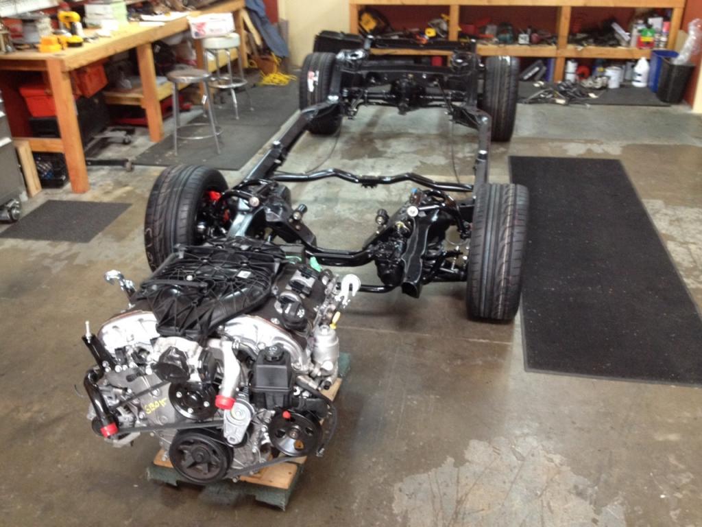

First attempt at fitting it in.

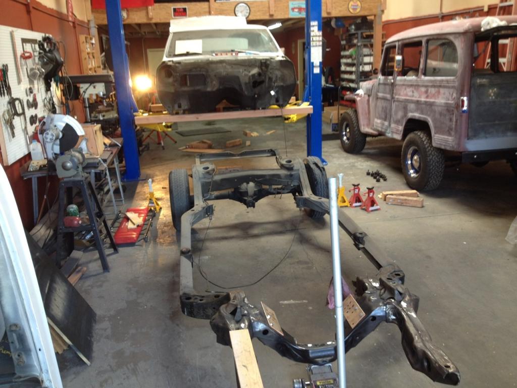

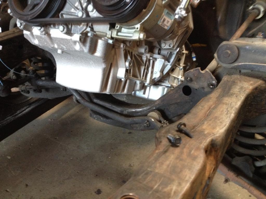

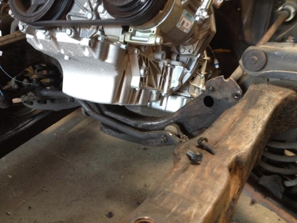

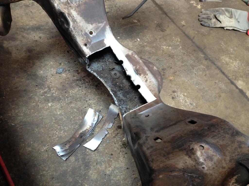

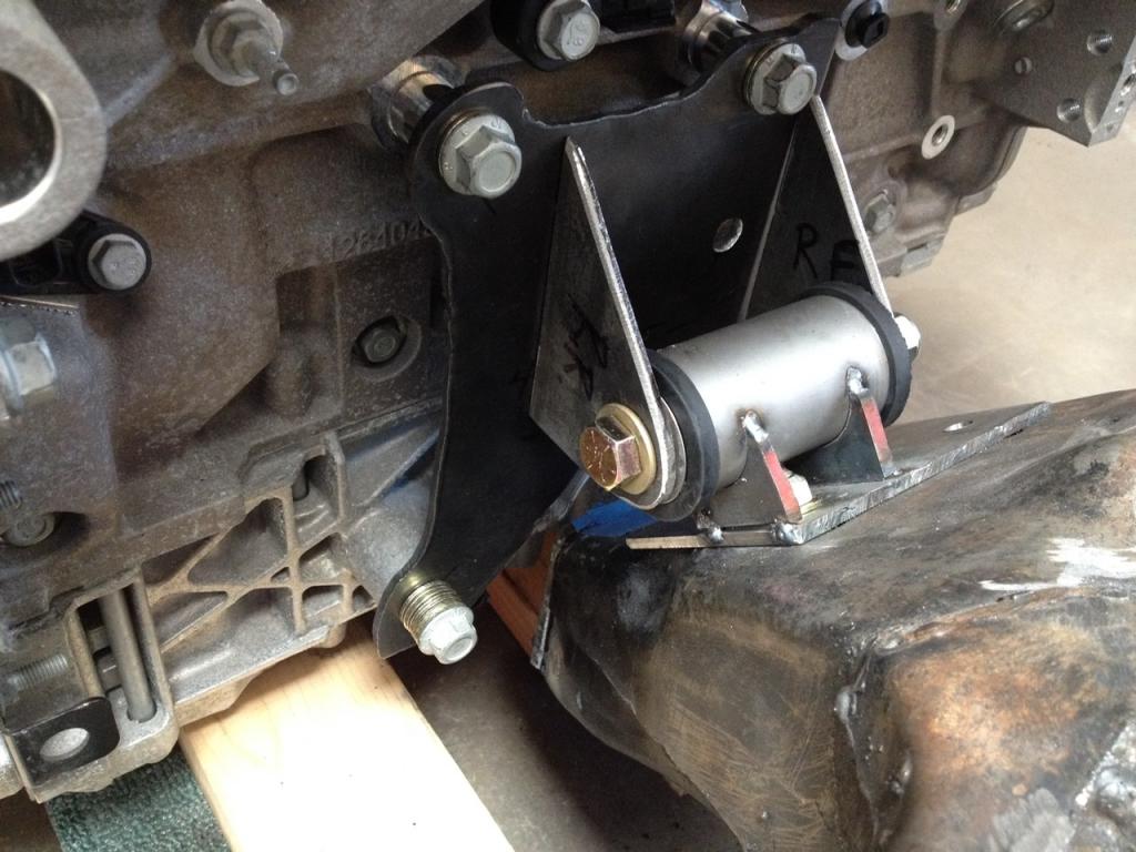

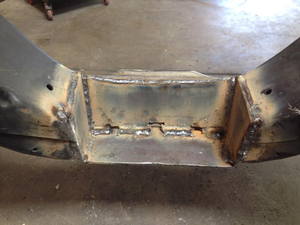

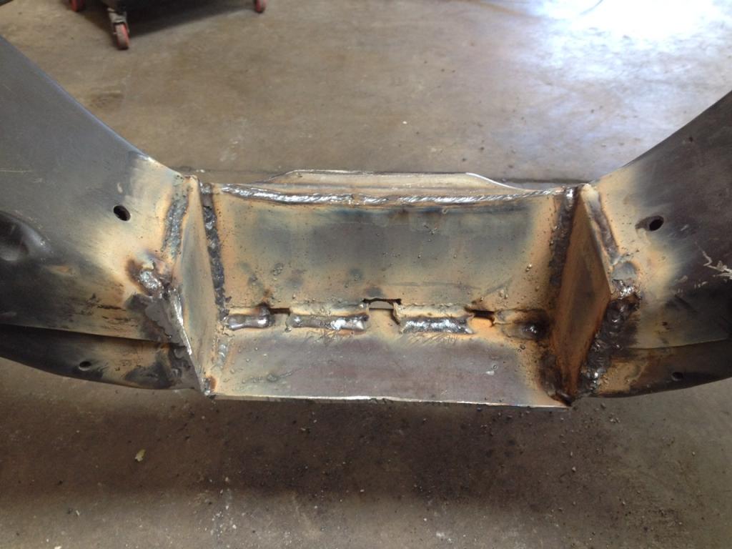

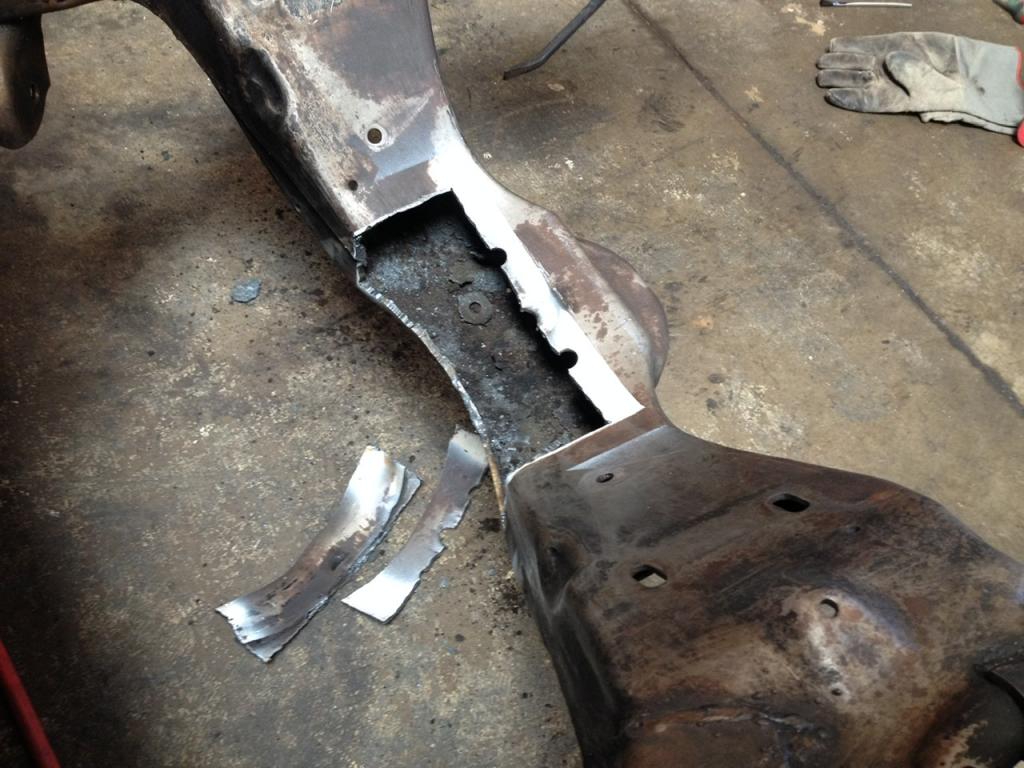

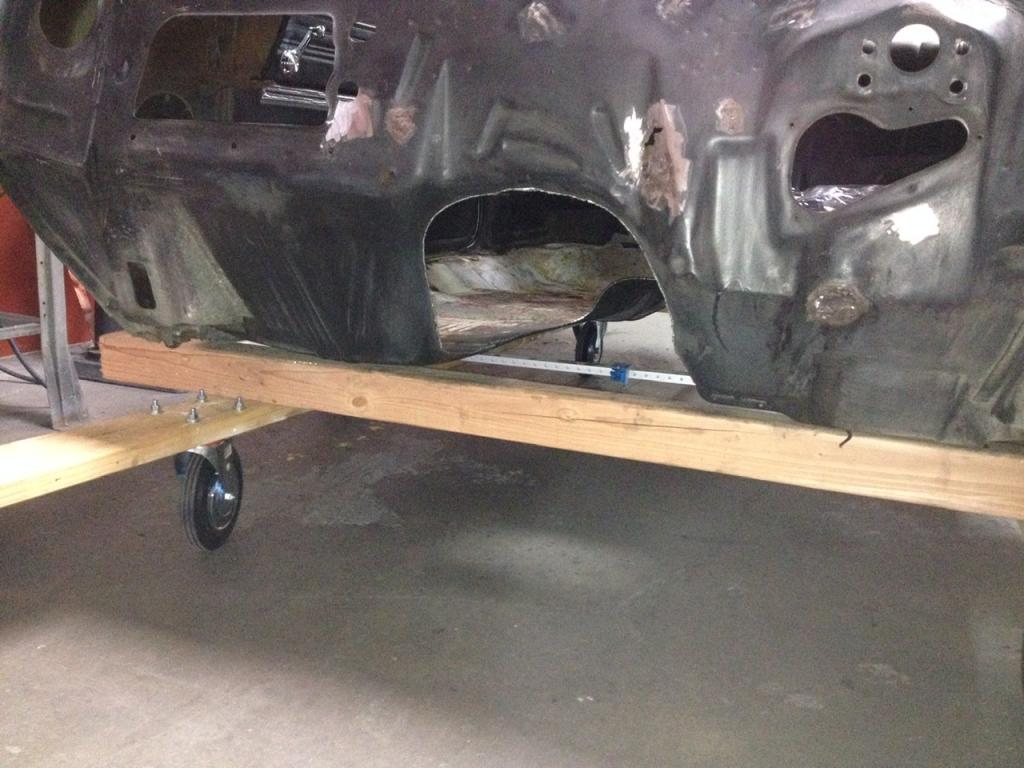

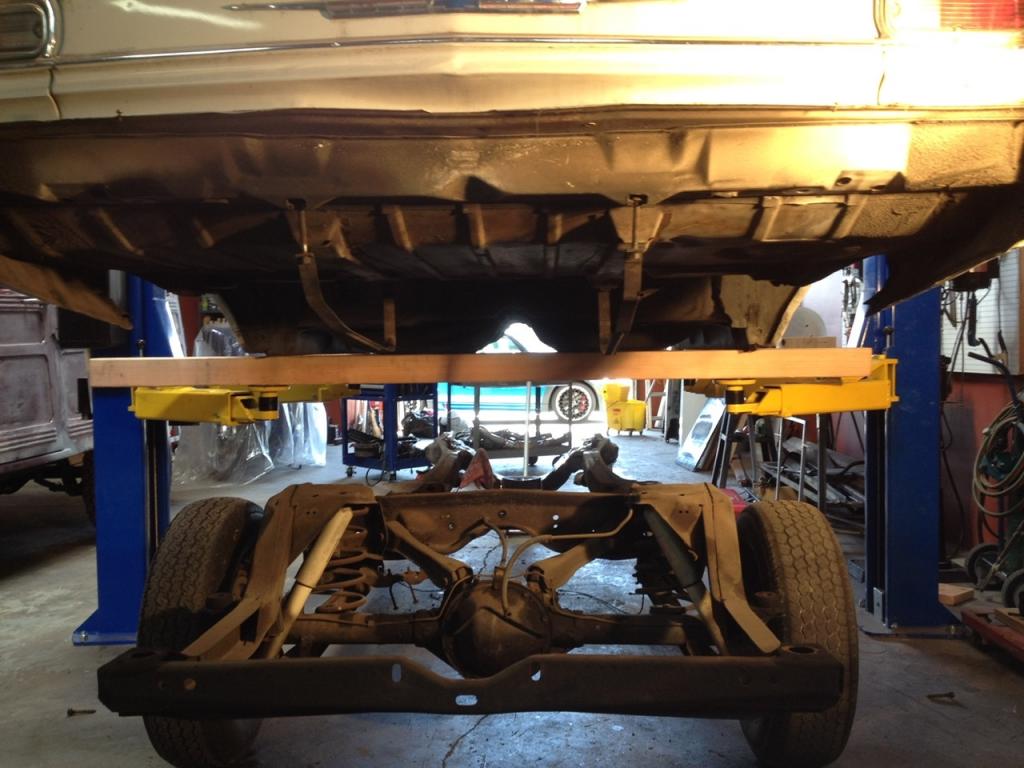

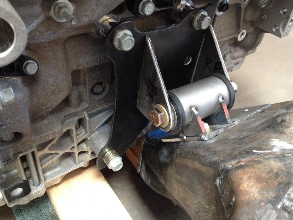

Once it was determined that the engine wasn’t going to slide in I decided to remove the body and do the entire chassis.
I ended up cutting and boxing the front crossmember to clear the oil pan.

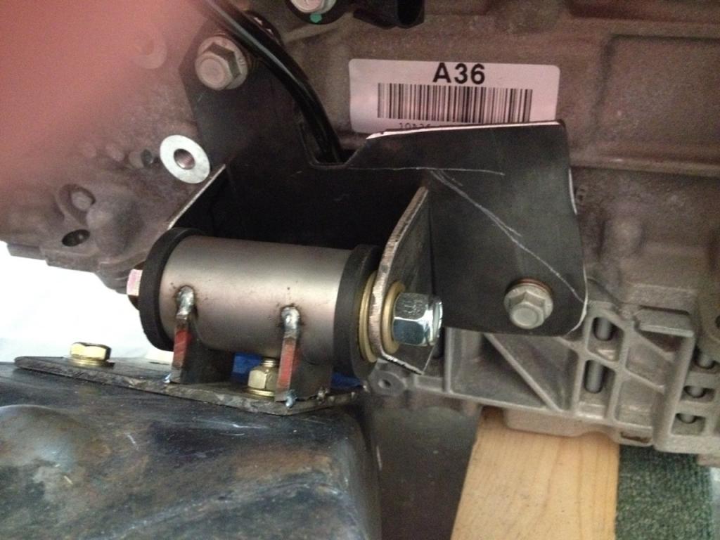

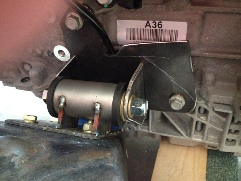

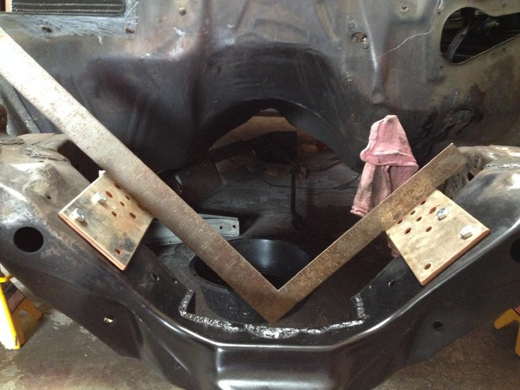

Then I had to build motor mounts. How many of you knew that the front crossmember mounting surfaces were 90 degrees from one another?

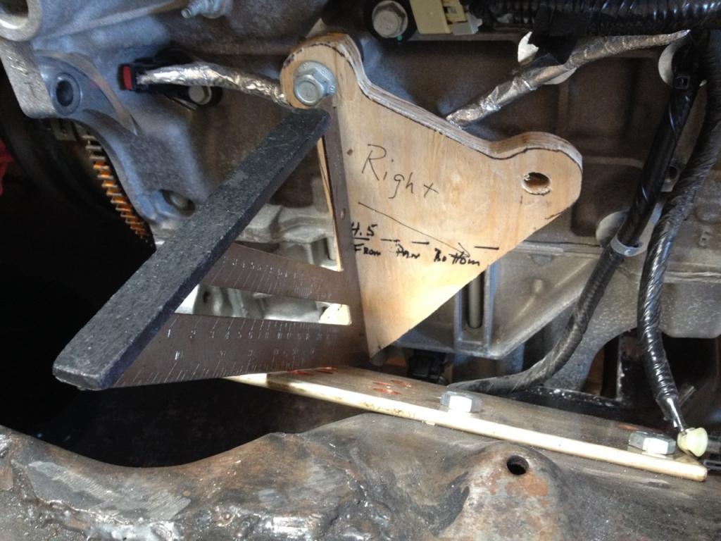

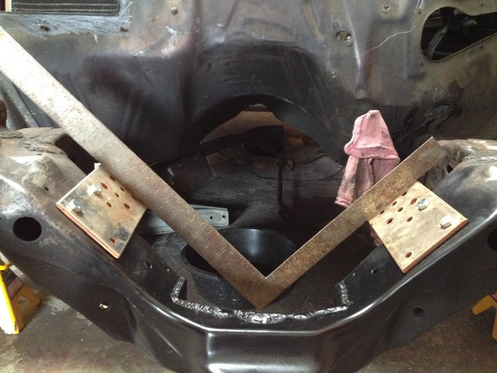

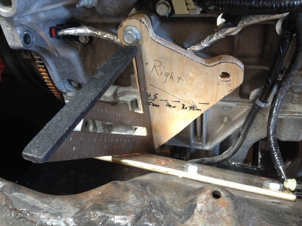

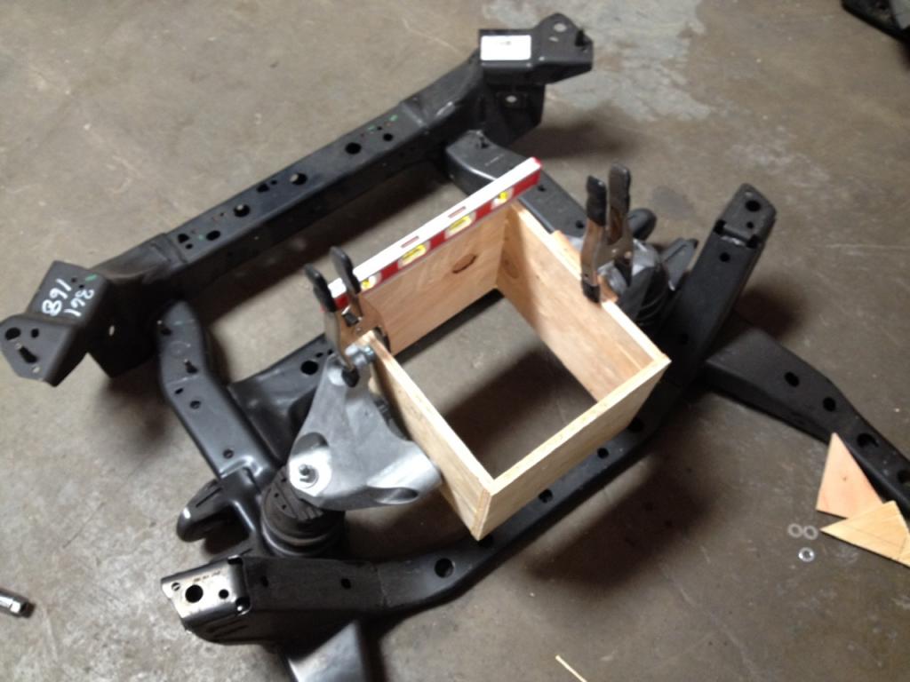

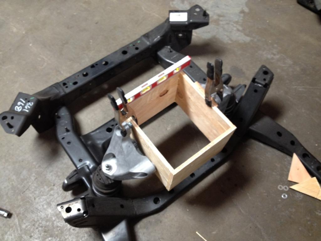

As it turned out, the sides of the LFX V6 are perfectly parallel to one another. So I built a wood box the same width to start with the motor mount fabrication. Way easier than swinging the engine in and out a hundred times.
This pic is of the engine box mounted to the Camaro sub frame with the Camaro mounts. This way I knew it was correct.
I built the engine side plates out of wood and then transferred it to steel.
I tacked them together than pulled them for finish welding.

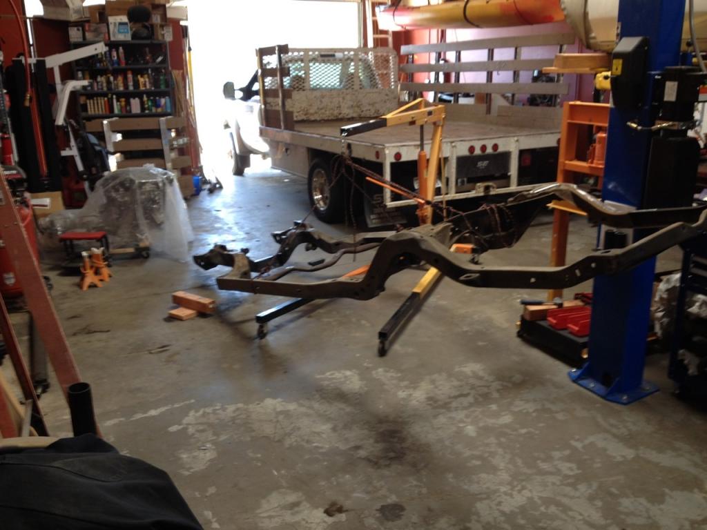

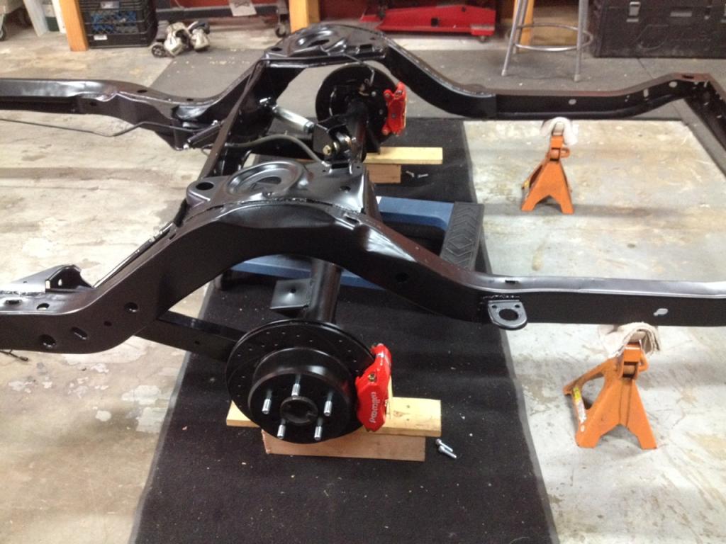

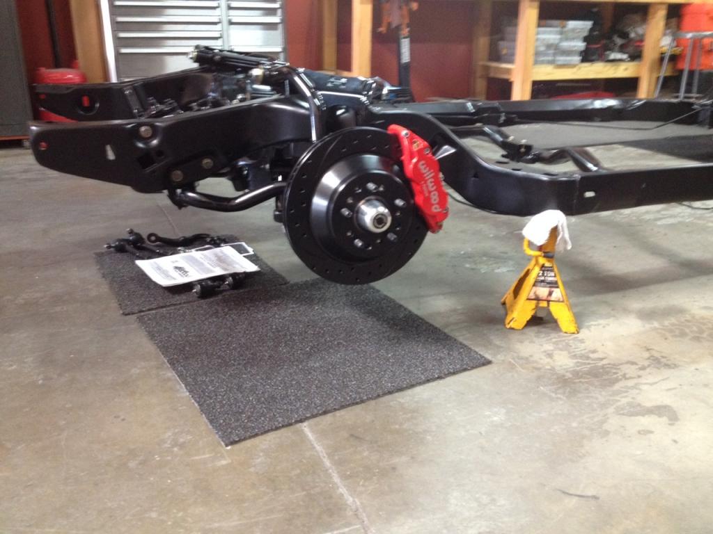

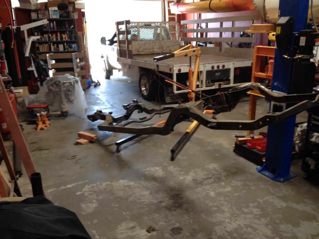

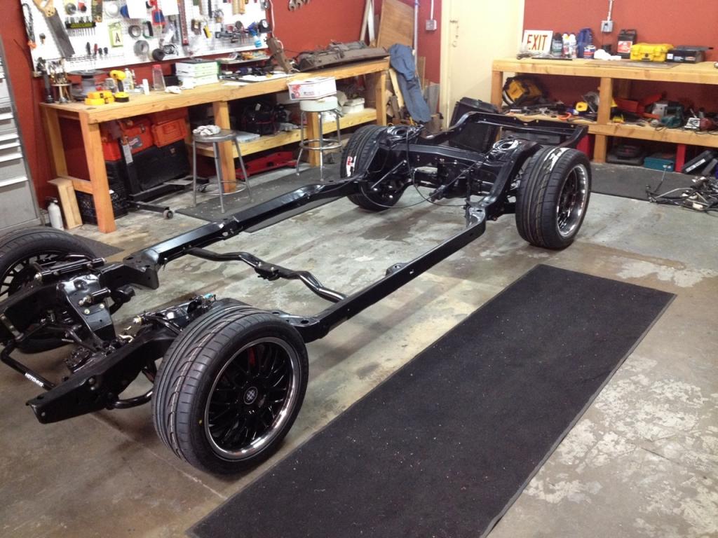

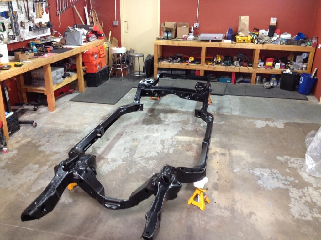

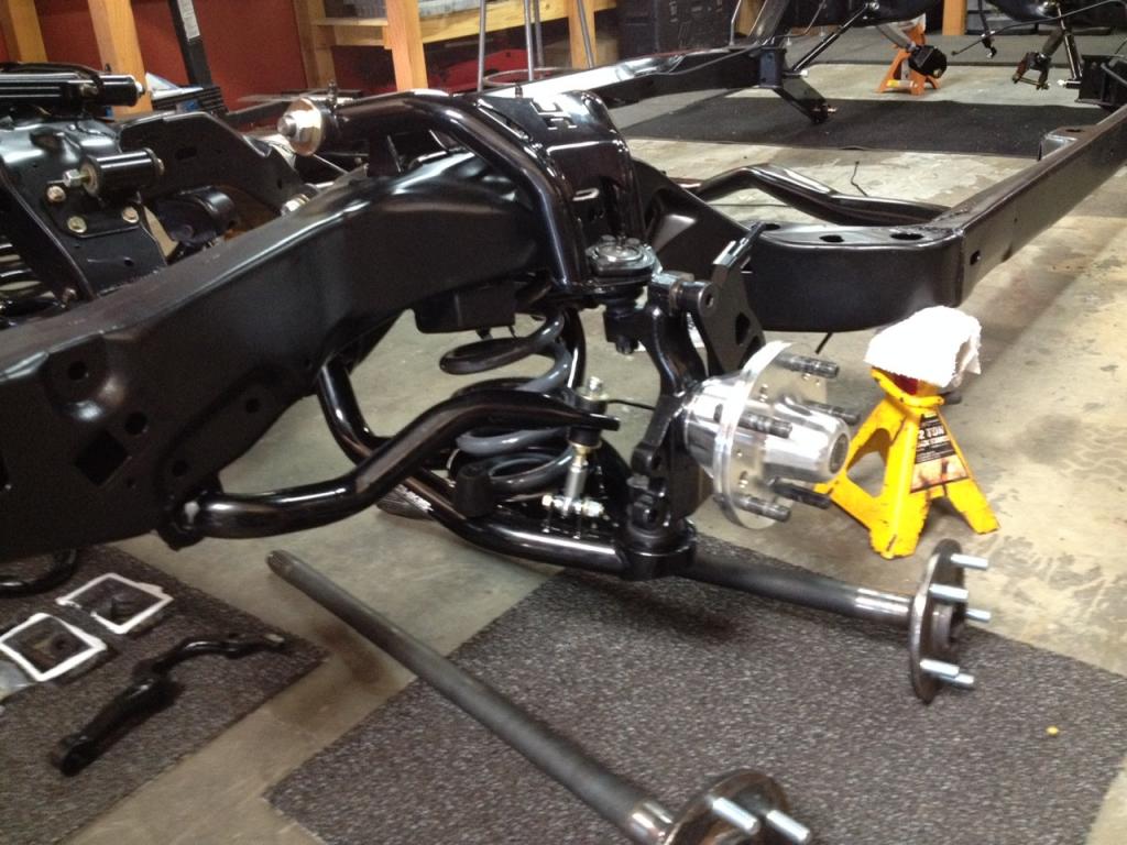

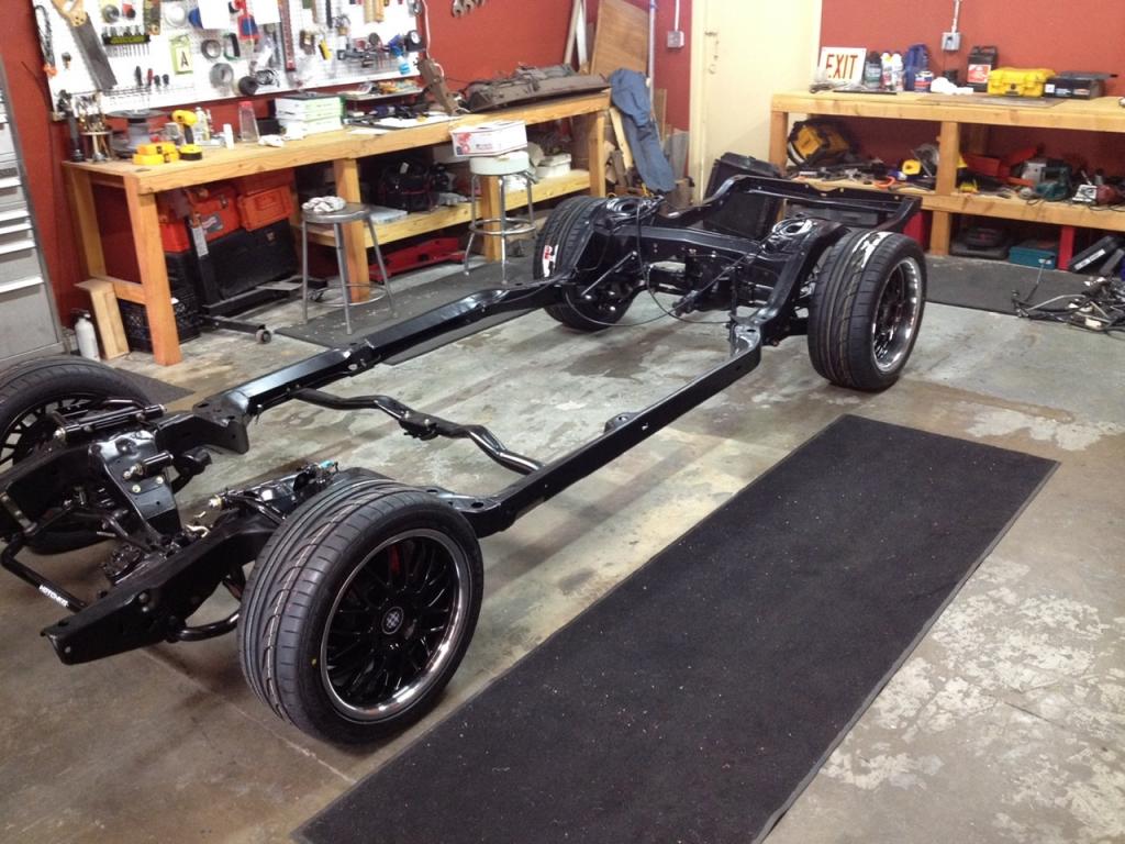

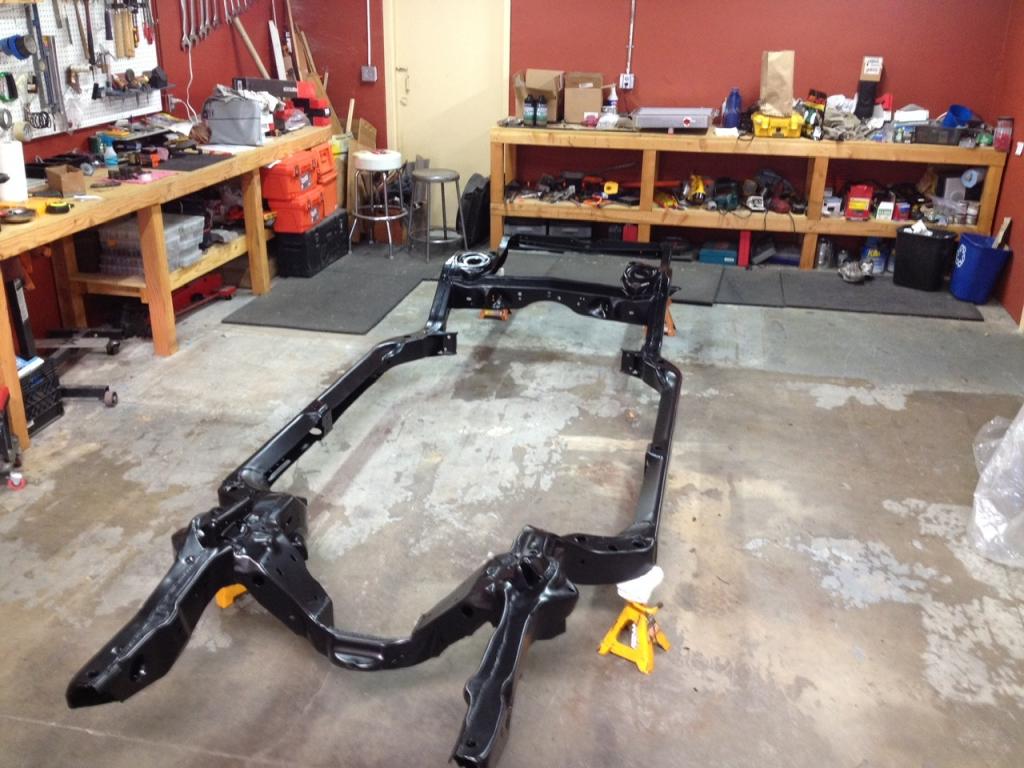

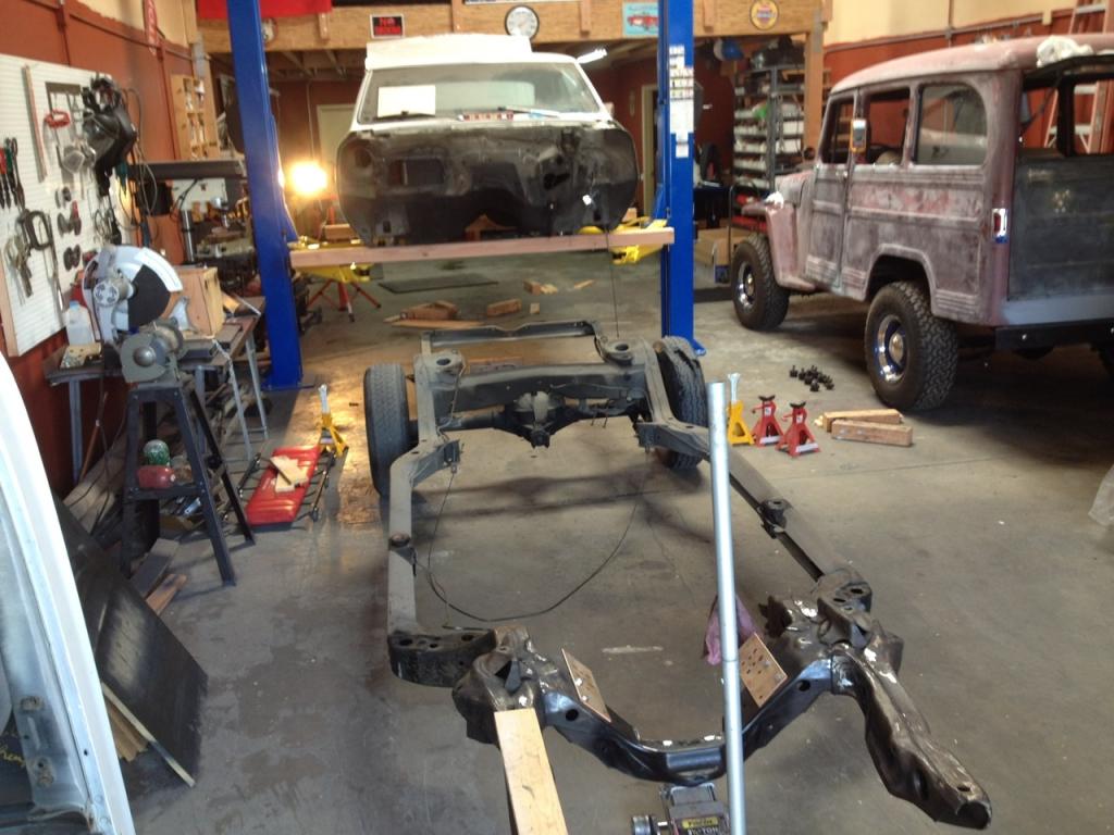

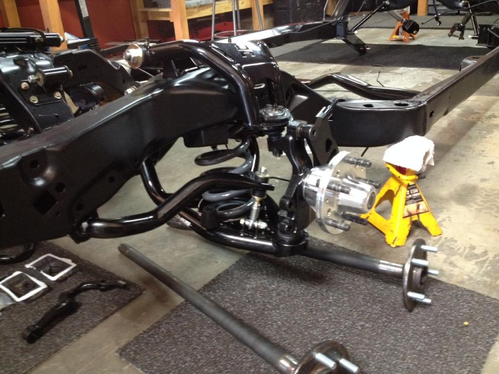

Loading up the frame to take it to be powdercoated.
The frame came back and was ready to assemble.

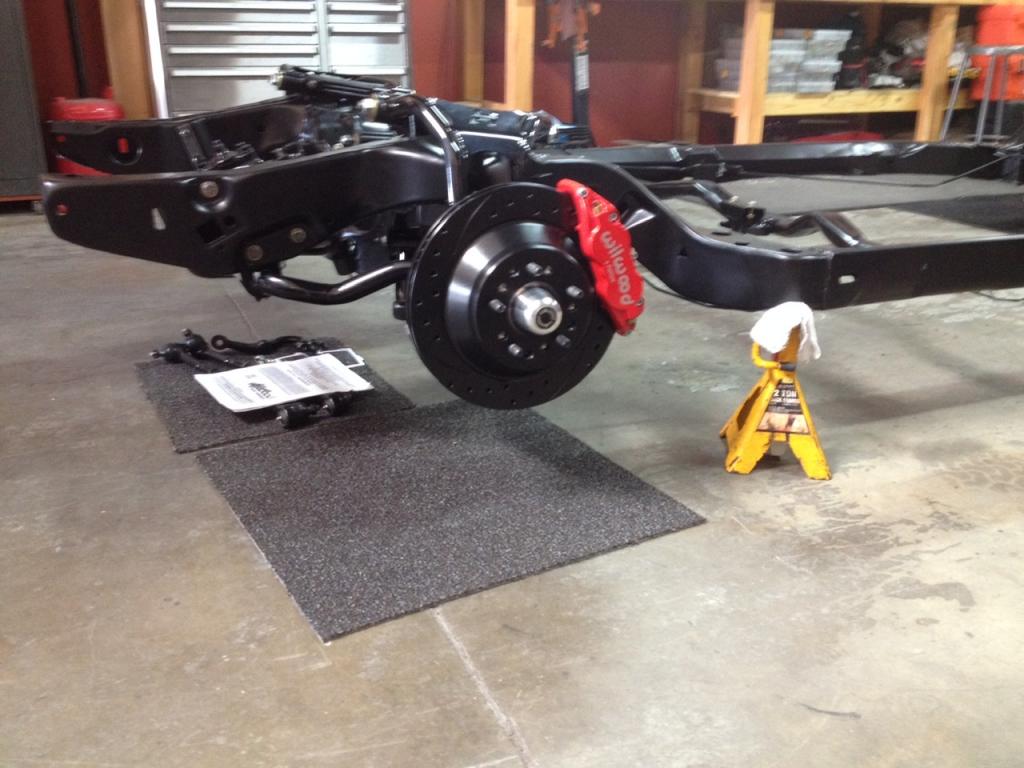

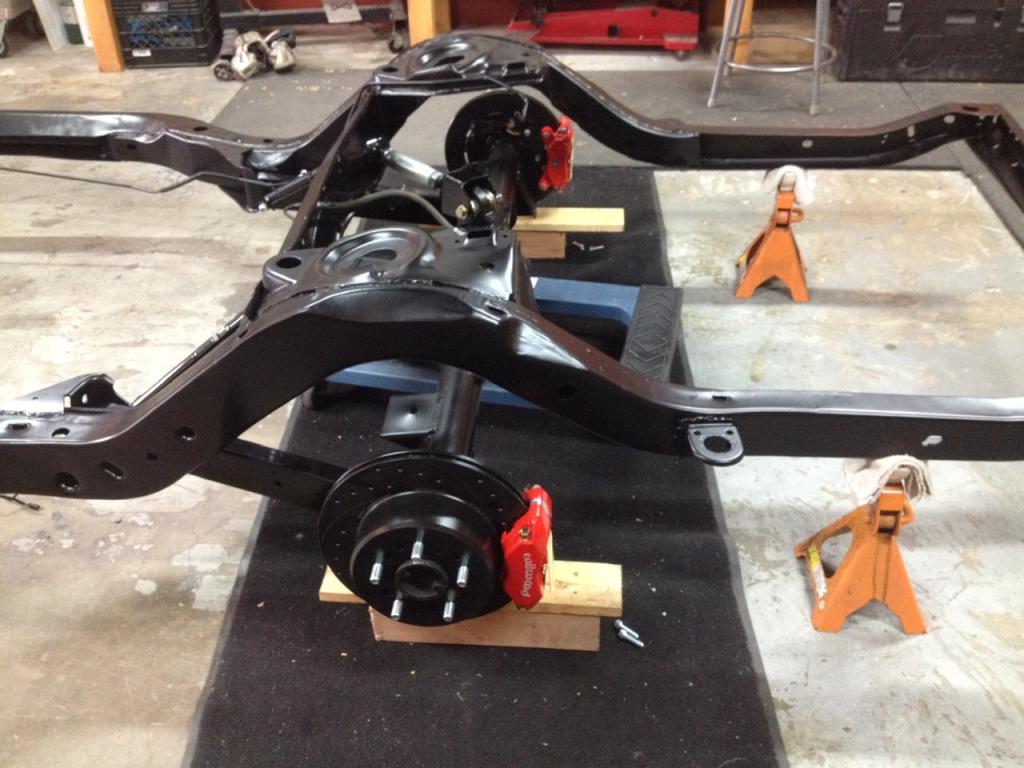

Full stage 4 Hotchkis suspension, front and rear.
Wilwood discs front and rear.

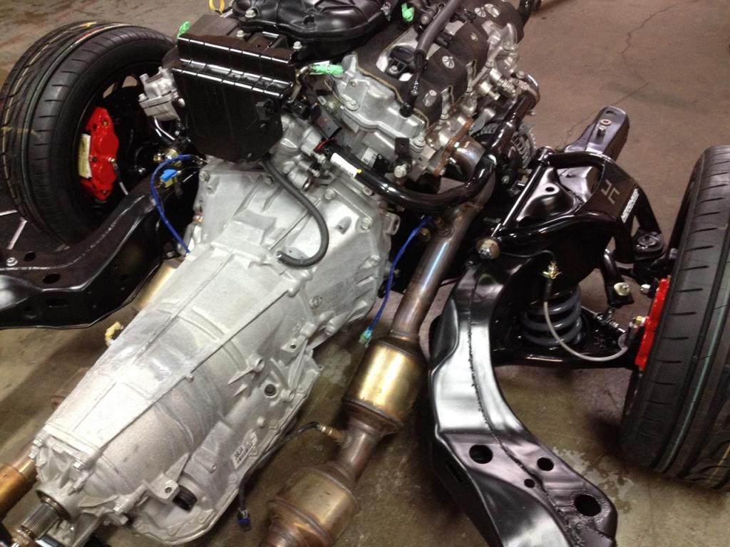

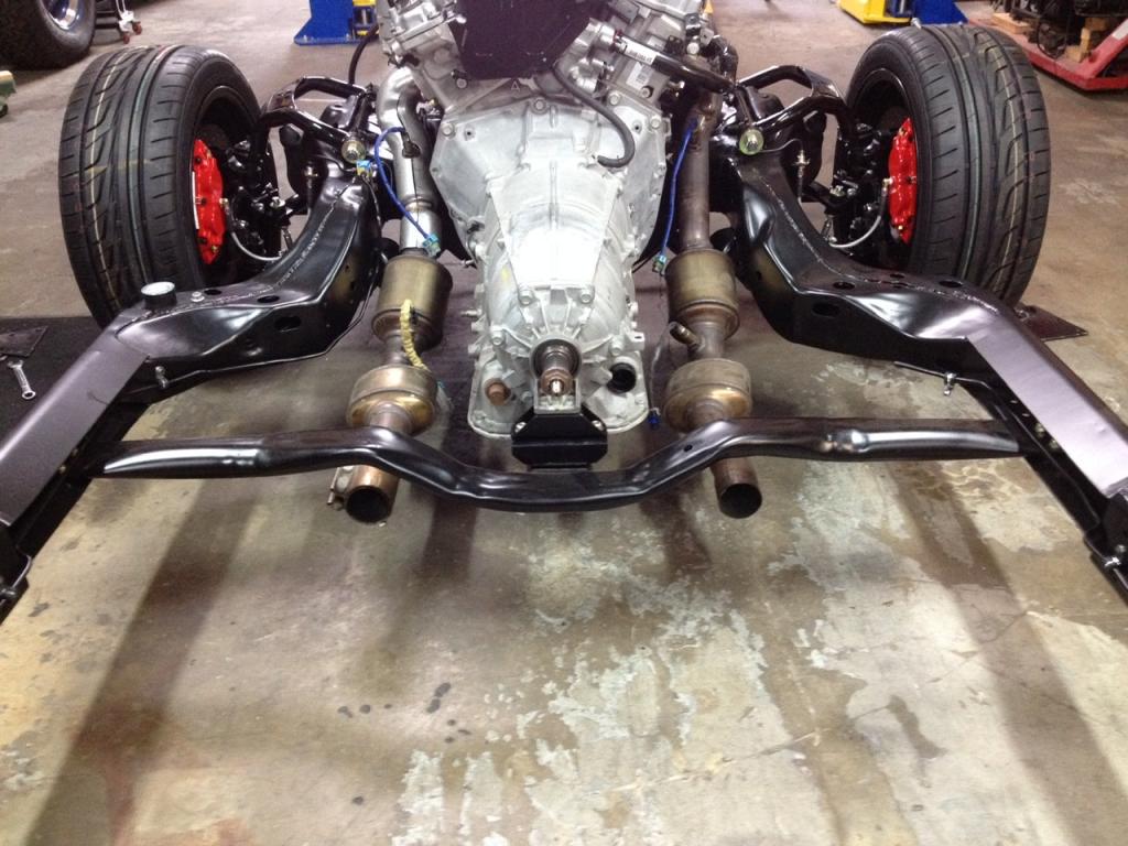

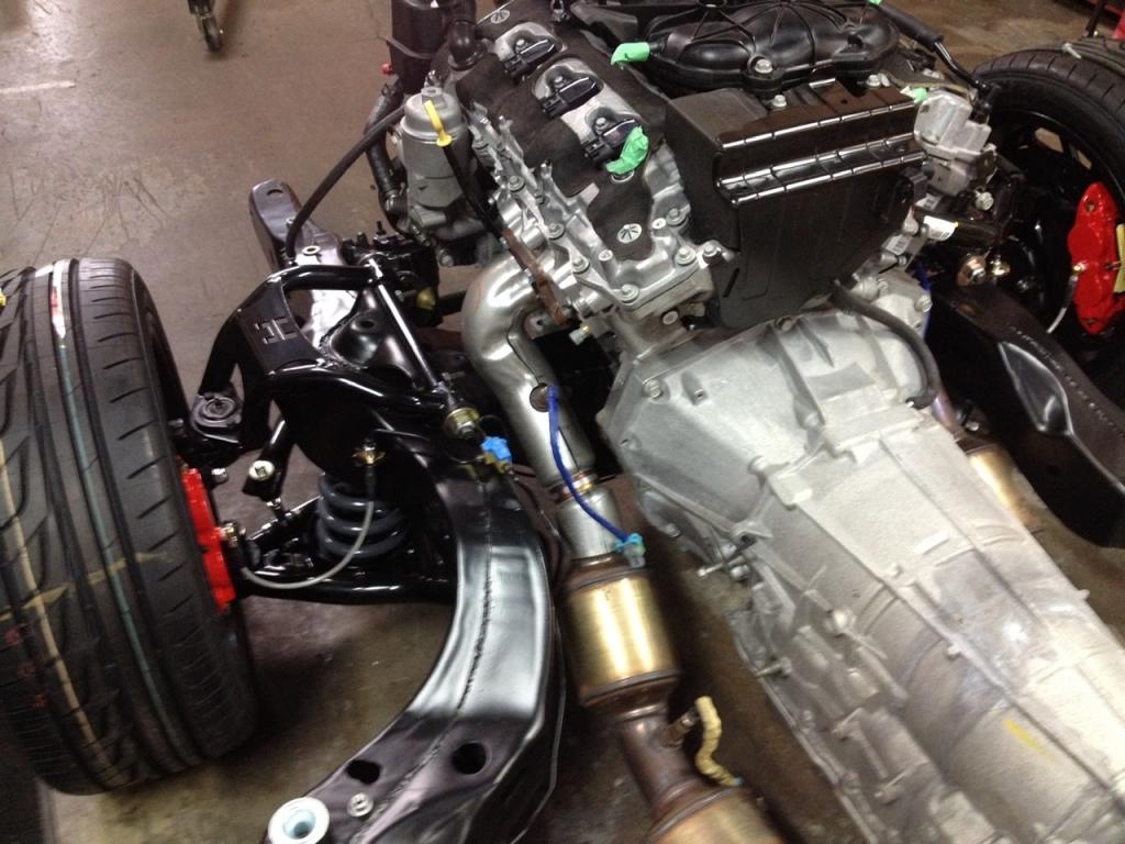

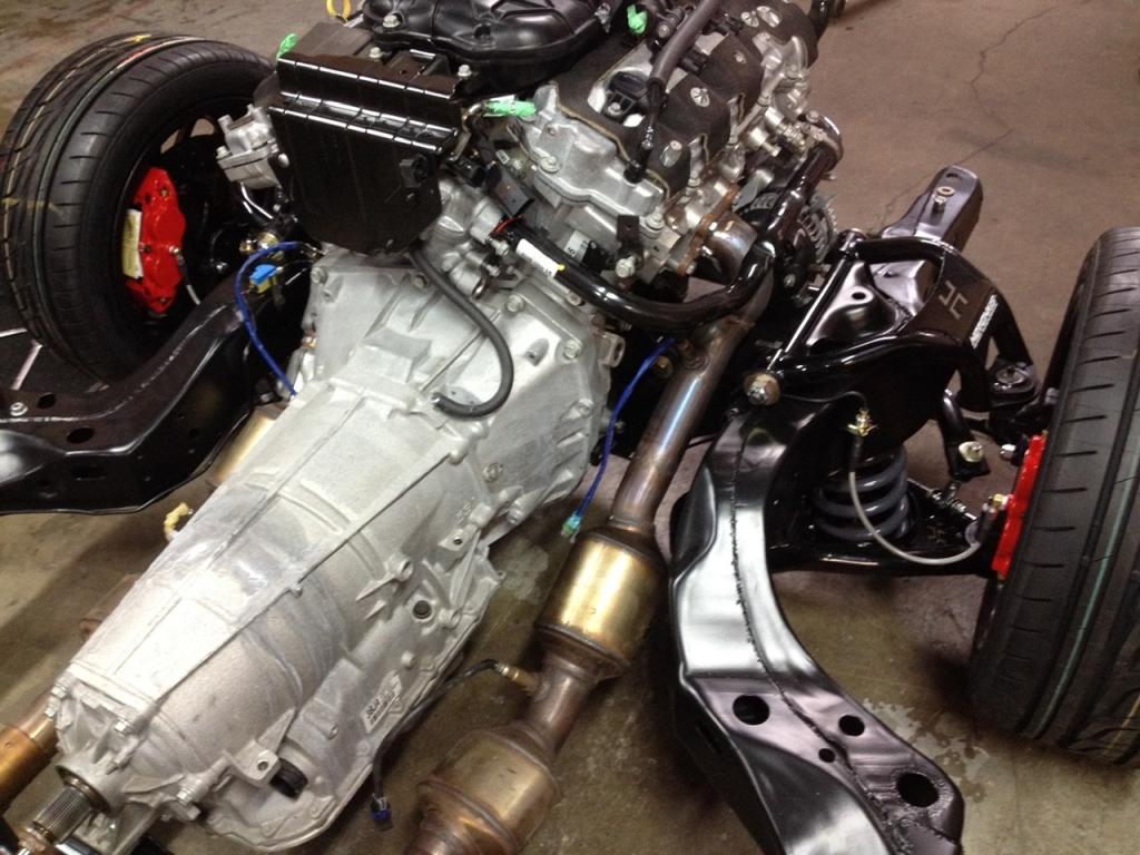

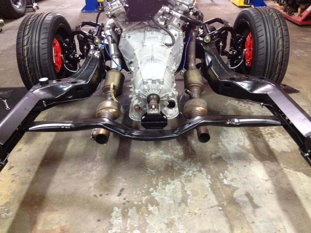

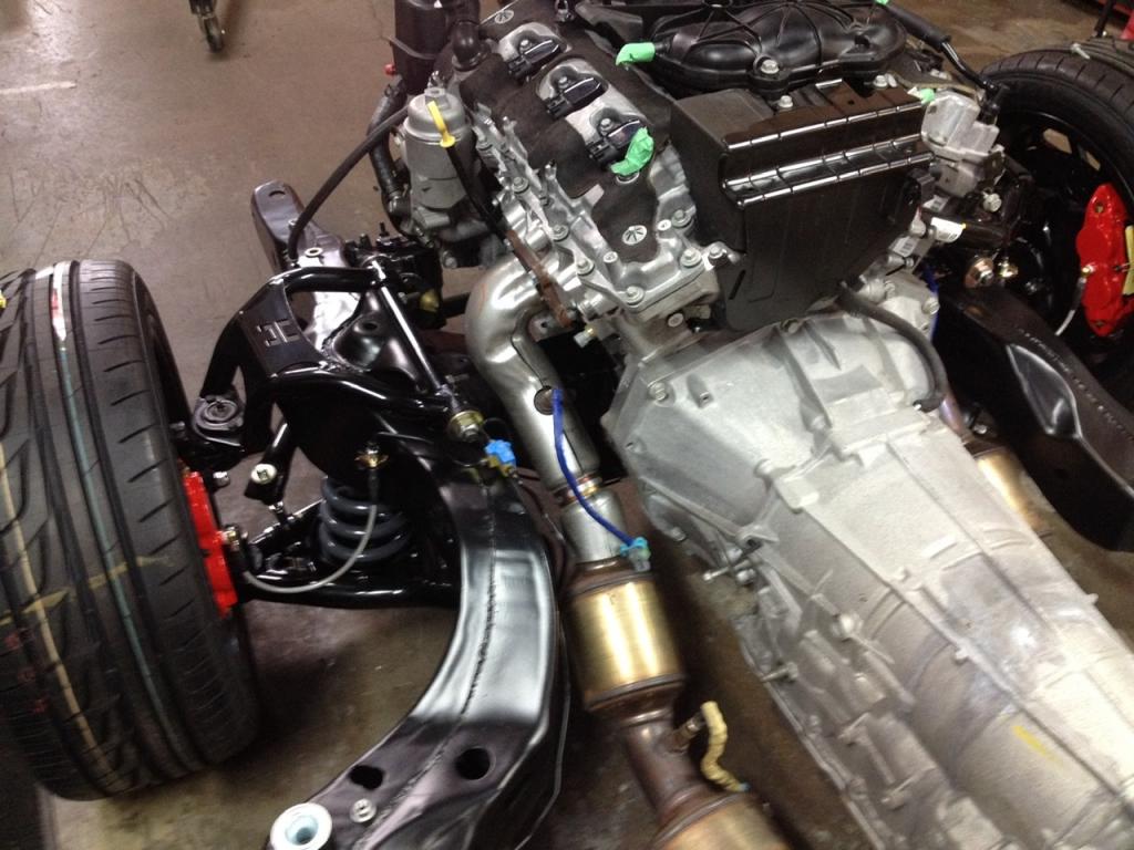

Having the body off made it easy to set the engine/trans. I was also able to run the brake and fuel lines. Also added the 17x8 and 18x9.5 rims and tires.
The exhaust down pipes (Manifolds are built in to the heads) from the Camaro lined up perfect with the humps in the stock Chevelle crossmember. Pure luck.

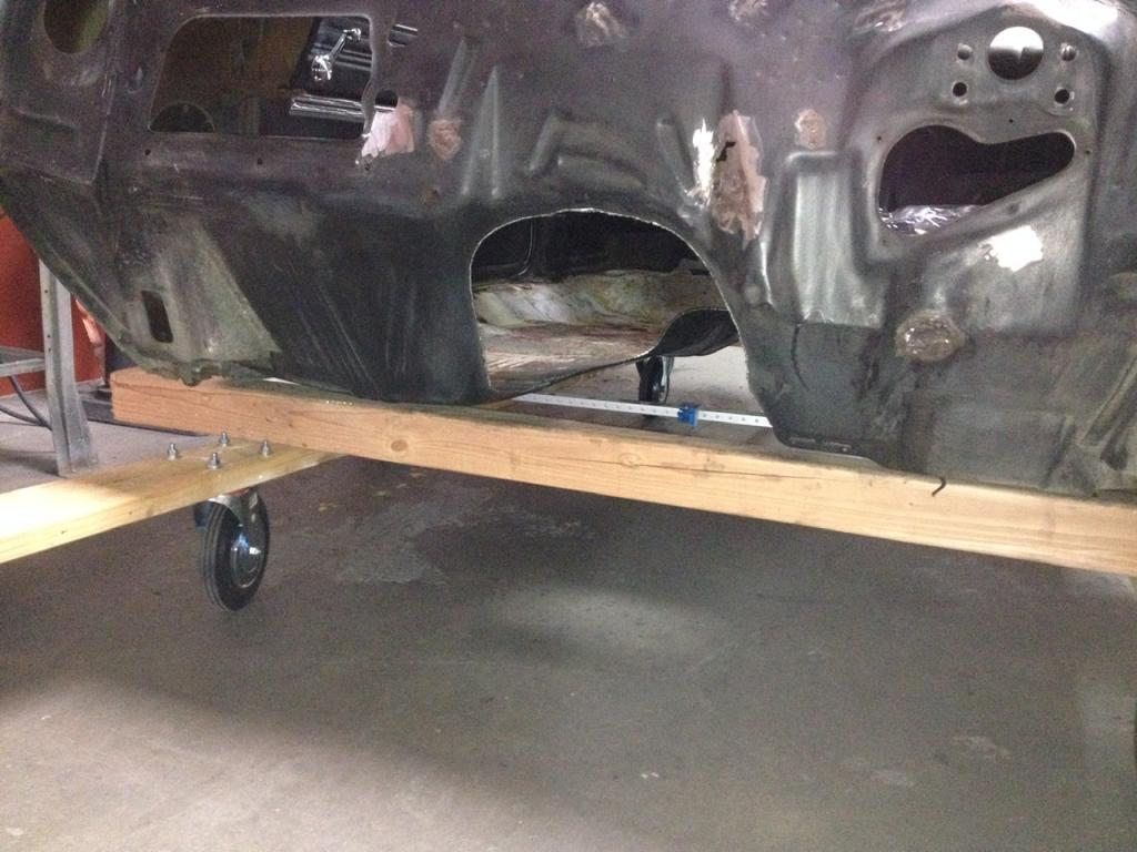

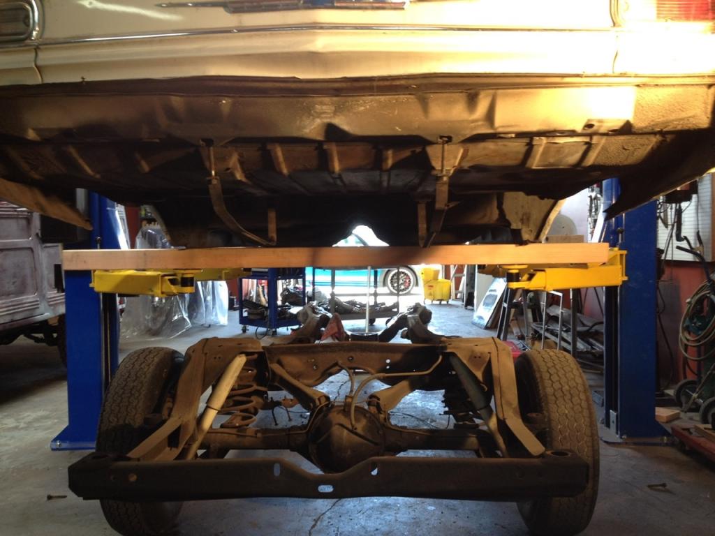

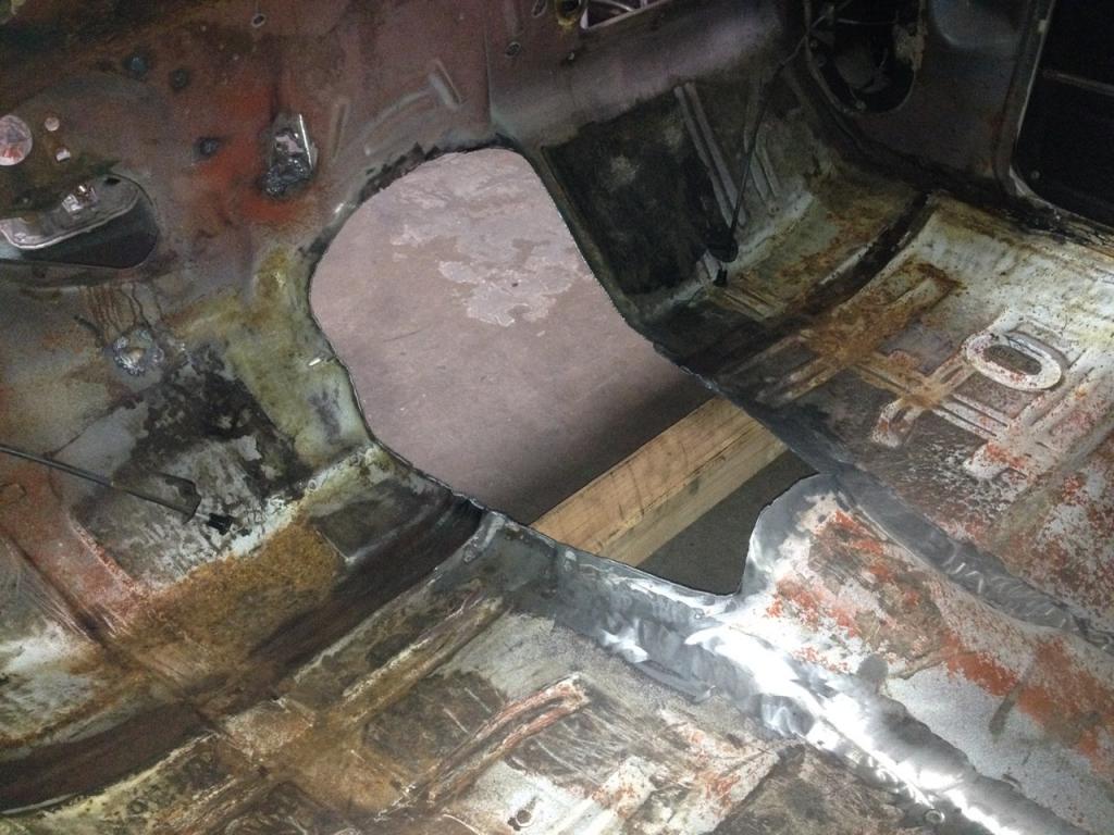

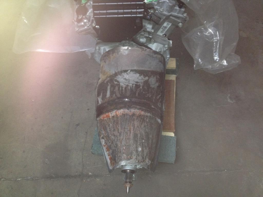

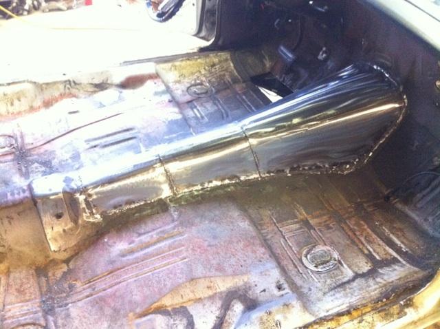

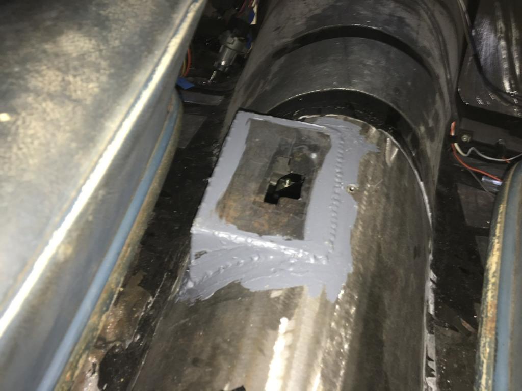

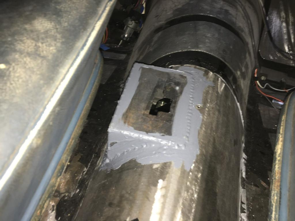

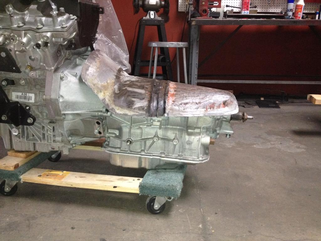

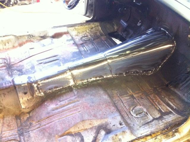

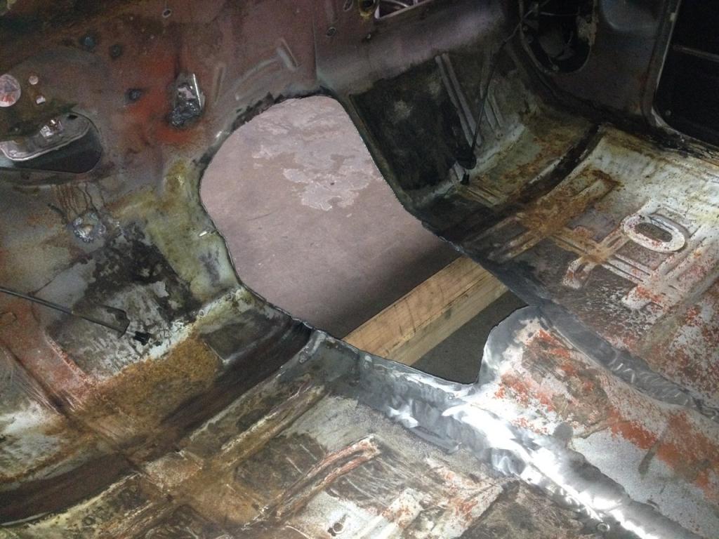

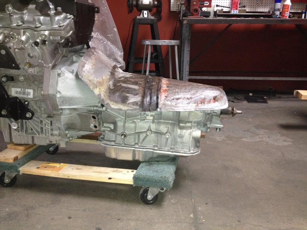

To set the body back down I had to enlarge the transmission tunnel. The new trans is huge and mounted a little higher for ground clearance and the proper driveshaft angle.

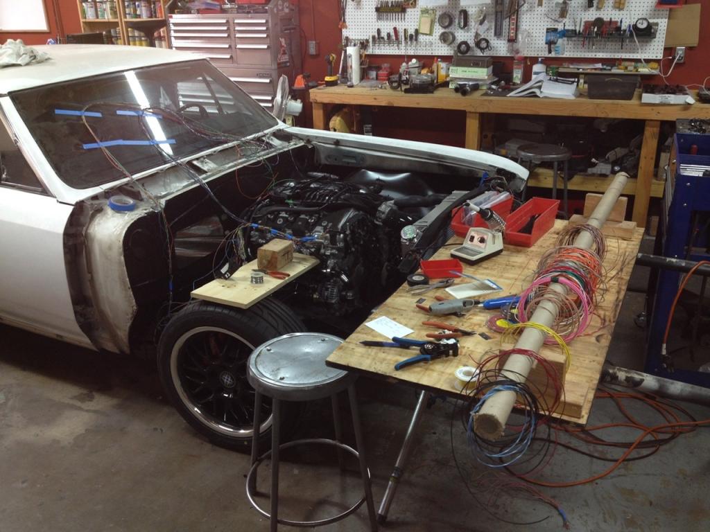

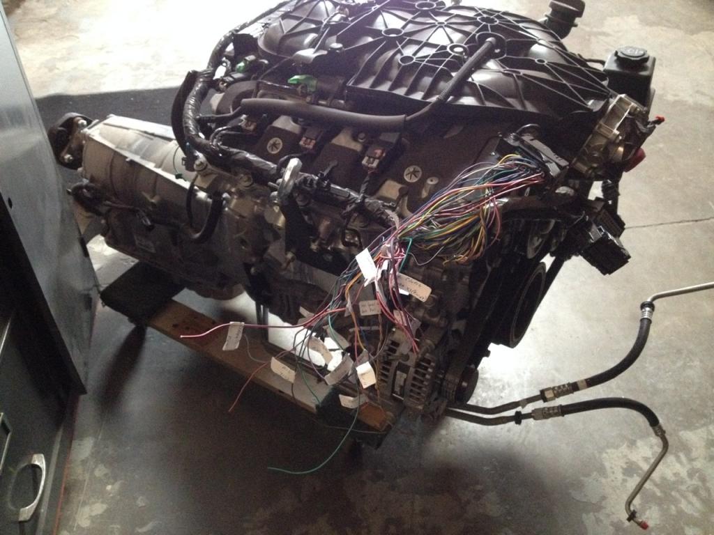

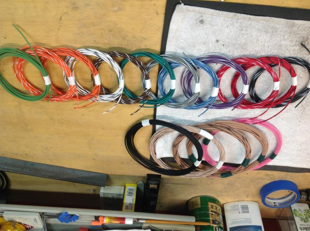

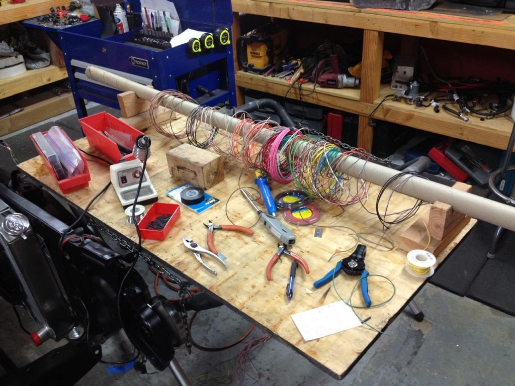

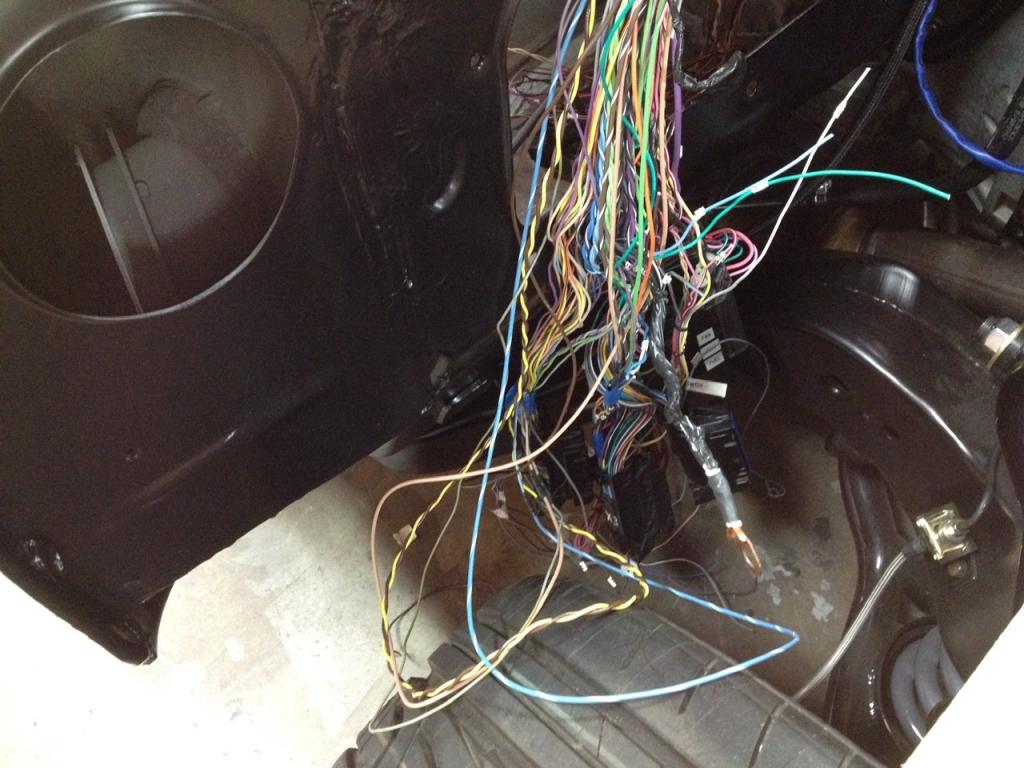

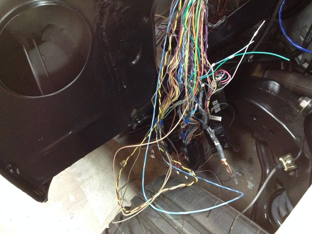

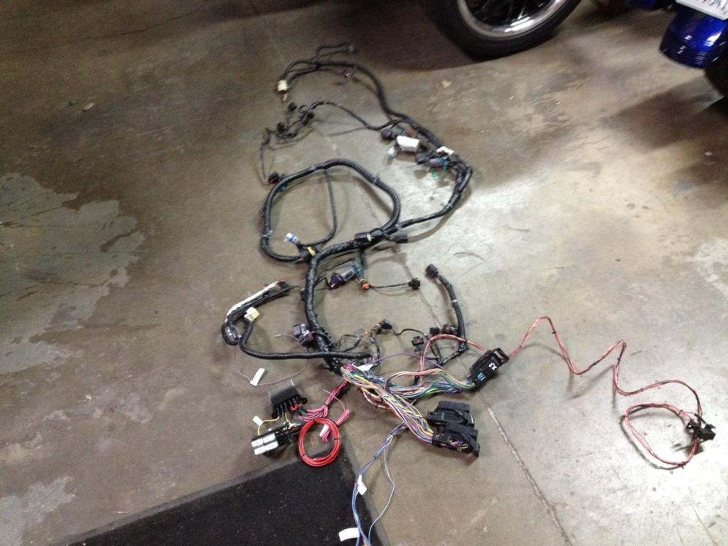

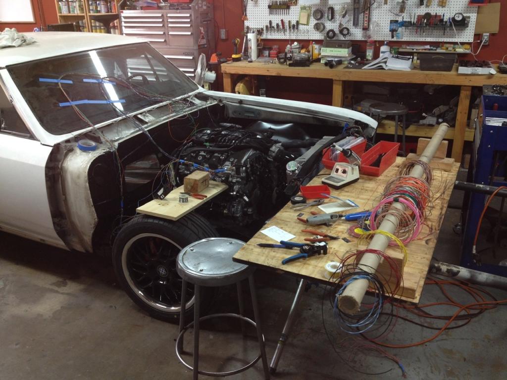

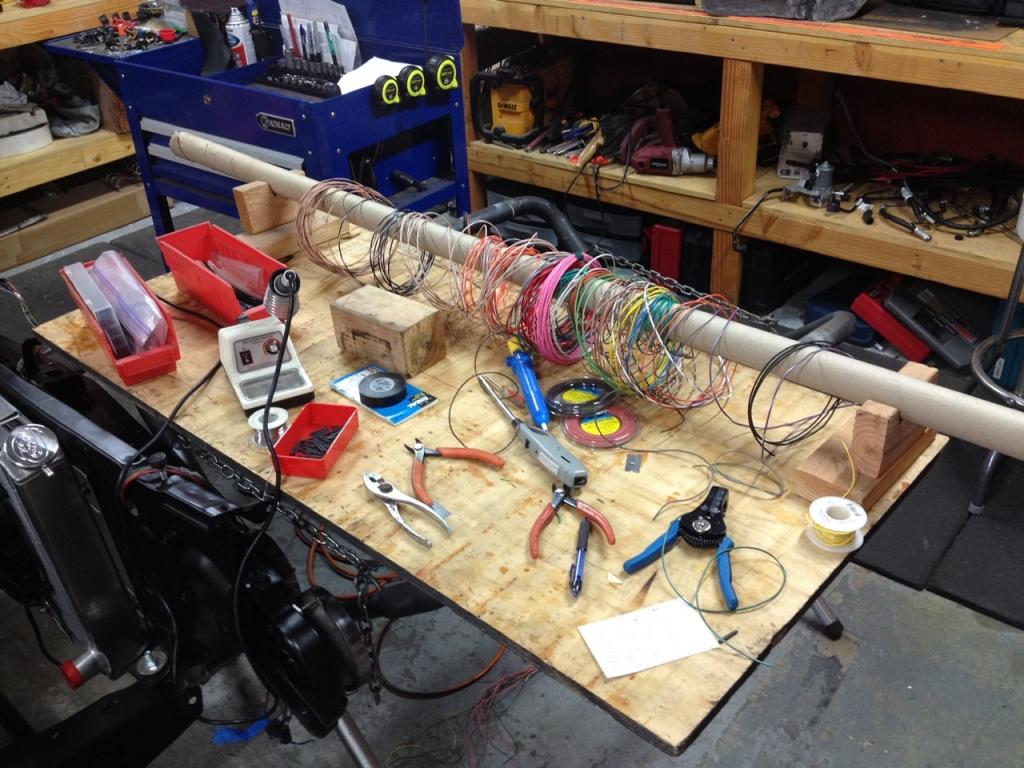

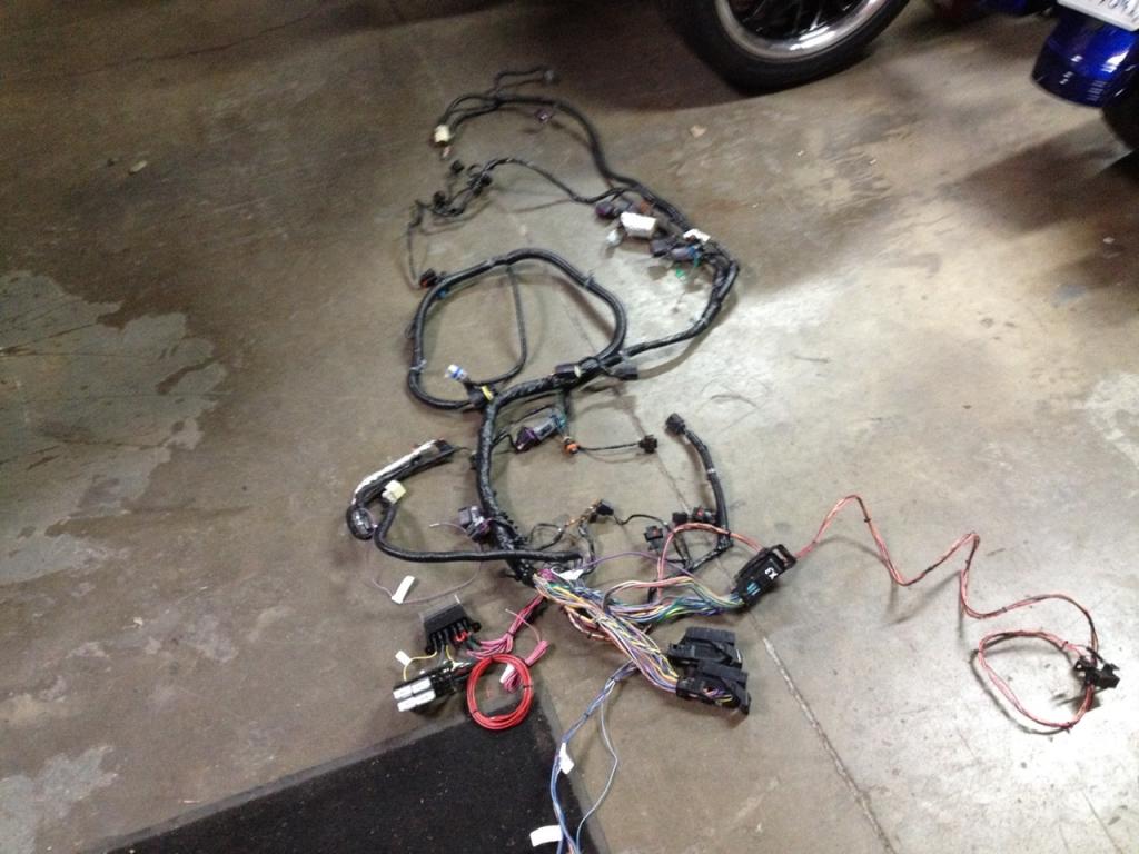

Once the body was back on the frame I could start with the wiring. LOTS of wiring. I bought rolls of wire color and stripe combos to match the factory harness.

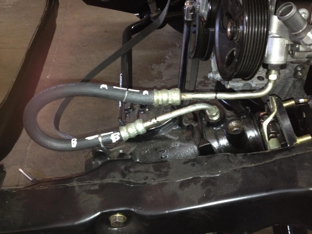

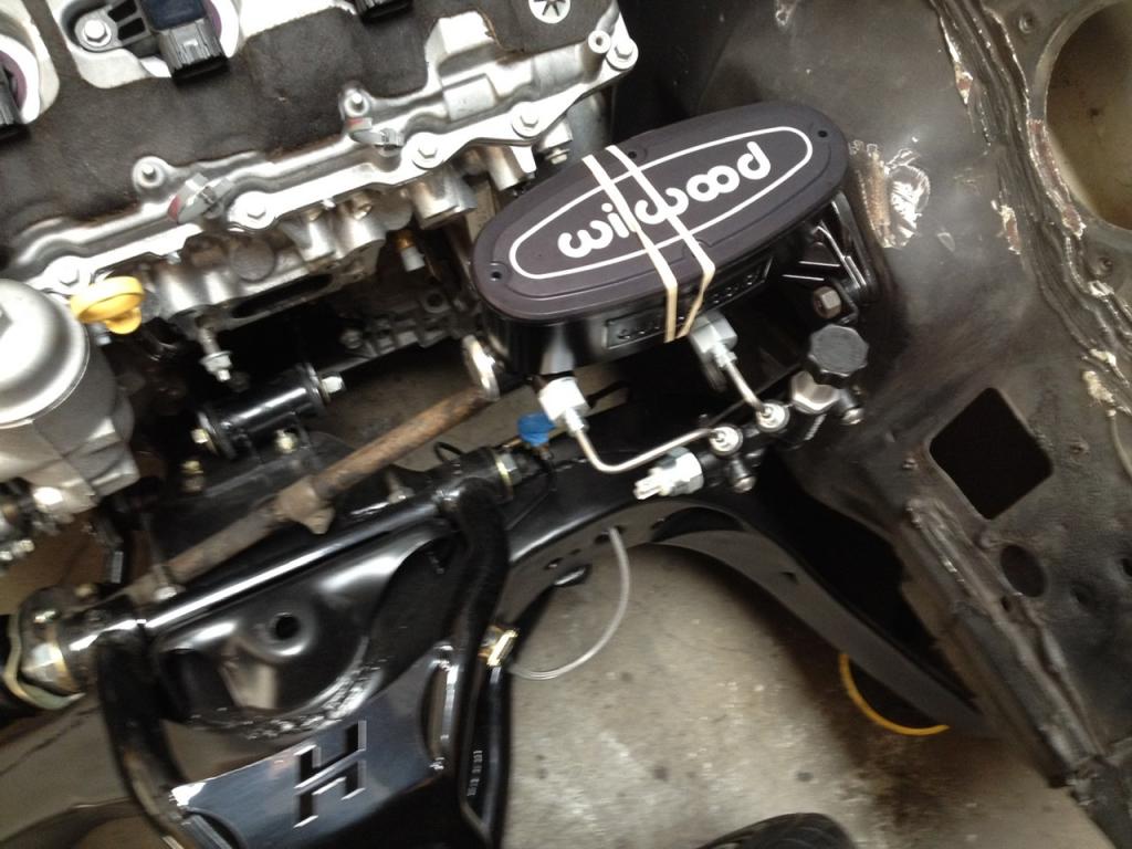

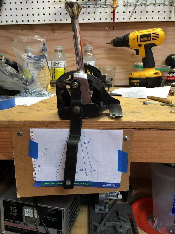

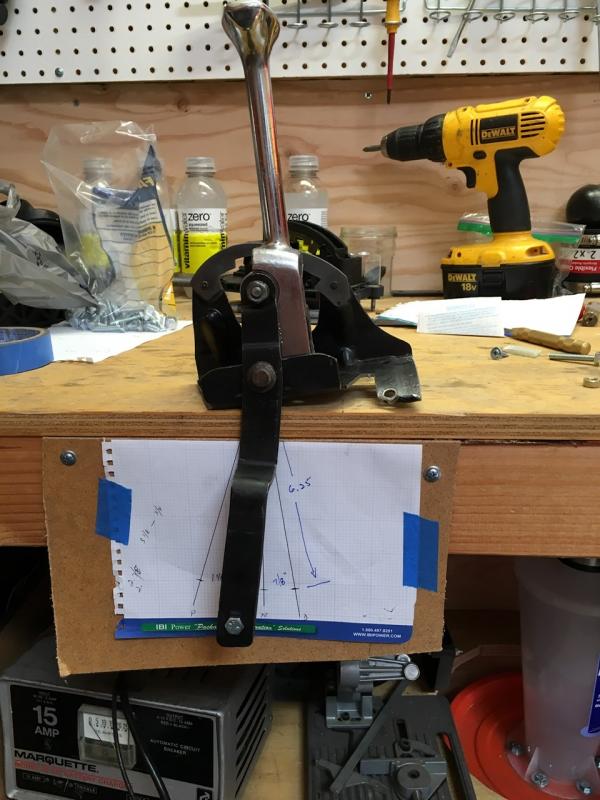

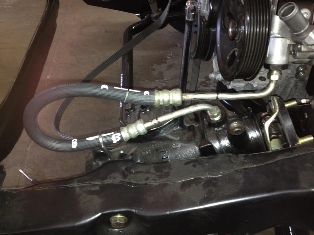

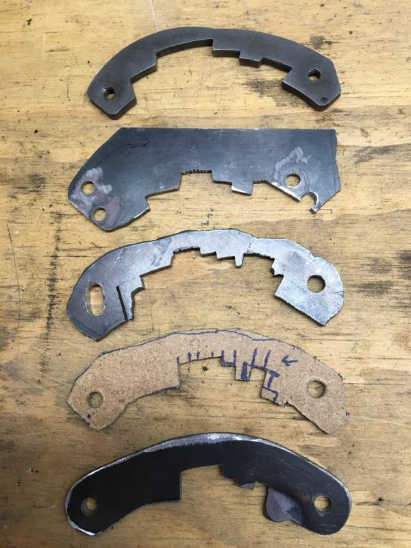

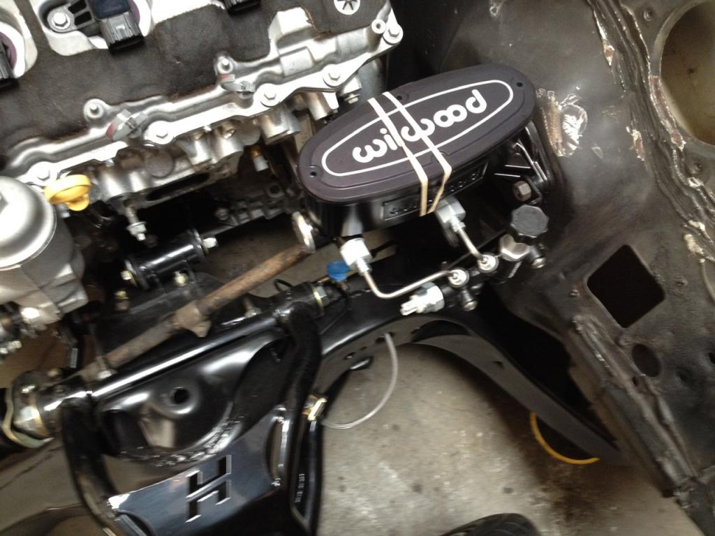

I used a Wilwood master for manual brakes.

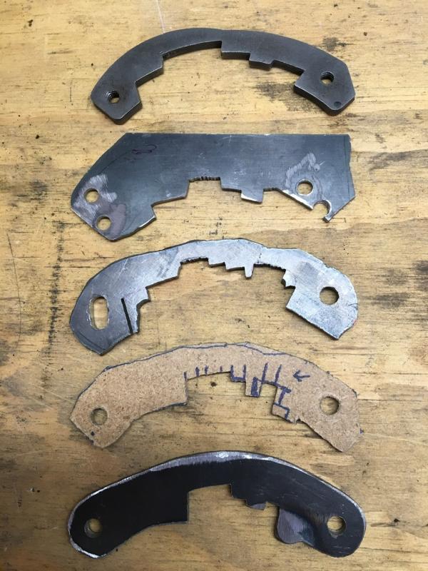

I wanted the stock Powerglide shifter so I had to make a new detent plate that matched the required throw of the 6L50e transmission.
Mock up of a power steering line.

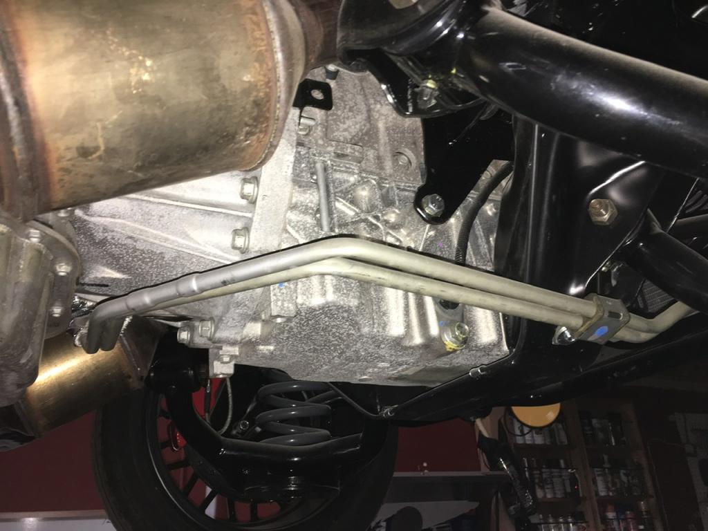

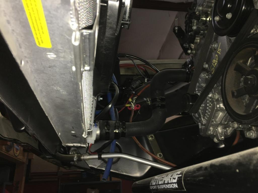

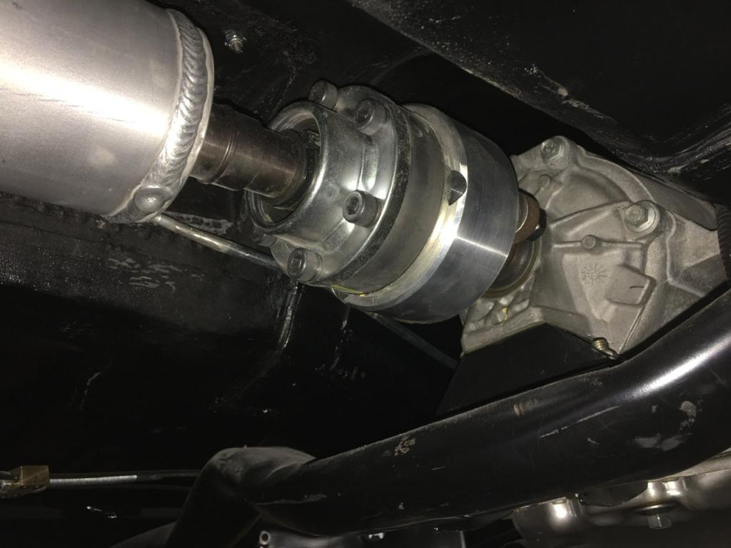

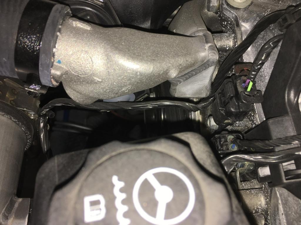

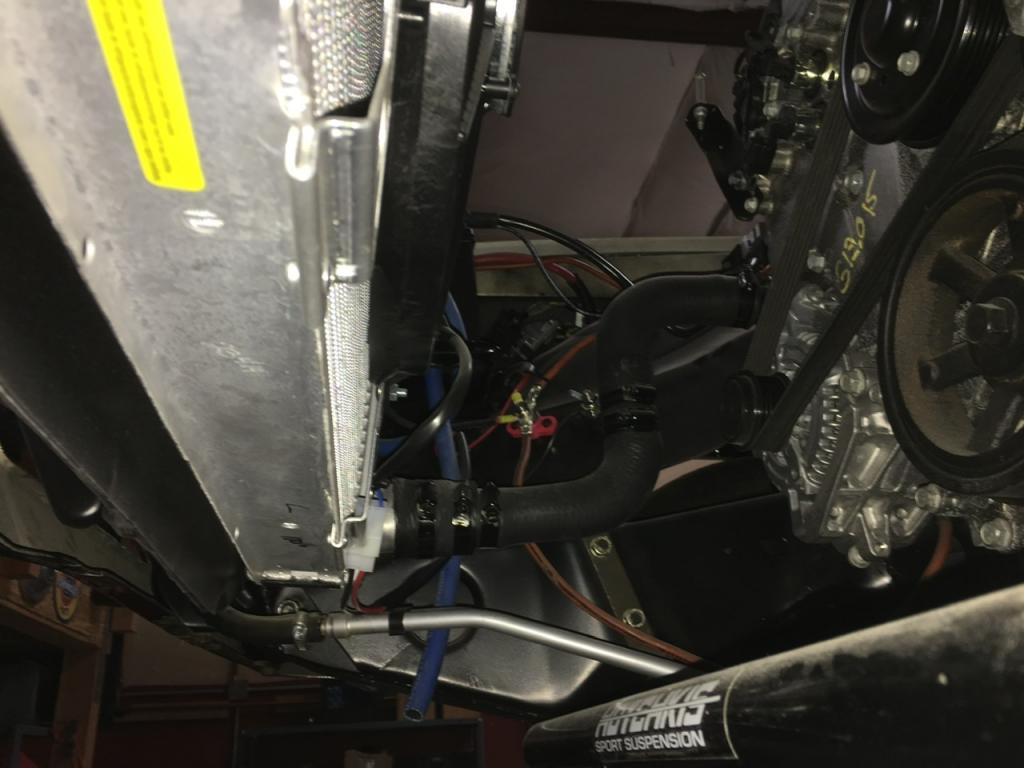

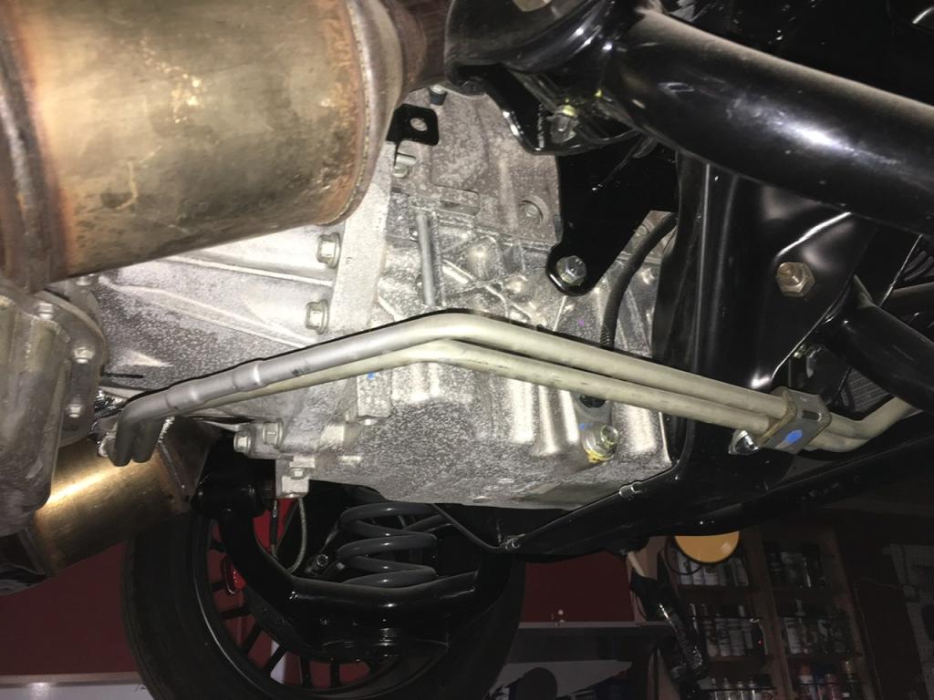

I had to realign the upper water neck. It was aimed down in the Camaro

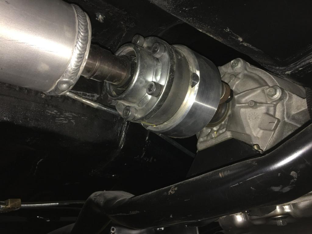

The drive shaft now has a CV joint on the front because the trans has no slip yoke.
The trans cooler lines from the Camaro cleared everything. I just needed to extend them a little to reach the trans cooler in front of the radiator.

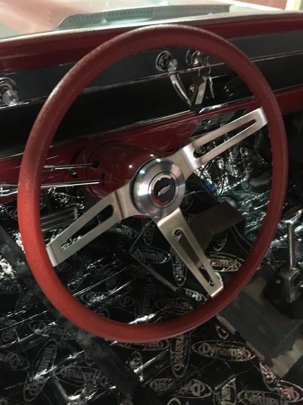

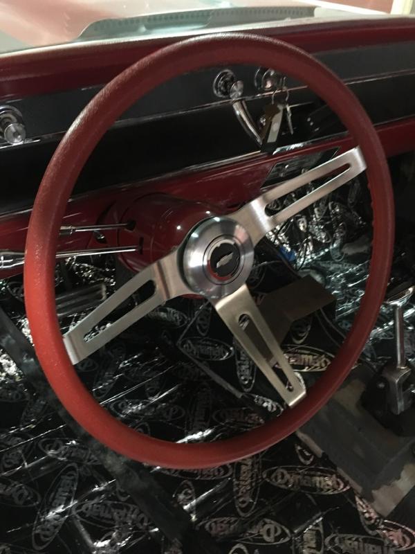

New steering wheel and Dynamat.
Notice, no gauges in the dash...

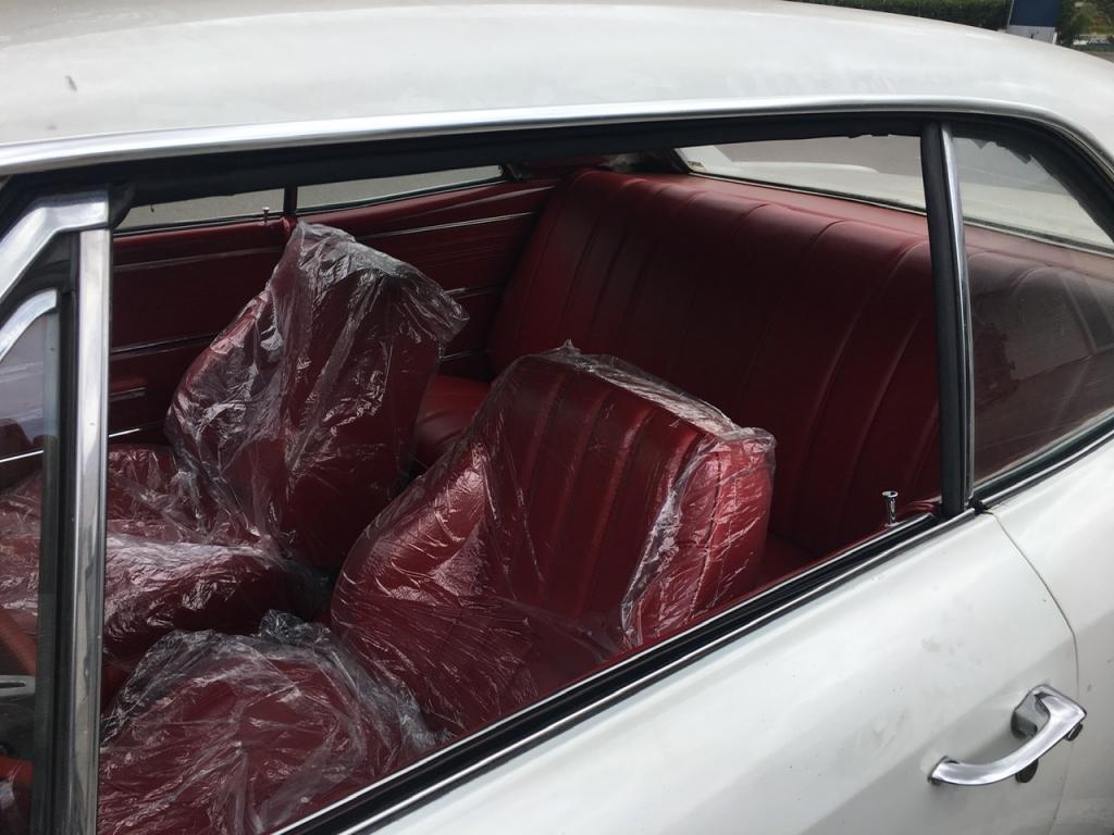

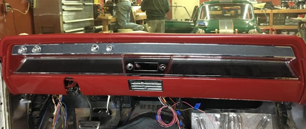

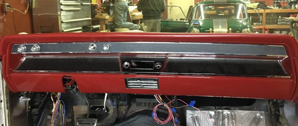

Dash board without any gauges, ash tray or a glove box.
The next owner (grandson) asking “what this is for Papa?”

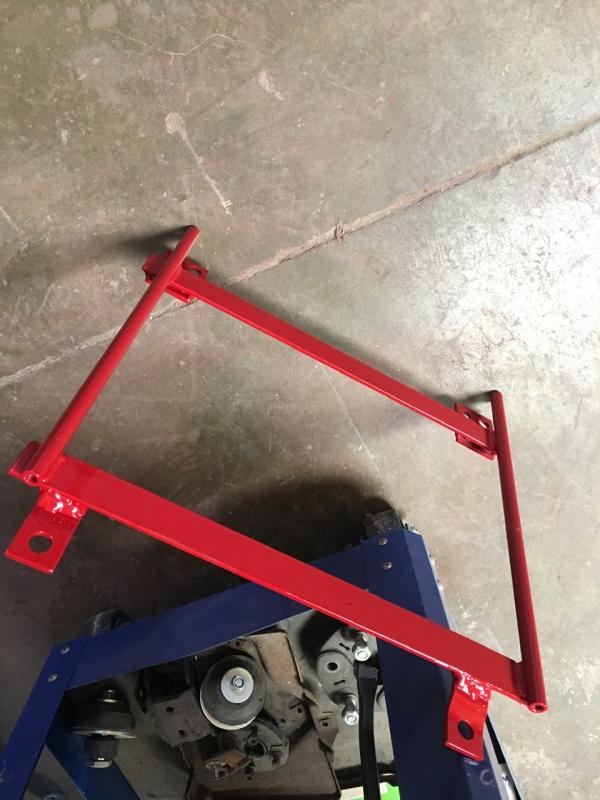

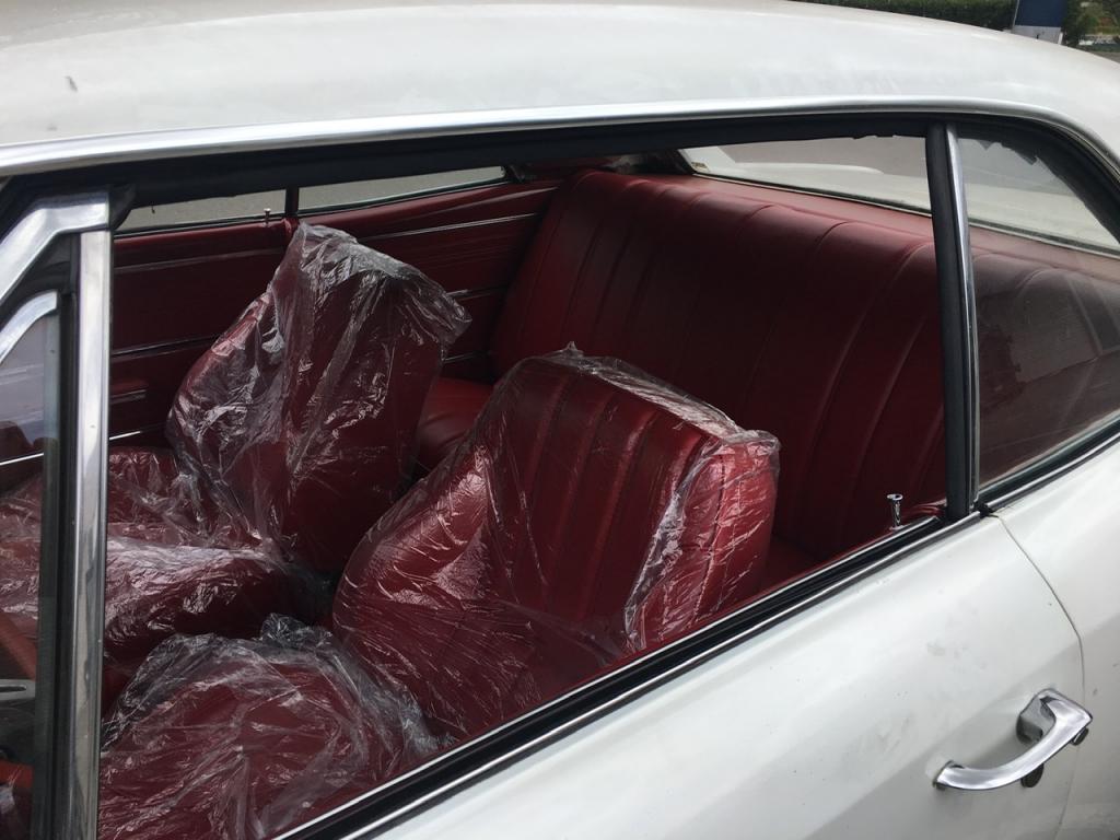

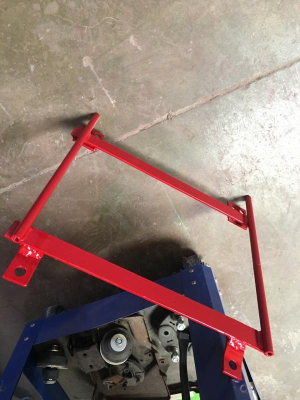

I did a complete color change on the interior from black to red.
New ProCar seats.
Painted seat tracks to blend in more with the carpet.

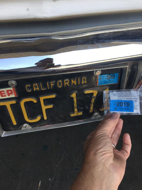

Registration back on after 20 years off the road!!
