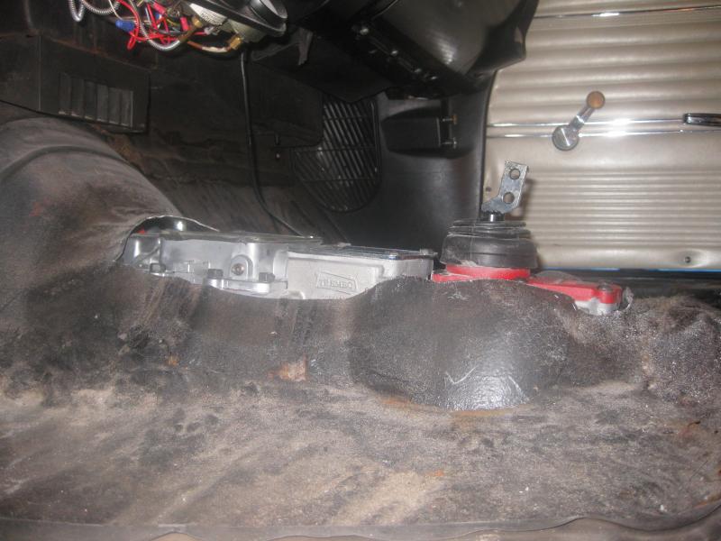

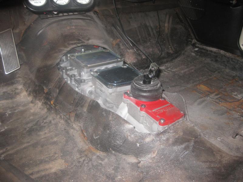

Here is what I have so far, the sawzaw went right through the sheet metal like butter....I'll have to do some massaging to the replacement metal they sent me as it does not cover what I had to cut. As you can see I still have some triming to do.

It's about the same length as the cross member only needs to be moved about 1.5" back. It's the height that is a lot more. I will take some pics when I get home of the new metal they gave me (it's not installed yet) it is actually pretty nice.
